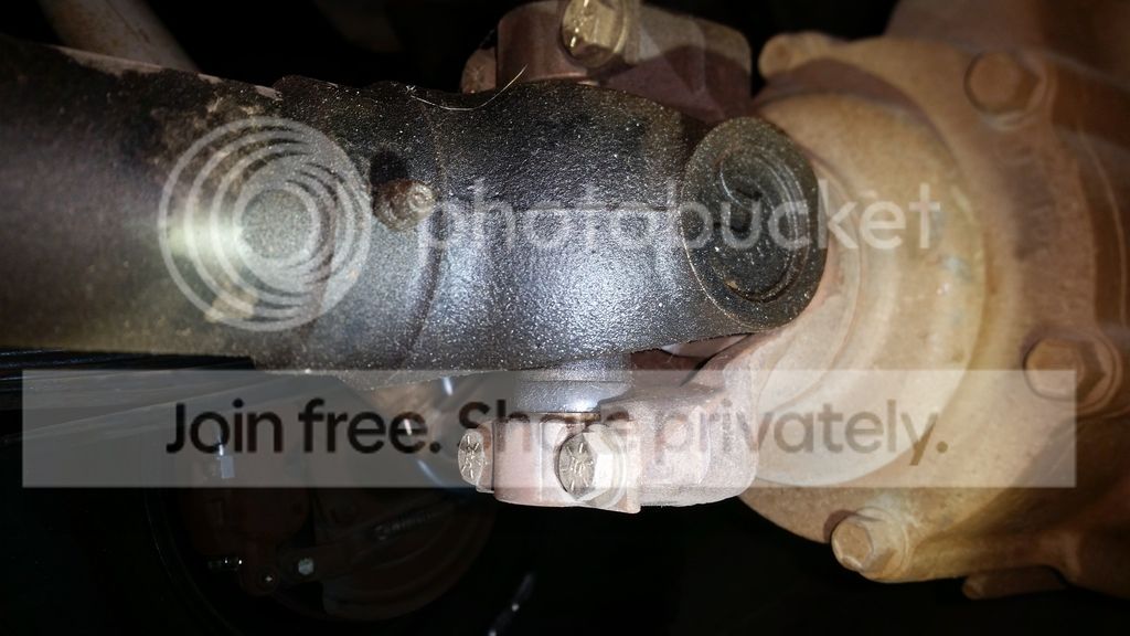

I'm going with this....
Trans and yoke killer.
It happens, for short term you can cut some sheetmetal and jamb in there to take up the slack and make ti ok for now. I once had this happen on my S15 and an old school match book cover was the right thickness, installed ujoint with folded over match book between the tabs and the joint and ran with it for a really long time.
I'm thinking a crush sleeve eliminator and a 1410 u bolt style yoke. I just don't get how this happens. Shouldn't the ears be the same width as the ujoint?
Well cause this yoke is trash you could always pull it and use a press to close it together. It's an insanely small amount. Or weld it in. Did that once really hard to get it centered no nevermind don't do that
I would rather just wait and do it correctly.
Actually, I have a 1410 yoke - ubolt style but not sure if the spline count would be right - was used on 205 output when I was looking for my vibration problem.
Just remembered I have a new set of gears sitting around and it's not the same spline setup.
It's a brand new u joint with maybe 4 miles on it. I took 3 different 1410 u joints and had the same issue.
Dude, does your ujoints not have seals?
Looks like you can see seals in there, just dark. But your measurement is only .027" different from spec - and it looks like you've got more than that in play...
I had to replace the yoke on both of my front and rear axles because of ujoint play in them. Took me a while to track down too as it's not something you look at a lot.
