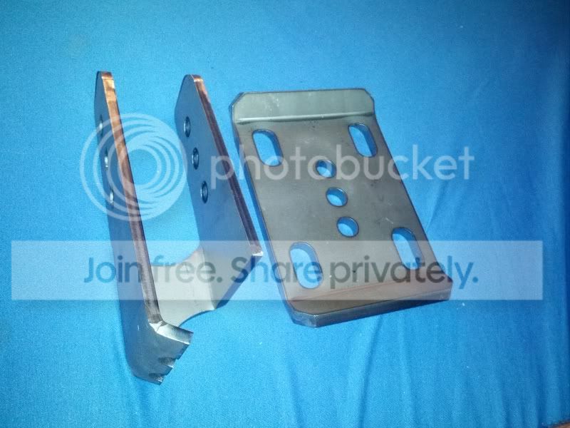

Here is the new parts.
The bolt for the shocks is a tiny bit to small in the bracket... Would that be ok being the misalignment spacers for the uni ball in the shock will make up for the difference and create a tight fit?
If this doesn't make sure I'll take a picture of what I'm talking about.
What size bolt is it supposed to take? Same as the spacers I assume. No matter how tight you make them, if there is slop, it will move. How much bigger is the hole?
The spacers should have a shoulder that goes into the shock hiem. If you welded them to the bracket, you could not get the shock on. Take a picture of the shock end and the spacers so I can see what you have to work with.
