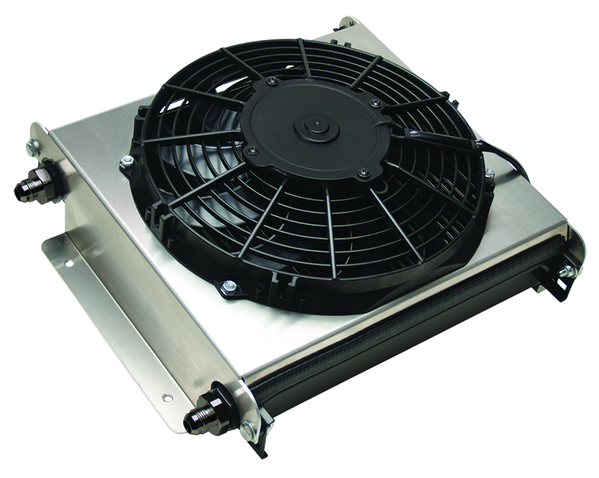

So while we are on the topic of trannys I need to cool this thing better, either thinking of buying the correct fan for the cooler or just swapping and even bigger one in.
I'll have to dig up and find what cooler I have, I forget.
Derale sells a complete system with that cooler, I can ask if they sell the shroud seperately.
I can also look at comparable SPAL fans and see if they flow more air.
That is a much better design of a shroud then what I have on it now, if you could look into both I would appreciate that. Do you know what part number I got for the trans cooler?
