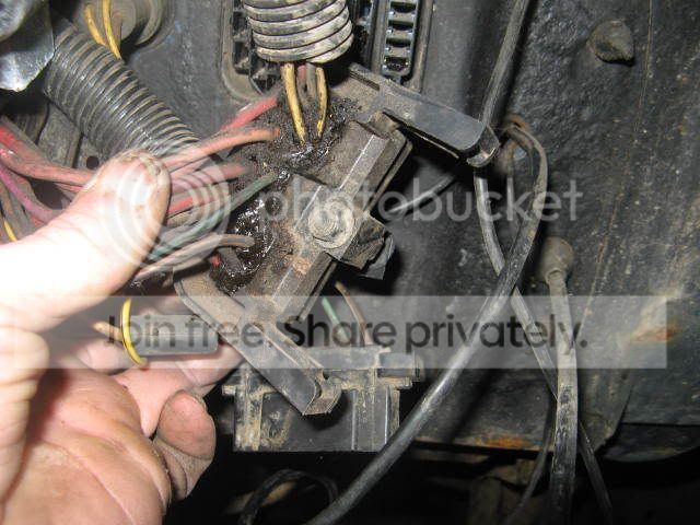

Thats exactly what I was going to do when I do the dual swap. I was moving some wires around today and one sparked off. Instead of fixing the one I have, I want to replace it with one thats not all hacked up to crap.

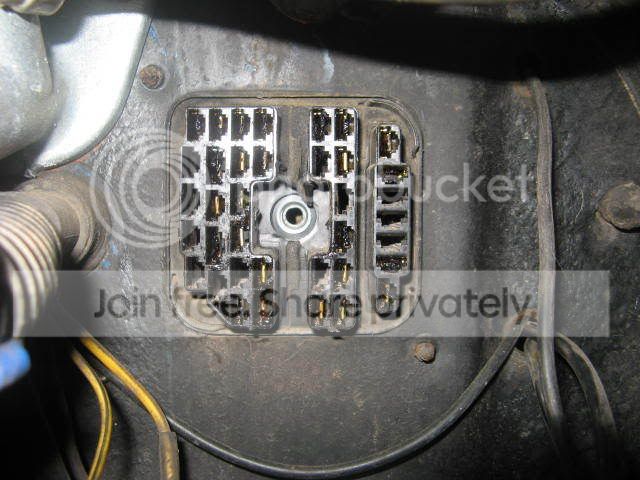

Here is the junction block with the wiring removed. You can see how it is broken into three sections with a bolt hole in the middle of it. The lighting harness is actually the middle one just to the right side of the bolt hole (my mistake)

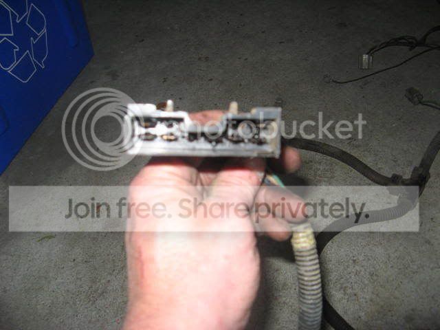

Here is part of the stuff that plugs into it. What I'm holding is the main engine harness, has ignition, alt, starter and all that stuff. You can see the captured bolt...

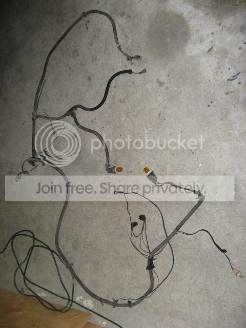

This is the harness I have. Again I made an error. I swapped this harness in from a donor about 5 years ago. The donor was an '83. The only difference for you is the turn signal location. This harness works for turn signals in the grille...you'd have to extend the wires for that part to get the bulb holders and wiring down to the bumper on your '82.
