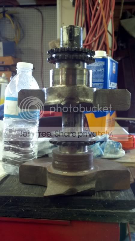

I was running a Eagle crank, and the snout snapped off nothing fancy story wise, just went to downshift and it let go... this was the second crank that I've had do this with less than 2K on either engine. I decided to leave gen 1's in favor of a gen 3.

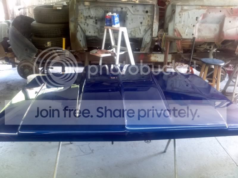

Body work/paint pix, I've got a ****load, but Ill only share a few... They get repetitive.

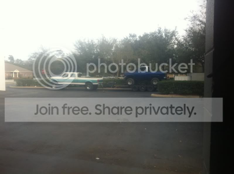

All loaded up to get it tuned, this was thursday morning, truck pulls were friday night. I put 75 miles on her friday before putting back on the trailer and rolling out...

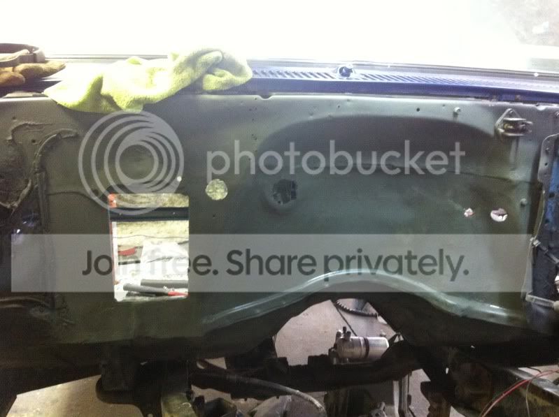

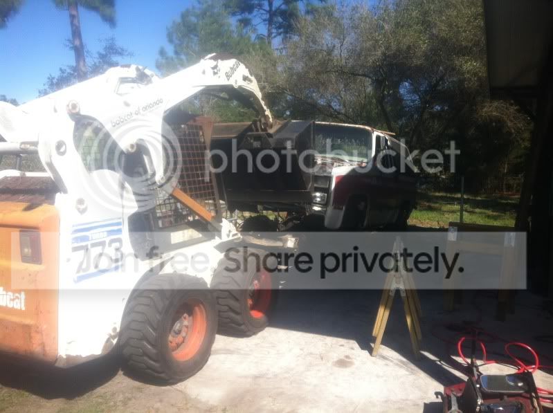

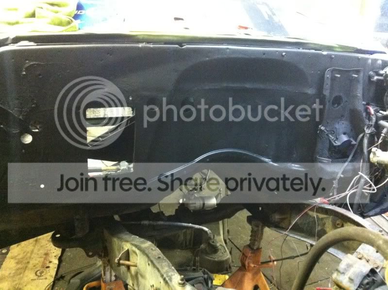

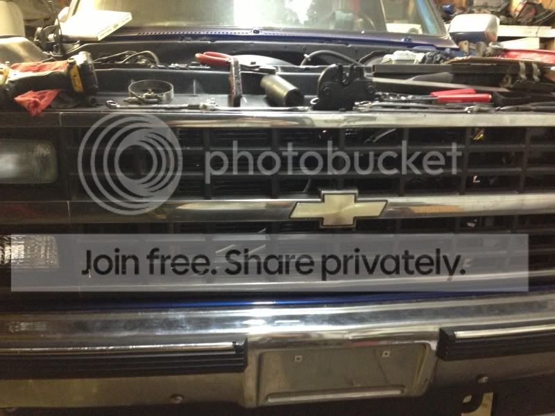

This is prior to ANY cuts... simply removing what was left of the airbox and dash..
Donor POS.. quite literally...
oh yeah.. plastic drums.. Redneck shiz :D

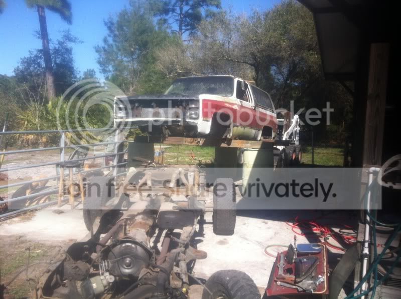

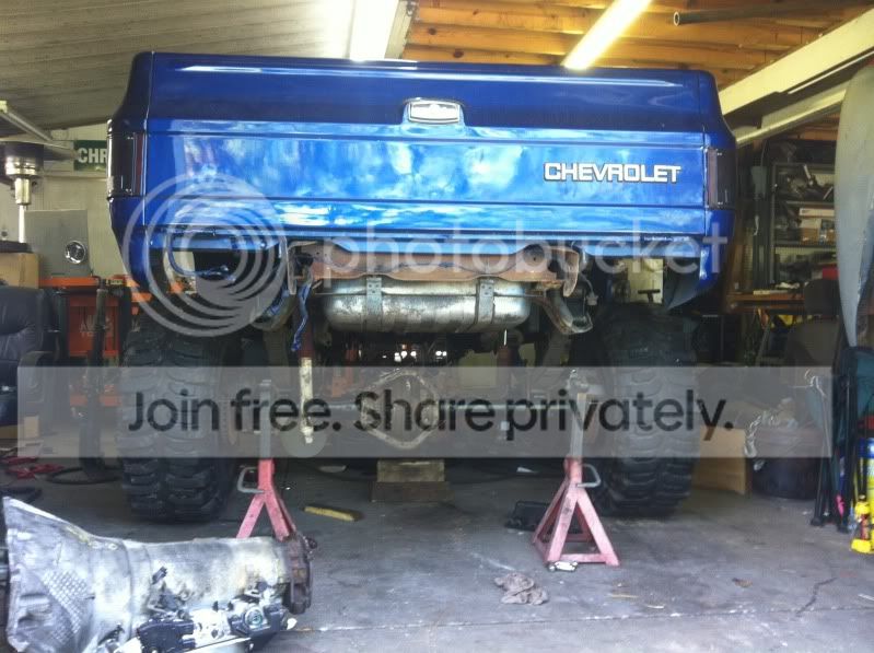

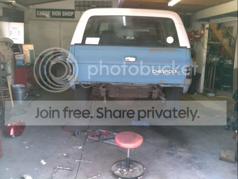

Body off, waiting for "new" frame.

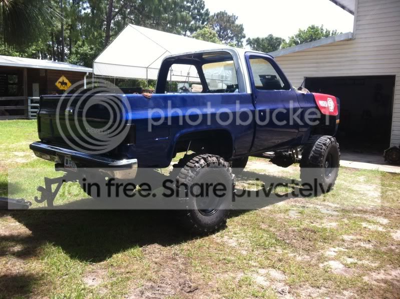

Upon the rebuild I went with a completely forged bottom end, LS2/LQ9 pistons for a tad higher C.R., 4L80E, NP241, and 4.56 one tons.

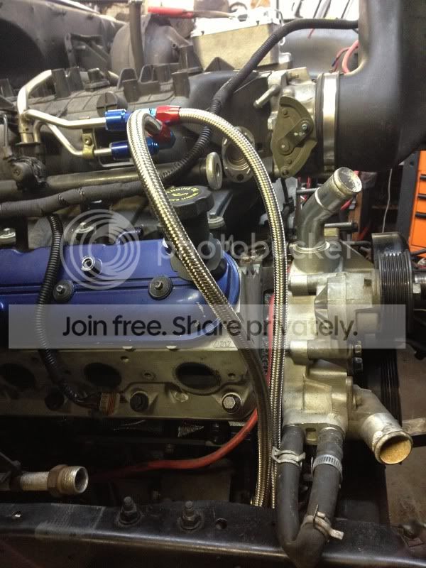

Here's where she's at today, I almost had her fired up today, but as fate would have it I grabbed the wrong oil filter, and ordered the wrong poly mount inserts.

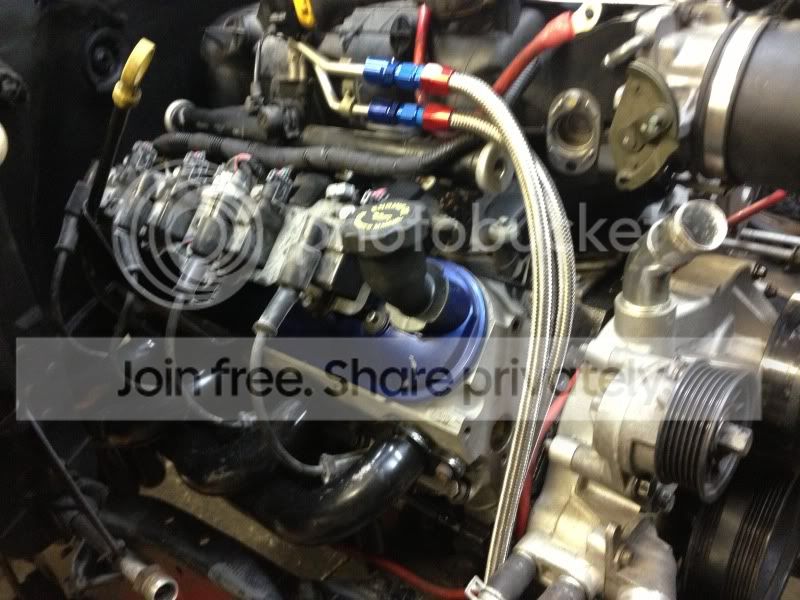

Need to order another straight -6 An fitting, clean up the routing. Couldn't run the lines as I had originally anticipated and ordered for.

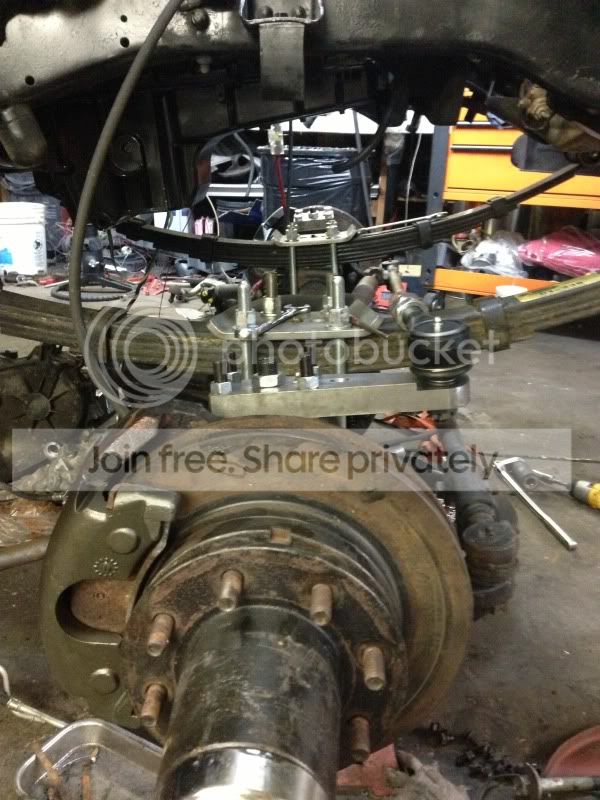

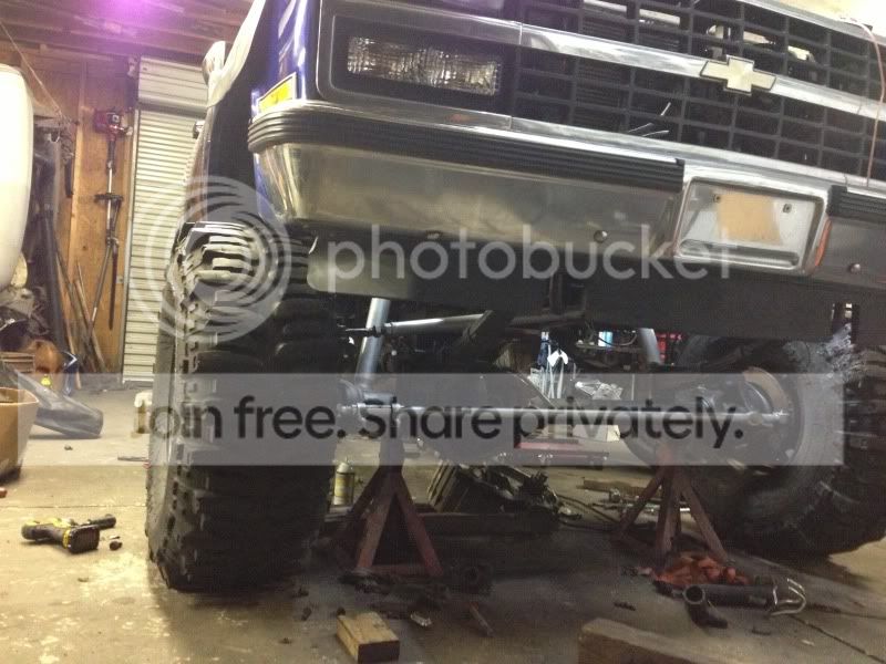

I got my steering rod back today from my welder, threw it in. with the truck still off the tires its extremely hard to turn.
I'm assuming I tightened my set screws for my kingpins too tight, I have yet to find any explanations on how it's done..
Suggestions?
if no king pin springs and using solid arms with adjustable screws . and or any reman / adjustment for a king pin 60 .
the spec is 25 lbs pulling force per knuckle with a fish scale .
undo tie rod from left to right and hook tie rod hole on knuckle and pull . should be around 25 lbs on the scale.
Perfect, I definitely adjusted them too tight then... Ha

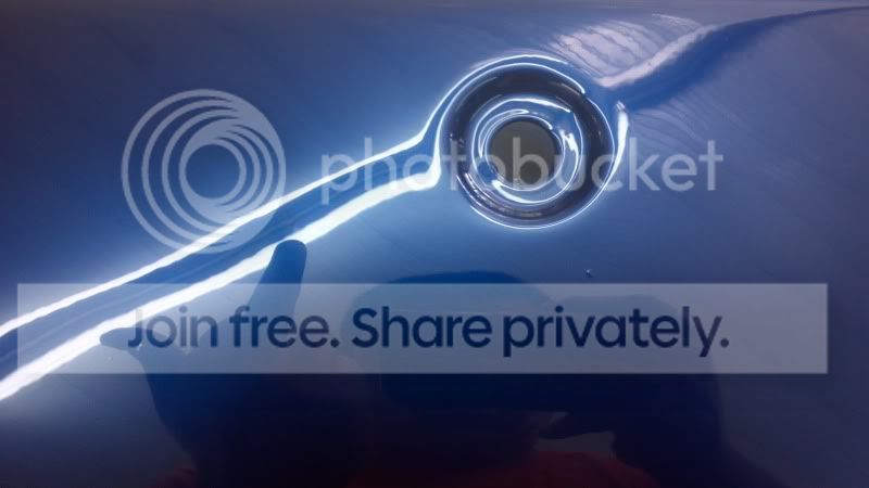

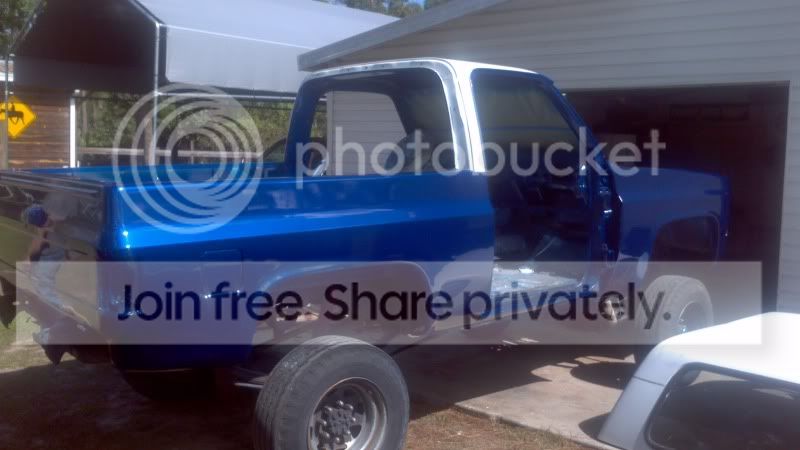

"Fiji blue" it's off a Honda civic SI.

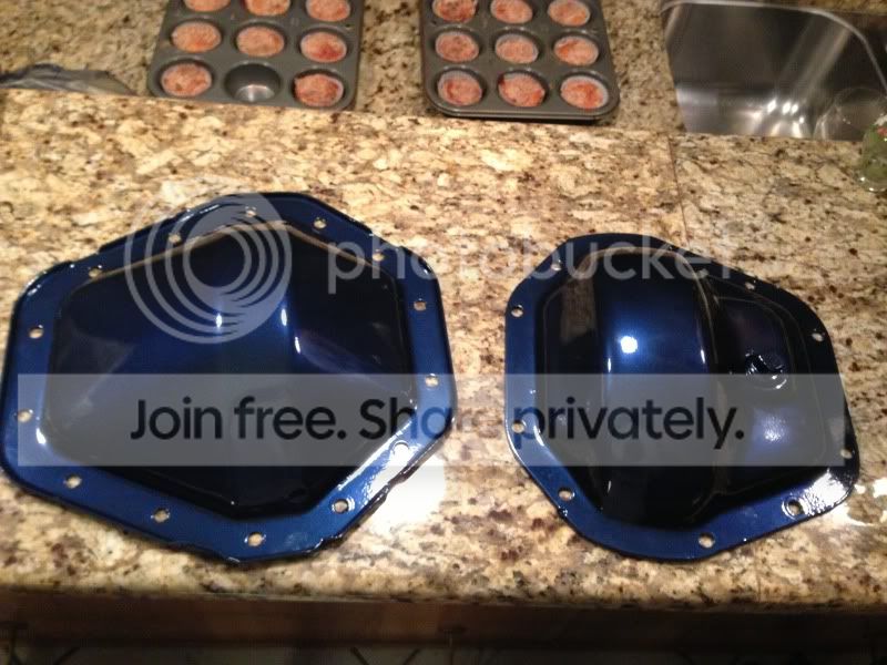

Got diff covers back from Powdercoat..

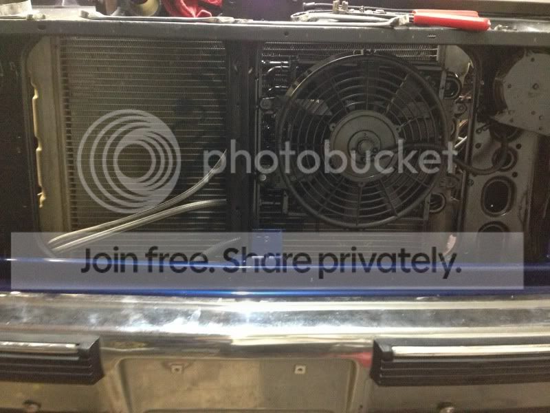

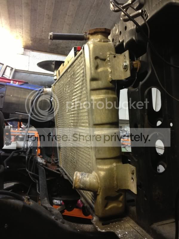

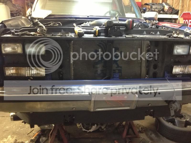

Couple two updates, I originally bought a 6.2 radiator for this truck, but the hoses I would've needed to splice together all in all I wasn't happy with how it would've turned out. So I kept perusing craigslist and local forums for a radiator..

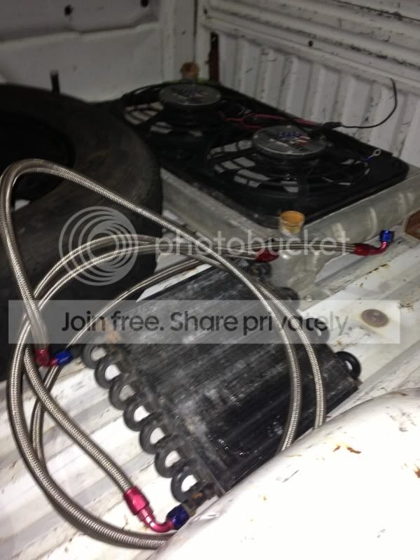

Low and behold found this, Griffin radiator, dual flexlite fans, trans cooler, -6 AN cooler feed lines... how much you ask? 200$:D
All fits like a glove, went to a local speedshop for some AN adapters, and different fittings because I didn't like how the 90 ends were going to route the lines... cooler alone with fan like I used is 180 :eek1: ballin deal I'd say.
Can't hardly see the cooler... excellent.

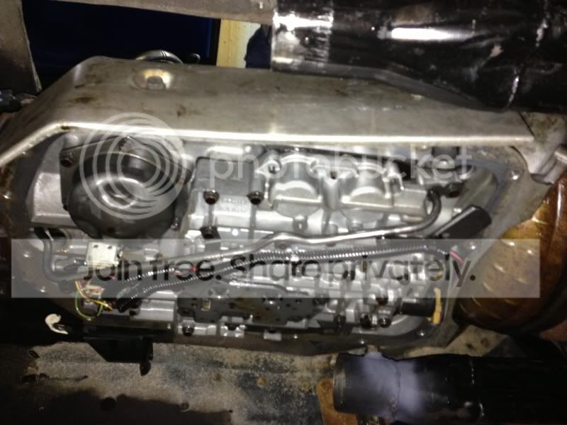

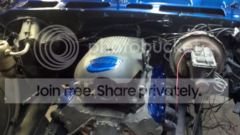

Quite impressed with how clean my junkyard transmission was on the inside..
Got it fired up as well, painted some stuff also. Getting closer....

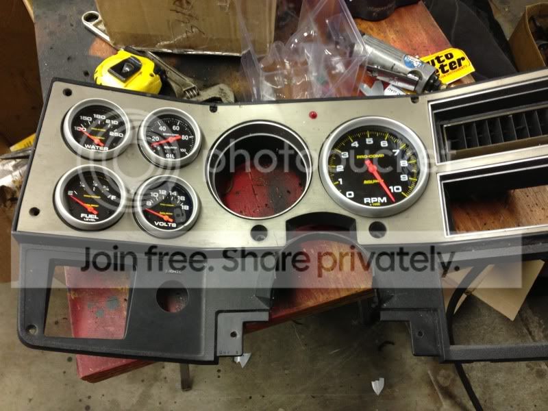

Only need the speedometer to finish my cluster also.

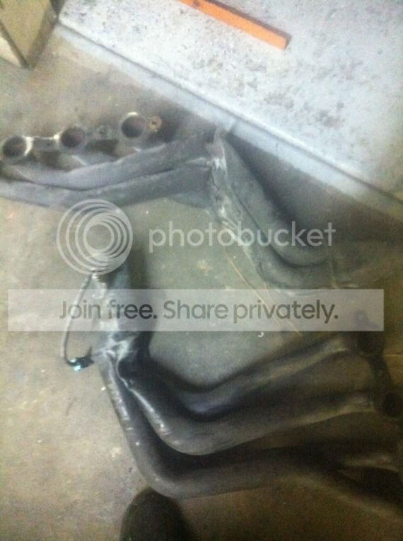

Headers are Schoenfield 88/98 LS swap headers. They clear everything fine, however I had to cut the collector flange off, and rotate the O2 bung vertical for the drivers side.
As it comes they hit the shackle, opposite would've went into the trans, so I made my O2 face upwards.
Engine side mounts are dirty dingo 73/87 sliders, with poly inserts.
