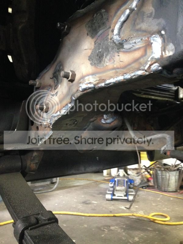

Did the SYE, weld in brace/repair kit, ladder bars, and made my own "bolt in brace"
Quite happy with how everything turned out.. I can actually stand on it and not worry about the atrocious axle wrap and drive-shaft problems I had before:D

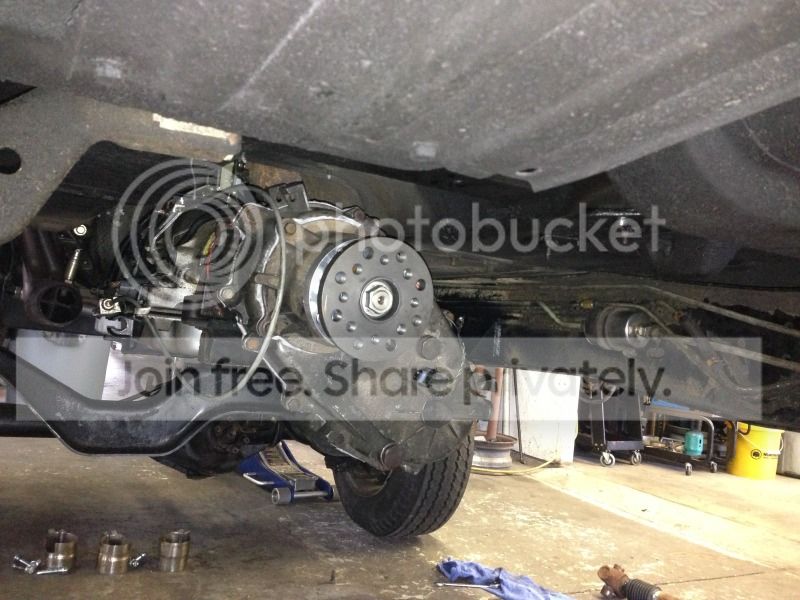

I went with a F350 front drive-shaft and had it shortened, has anybody had the center bored out to fit onto the 241/208 front output? Or ground the flange on the output flat? Thus being able to use one for a front shaft as well, I was quite impressed with it's spline size... I've "stripped" several front shafts back in the day..

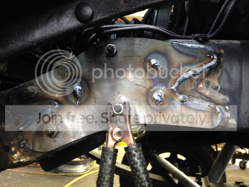

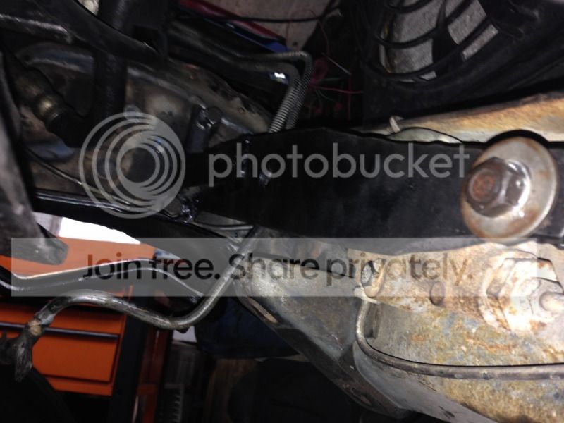

And my hillbilly weld in brace, I welded a rod in between 2 of the bolts for the steering box, then added a piece of flat stock that got bolted into the front cross member, added some triangulation, bolted it in... box doesn't move any more.:woot:
Apparently the only picture I've got of the ladder bar parts..
Frame brace prior to back brace

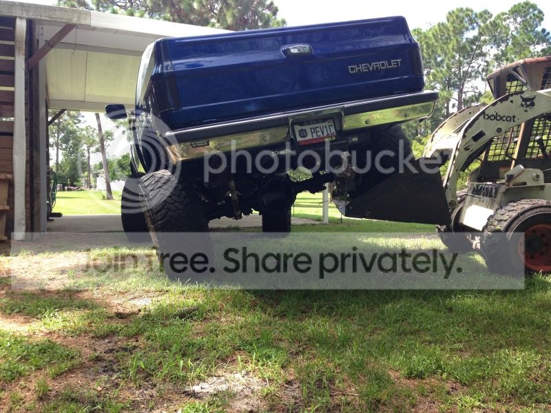

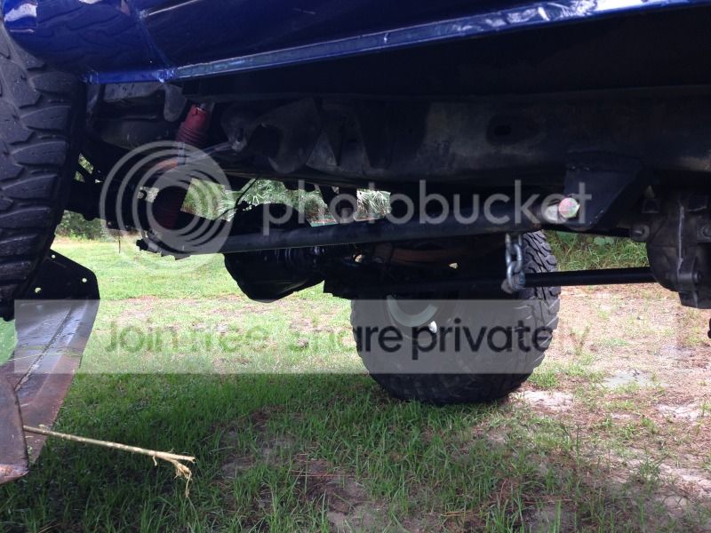

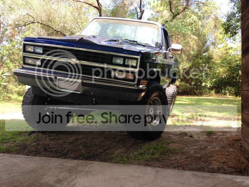

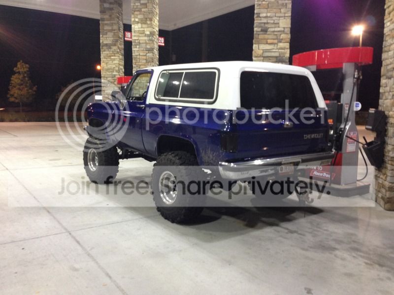

Also had a friendly argument with a friend about where and how I did my ladder bars will limit the truck's "flex" ability. Thus... out came the bobcat to take poser shots depicting more flex than I'll ever put the truck into.. Guess they don't limit the flex too greatly.

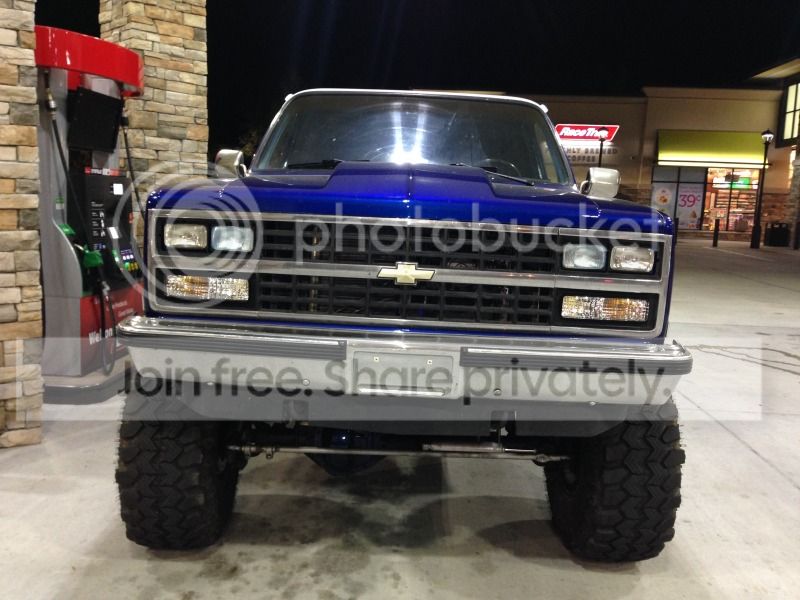

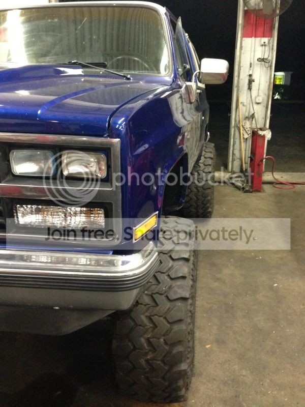

We have new kicks folks :)

That weld on steering piece you got...I'm assuming didn't come with the instruction sheet. It's not supposed to be welded 100% solid like that.

Thanks... And no... Oops..

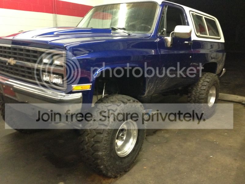

The lean, I haven't figured it out. It's got new bushings all through the springs, and the perches are the same height. Yet one shackle is always farther back than the other.. When I get time I'm going to switch springs side to side see if it changes anything.
It's even more so leaned because I didn't hold the phone level.

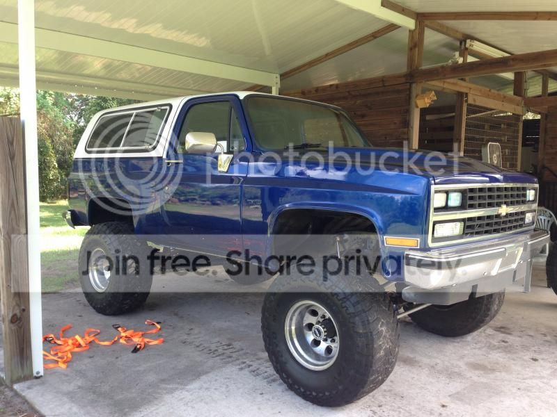

I just wrapped up doing my ORD 1" Body lift, in the rain no less..
When I closed my tailgate my springs are rubbing the trim piece between the body and bumper..

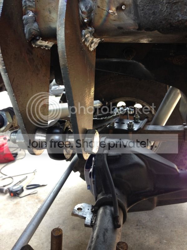

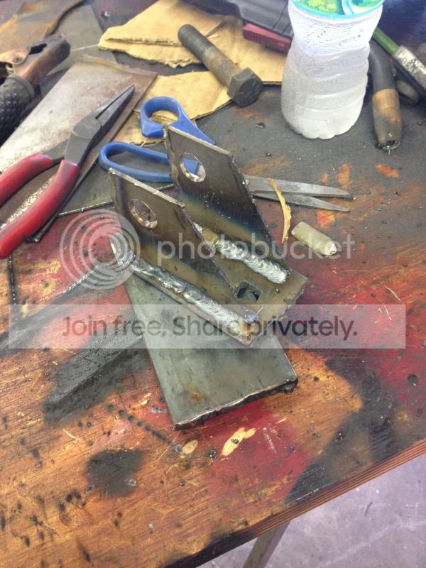

Brackets came in from Rompinstompinmudmonkey for the Trac-bar..
Came out nicely! I had to drill them out and tweak a couple things due to using a larger heim than he did, and having taller springs. Ended up cutting off my bump stop in order to mount the frame bracket where I wanted it.
Yes, I plan to weld metal between the two brackets to stiffen them up. The way he sent the brackets I hadn't anticipated this, so I didn't have enough 3/16 to start bracing them. I'm also considering building another crossmember to go under the engine one, help tie in the two frame rails.
Let me tell you... This thing drives amazing now..:eek1: Steering reacts like it's got a rack and pinion, very little wander as compared to before. ZERO bump-steer.
