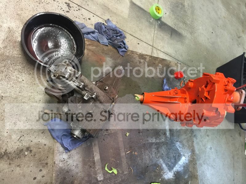

It is the rear of the case that is cracked, right?

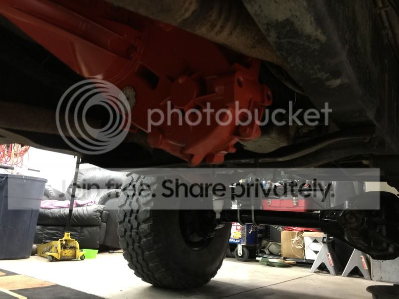

Grabbed a used NP208 from a guy locally. Painted it orange since none of you guys have made fun of me for making it pretty.

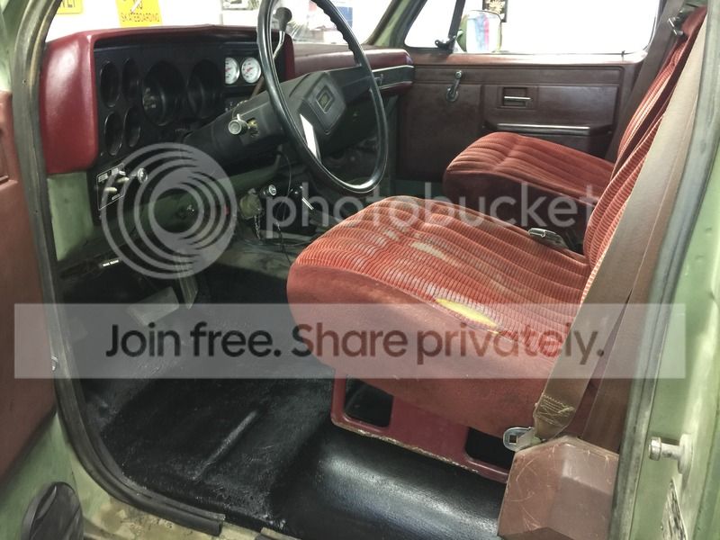

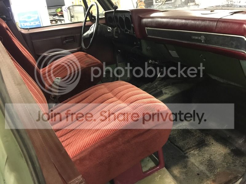

Also in hopes of clearing out the rotten mouse piss smell, I pulled the bench. Did little prep work on the floor and shot some under coating on it. Seats are not mounted yet. I plan to just drill and bolt them to the floor. Hopefully that's enough support for them
I would want the seat mounts fairly stout if it was me!?
Maybe some plate under the sheet metal or they will eventually rip through.
I guess I figured a bigger washer would take care of that.
