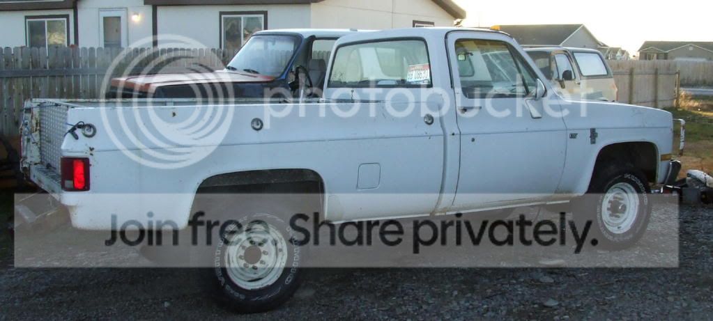

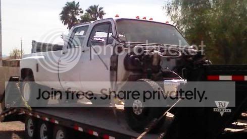

I got the crew cab from a buddy in vegas who had bought it for its front 60 axle and then went another direction with his build. He owed me and after trying to sell it for 5 months or so he said come and get it, its yours.
I had that flatbed and white truck still, the white truck had an engine fire and the 350 in it was way tired anyway. The flatbed had a 454 with a 465 in it and I thought I would just use the parts I wanted.

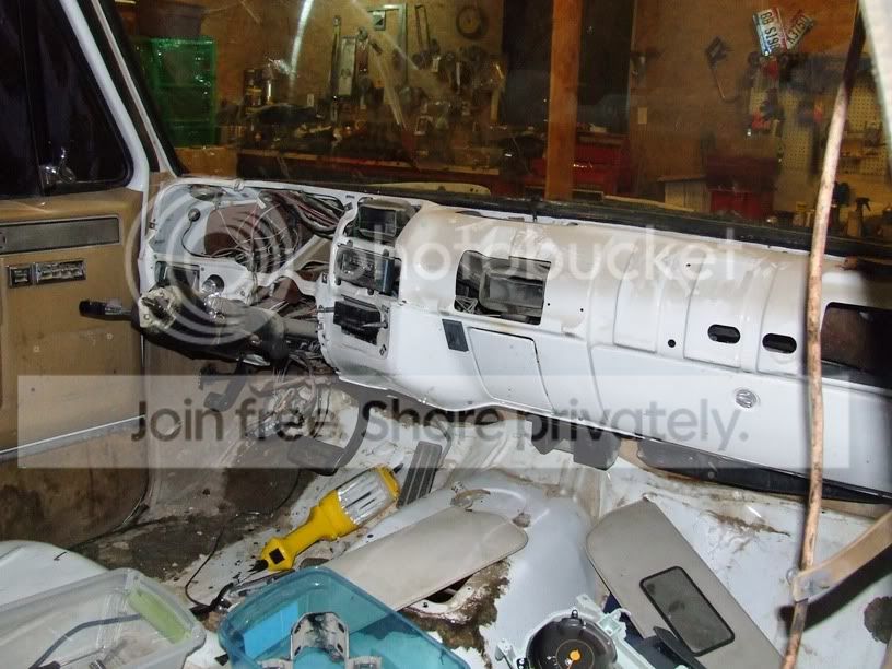

So I tore the daully apart
To make the inside nice, as all I was going to do was regasket the motor and put it all together.

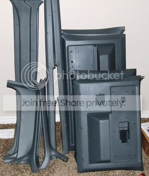

So I bought some nice interior bits, new carpet, pulled the door panels and changed the color
BTW SEM is the ONLY way to go don't go thinking anything else will work as I did not use SEM and they chip very easily.
