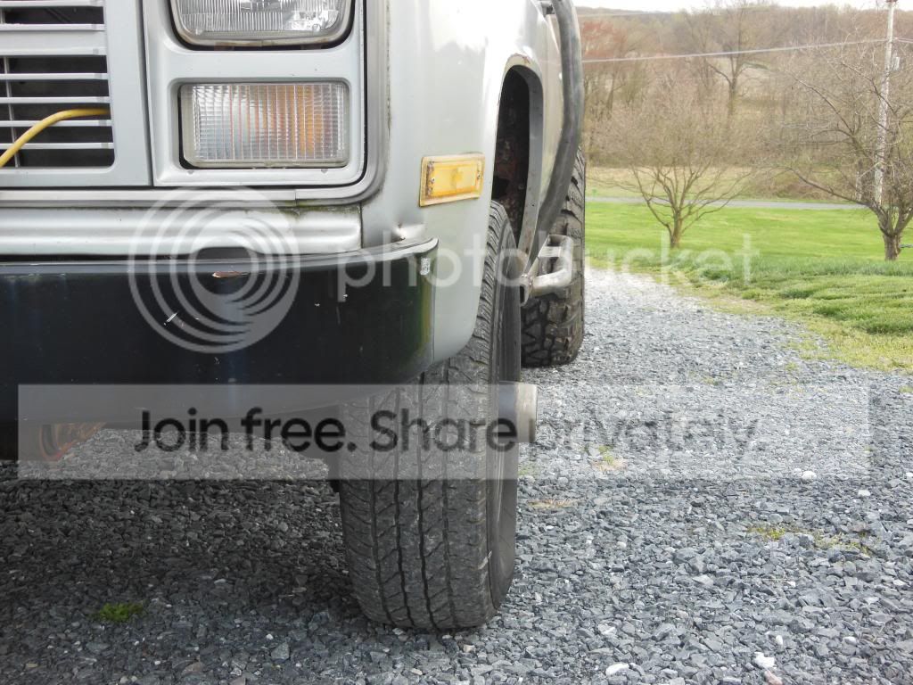

Another shortened, tubed K30 in Maryland........what are the odds :D

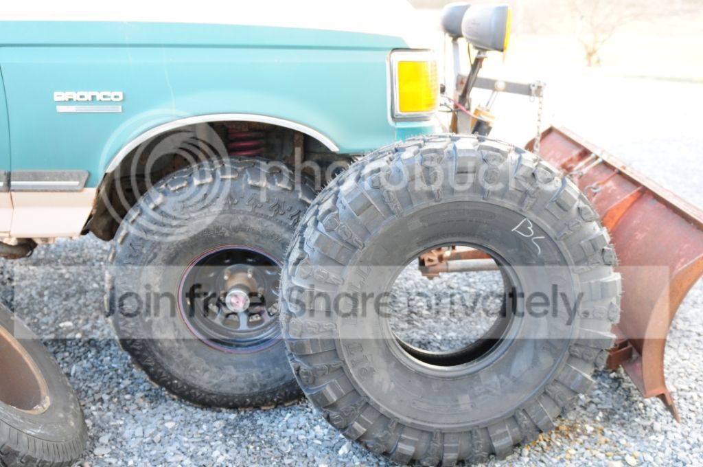

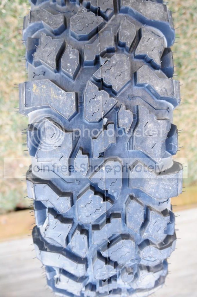

I was planning on trying to pick up a used set of 42s and run those. Well my BIL called me and said he found some Pitbull Rocker Blems for sale. 4x4 Group Buy had (4) 42x15x16 Pitbull Rocker Bias ply blems shown on their website for just over $400 a tire ($100 off per tire!!!). I immediately called Jason at 4x4 Group Buy to see if these were still available. He informed me they were and the tires were cosmetic blem only and still had full warranty.
I also was interested in some beadlocks and got a great price from Jason on four steel Allied Racing Rock A Thon 16x10 8 lug with 3.75" of backspacing.
I called the wife to explain how great of a deal this was and she let me pull the trigger on the wheels and tires. I really did not need them yet but I was not going to let this deal go. Shipping was not cheap but it was still a great deal. The beadlocks were backordered for two weeks but I was in no hurry.

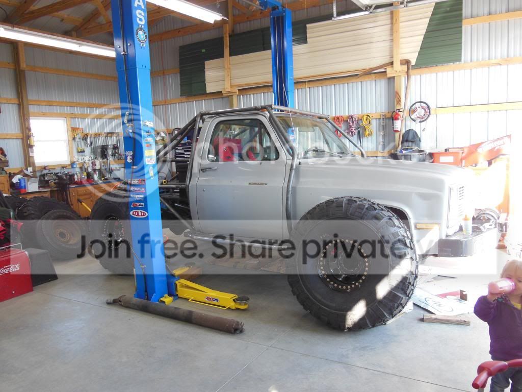

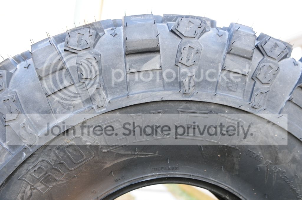

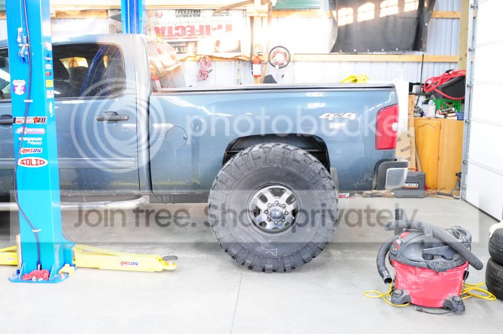

Tires showed up truck freight only a few days after they were ordered and man did they look huge. I also still have no idea why they are cosmetic blem tires other than they are stamped Blem.
Sitting next to my old offroad truck dwarfing my 37" TSLs
Little fender trimming and they will fit fine!

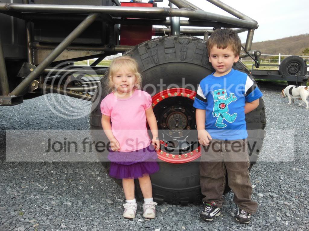

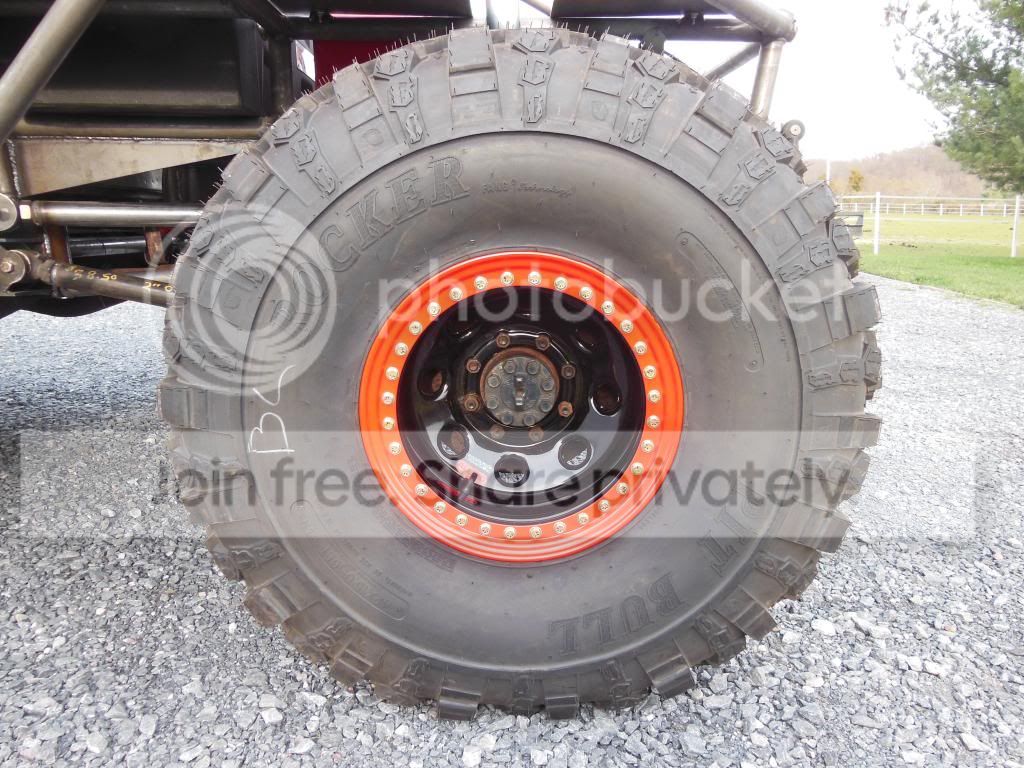

Wheels came about 2.5 weeks later. After inspecting them I found one of the welds had a 1/4" hole in it and I knew it would leak air. I contacted Allied and sent that wheel back and it took almost a month to get straightened out but I finally got a replacement wheel.

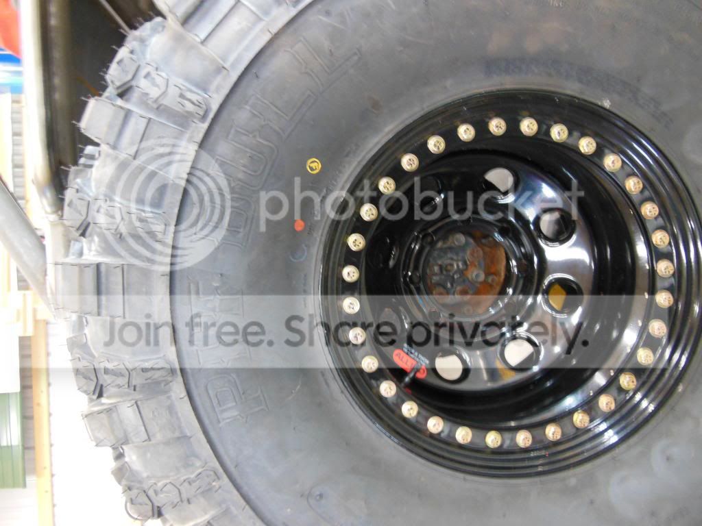

First time mounting beadlocks and it took forever to get them torqued down.

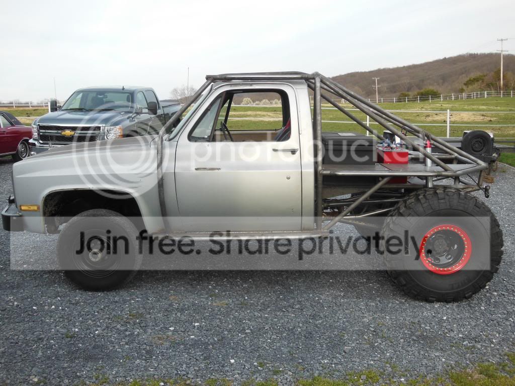

Then I decided I wanted to paint the beadlock rings red. This is what they look like now.
I really like the red rings. They really stand out. I just scuffed them with a scotchbrite and used Rustoleum Professional Safety Red. I will be using this color to accent a lot of stuff throughout the build. They look orange in the pic but are a nice bright red.
Just as an FYI these measure at like 41.5" tall mounted on the 16x10s with weight on the tire at 10 PSI.

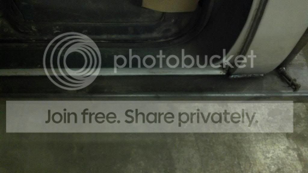

After cutting the frame of the truck the next step was to build the rock sliders / mini boat sides that the main hoop for the exo would attach to.

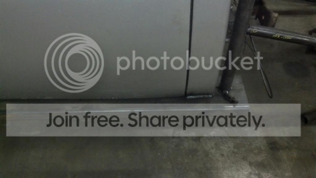

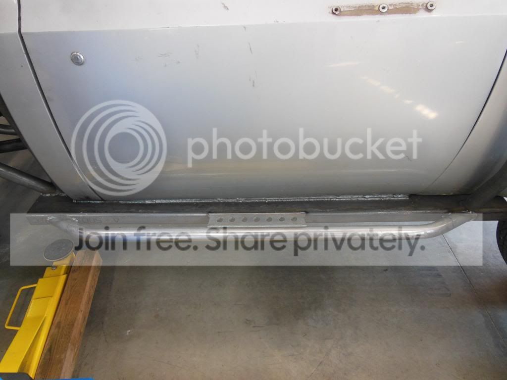

We decided to use 2 x 8 x 1/4" wall rectangle tube for the sliders. The rocker was cut out just below the factory door. In the winter I will still run doors because it gets cold here.
Rocker cut out and slider tacked in place.
With the door open you can get a better idea where the rocker was cutout. Notice that when the truck was painted silver they did not spray the door jambs.
The slider eventually got fully welded to the body all around and also 4 2x2 square tube outriggers per side were welded directly to the frame to tie the sliders in.
Here you can see the slider fully welded in. We also added the piece of 1 3/4 tubing and a step there to help keep trees and rocks out of the door. The front of the slider was left long and will be trimmed when I get the front fenders trimmed out to fit the 42s.

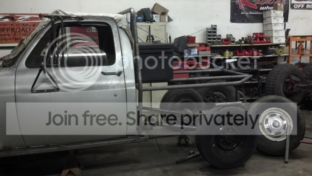

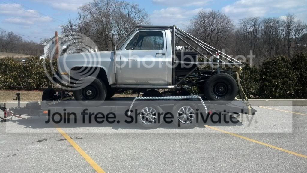

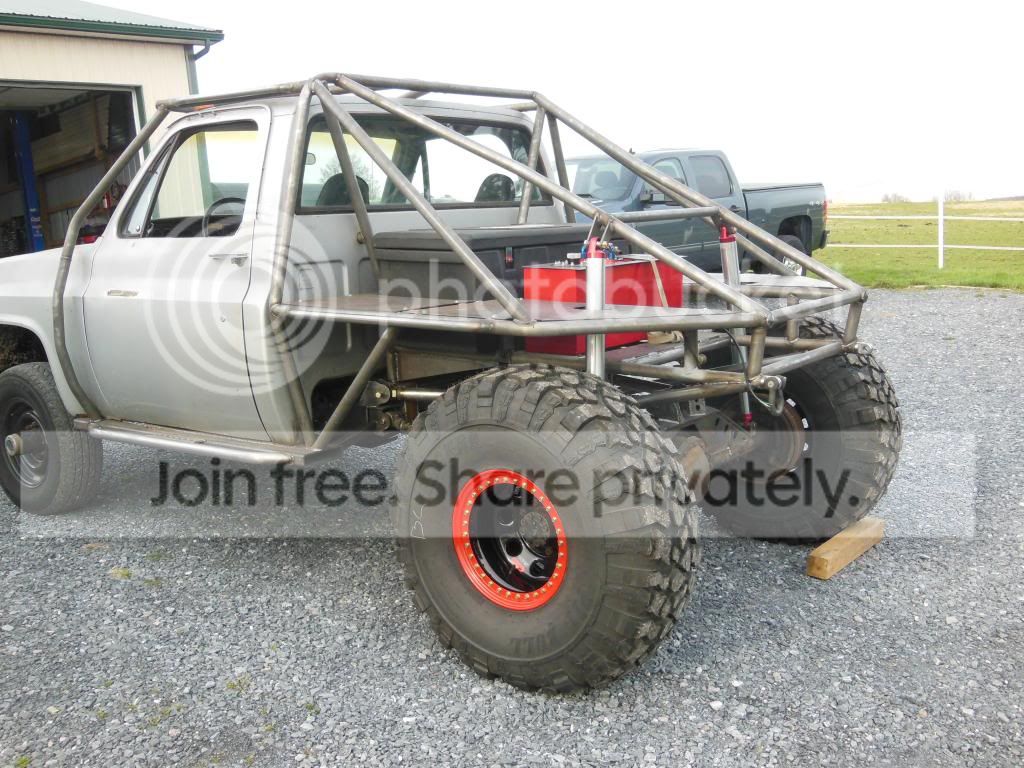

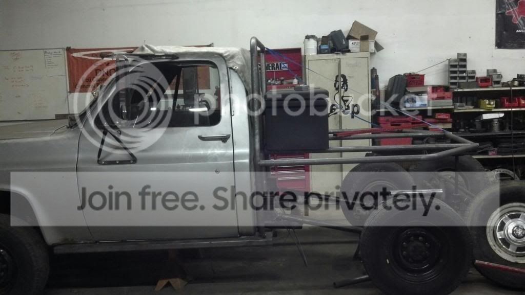

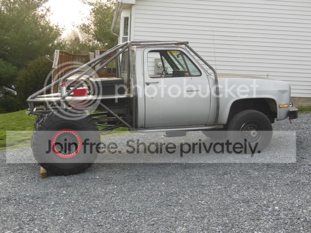

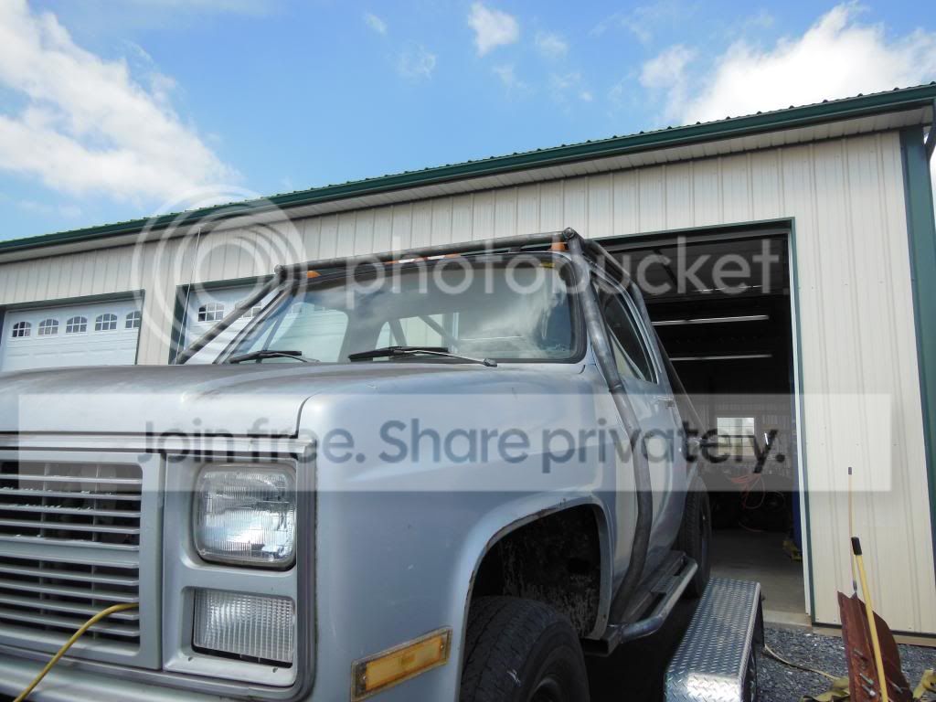

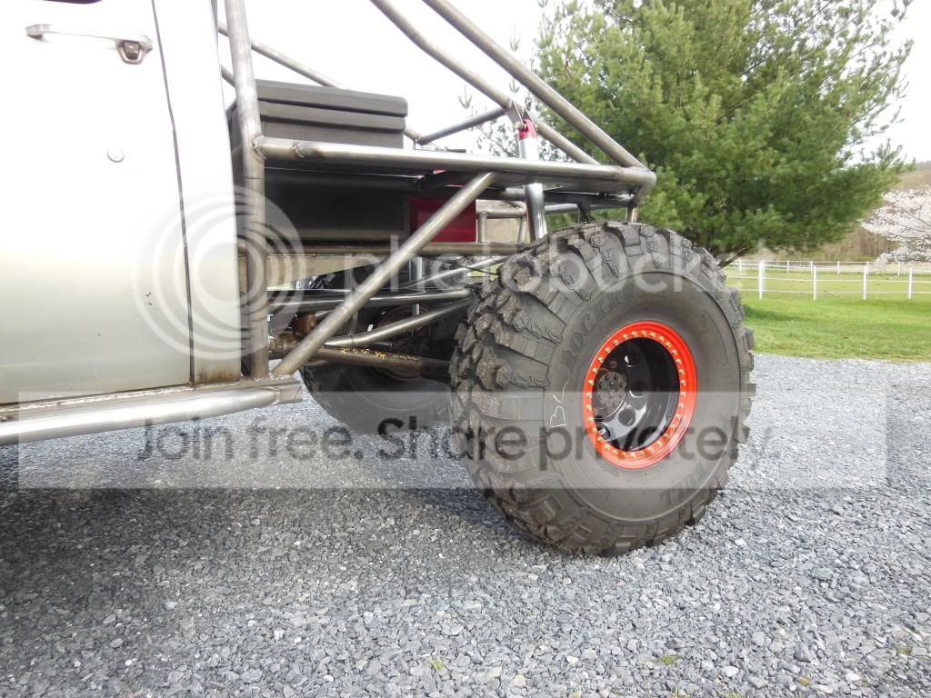

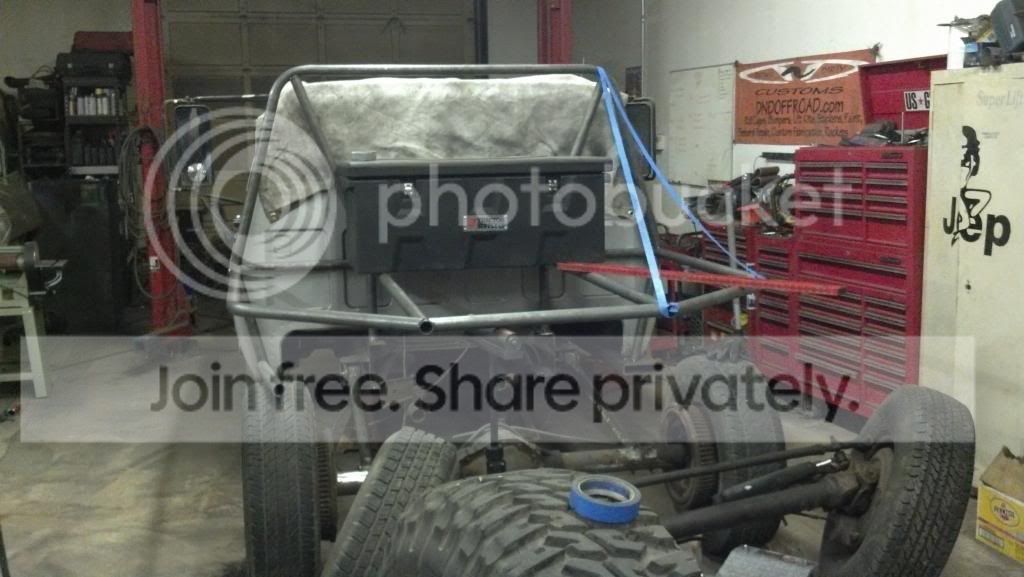

So like I said earlier I don't have as many pics as I wish I do of the truck when working on the tubing. The pics in the last post are pretty much what I have. Oh and the tubing is almost all 1.75" 0.120" wall tube with some 1.50" 0.120" wall tube mixed in. The "decking" is 10 gauge steel (0.1345").

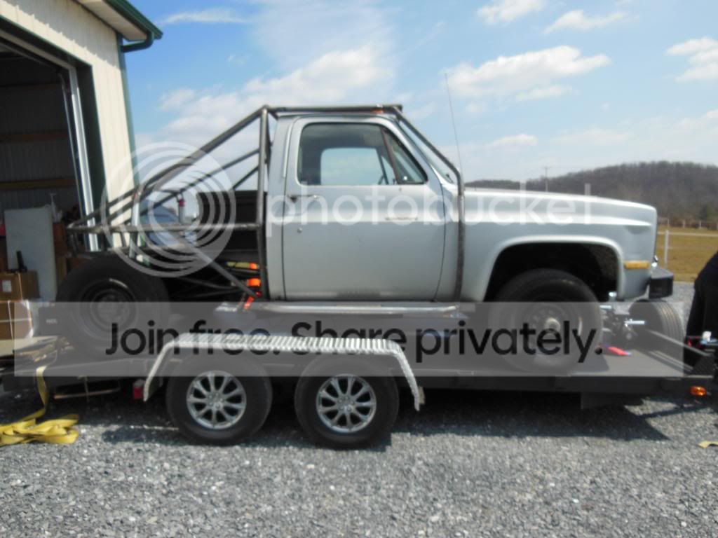

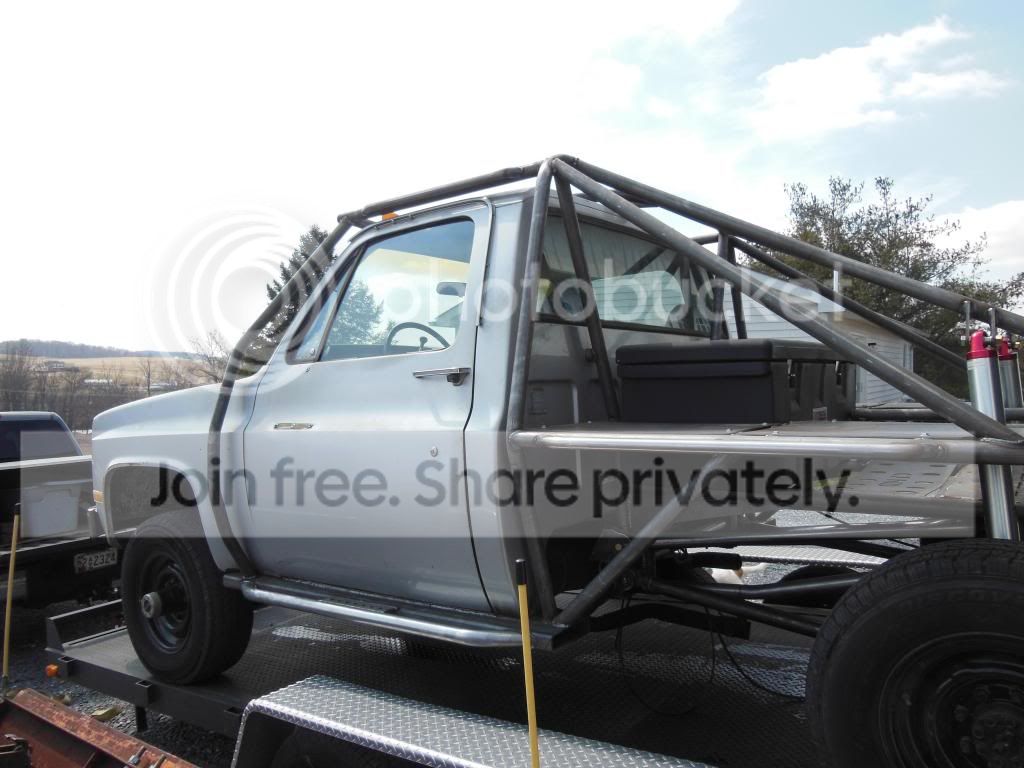

Anyway Mike at DND had the truck for a few months finishing up the tubing and exo. These next pics are from the day I picked it up. At this time the truck did not run because the fuel and brake lines were cut. I picked it up and winched it on the trailer and then into my garage.
On the way home. Note all these pics are with no nitrogen in the air shocks so the rear suspension is at full bump. (As I found out I will need some other bumpstops to keep the 42s from rubbing the tube at full flex) I will point out some of the details in the below pics

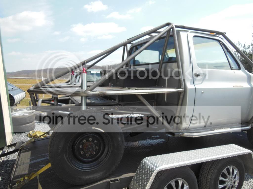

This pic shows the lack of support of the upper shock mount. Once I got nitrogen in the shocks you could actually feel that upper tube move. This was loading the upper part of the Exo and making it flex. I plan on adding a tube straight down to the lower ladder frame to carry the weight. I will also add plate gussets to the shock mount itself. Right now that long upper tube is carrying all the weight of the rear of the truck.
Also if you look hard behind the fuel cell mounting plate you can see another crossmember and plate (right between the shocks) that is drilled to mount a suck down / rear facing winch. I still need to weld on some sort of support for a fairlead.

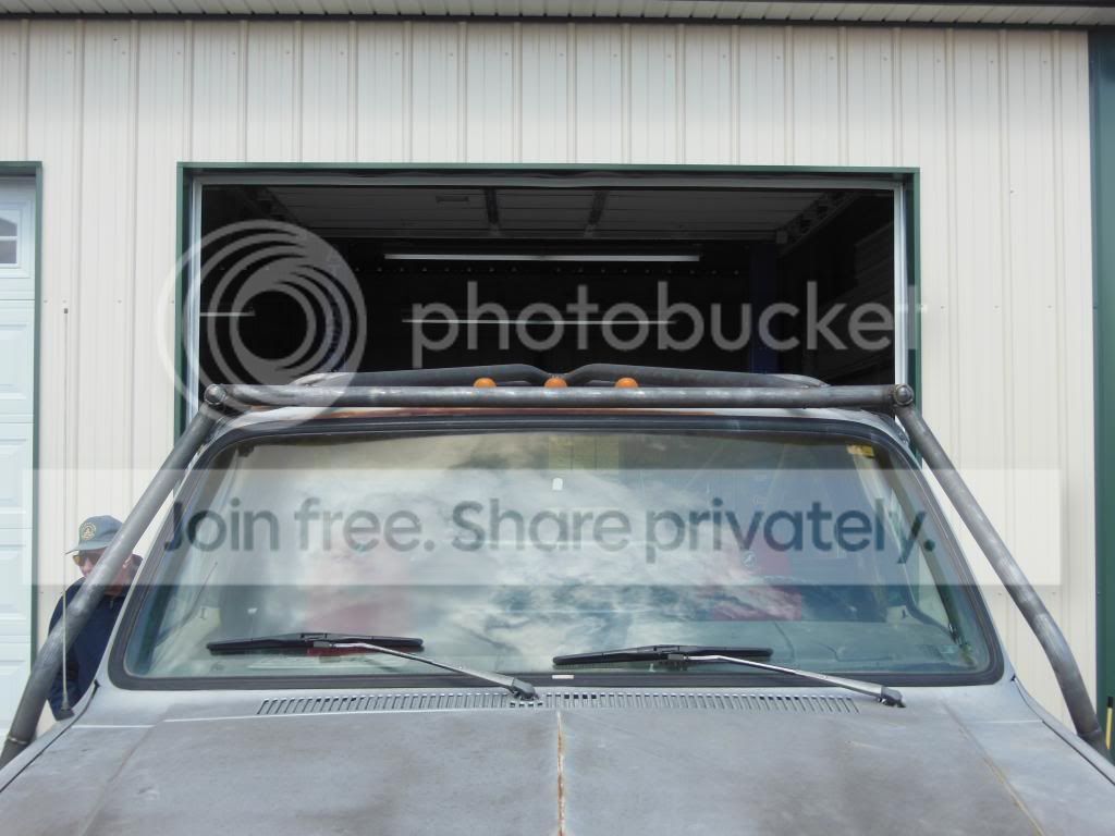

In this pic you can see the added rub rails on the side of the "bed" and the top of the cab exo. We added these so if they get dented they can easily be removed and replaced without being a structual member. I thought this was a nice little finishing touch.

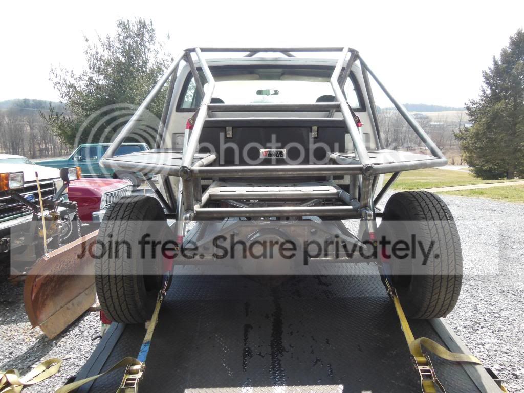

From the rear. Tube work is very symmetrical.

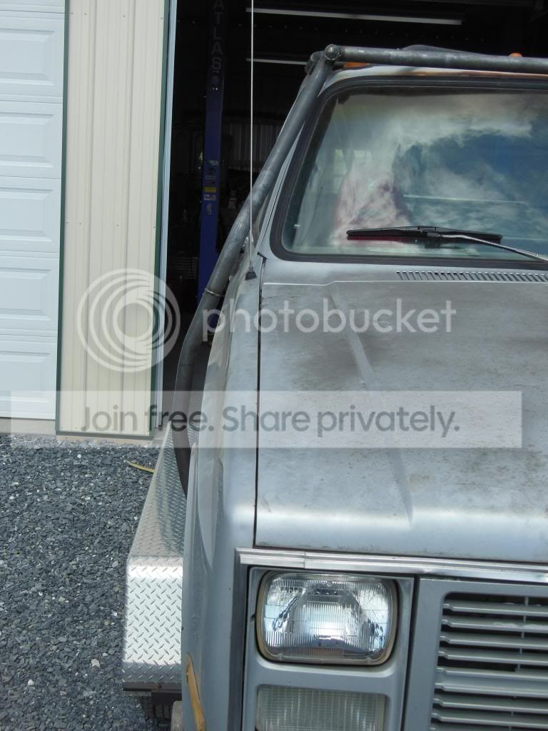

Here you can see the front of the exo. I wish the front Exo bars were closer to the cab as they ended up like 2 inches off the body. They are also forward of the door a bit more than I wanted but in the end they work. I would like to eventually add the front bars to extend to the front bumper and add a windshield bar but that will be down the road. The exo is tied into the rockers.
Only needs a little trimming to fit those 42s in the front. Hopefully 5 inches of lift and moving the axle forward 2 inches or so will result in managable trimming to clear these massive 42s.
Overall very happy with the work that Mike at DND did. I will be adding some gussets and bracing to tie it all together and finish it off.

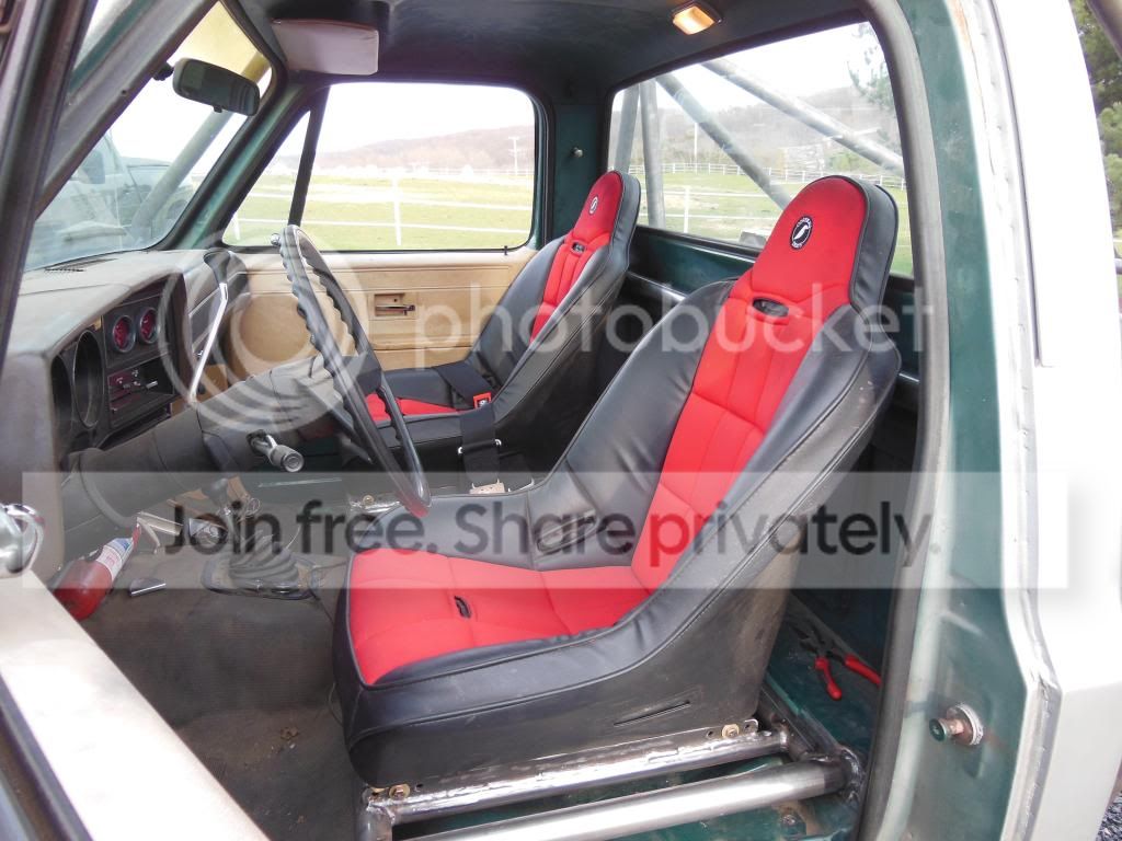

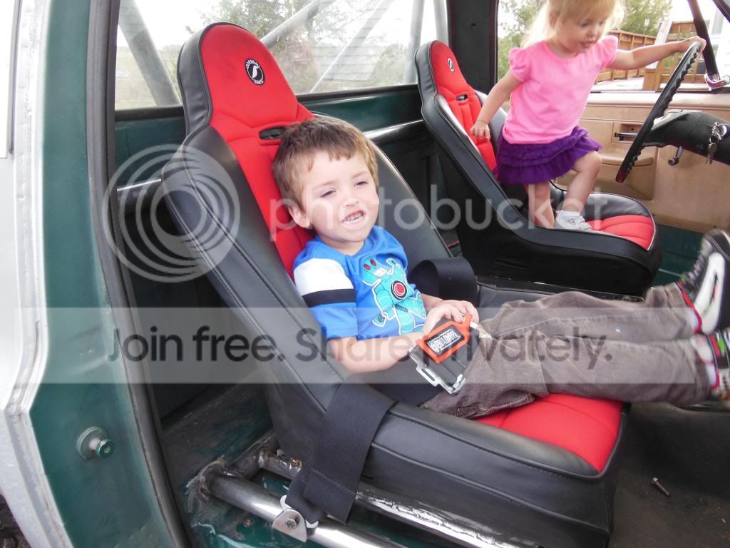

So once I got it home next order of business was to get the seats mounted. I scored some lightly used Corbeau Baja SS seats from a guy and Mike at DND had made some mounts.
The seats are mounted to a frame that is tied though the floor to the sliders and also to the frame of the truck. Brackets with multiple holes were used to mount the seats so they are sort of adjustable. Behind the seats you can see the harness bar that is attached to the main hoop by hole sawing through the cab. I am going to add an additional brace to tie the harness bar to the seat mounting frame. There currently seems to be some flex in the harness bar mount when driving the truck around. I believe once I get the rear upper shock mounts braced better this flex will be eliminated.
The kids approve of the seats!
For Harnesses I bought the new Pro Armor 5 point harnesses. I have not mounted the lap belt yet because I want to add that bracing tube before I mount the belts. The shoulder belts will wrap the rear harness bar and the submarine belt will wrap the seat mount bar.
The drivers seat is at a good place when driving for me but it is hard to get in and out of because of the high side bolsters of the seats and a non tilt steering wheel. I may look into getting a quick disconnect wheel to ease that.

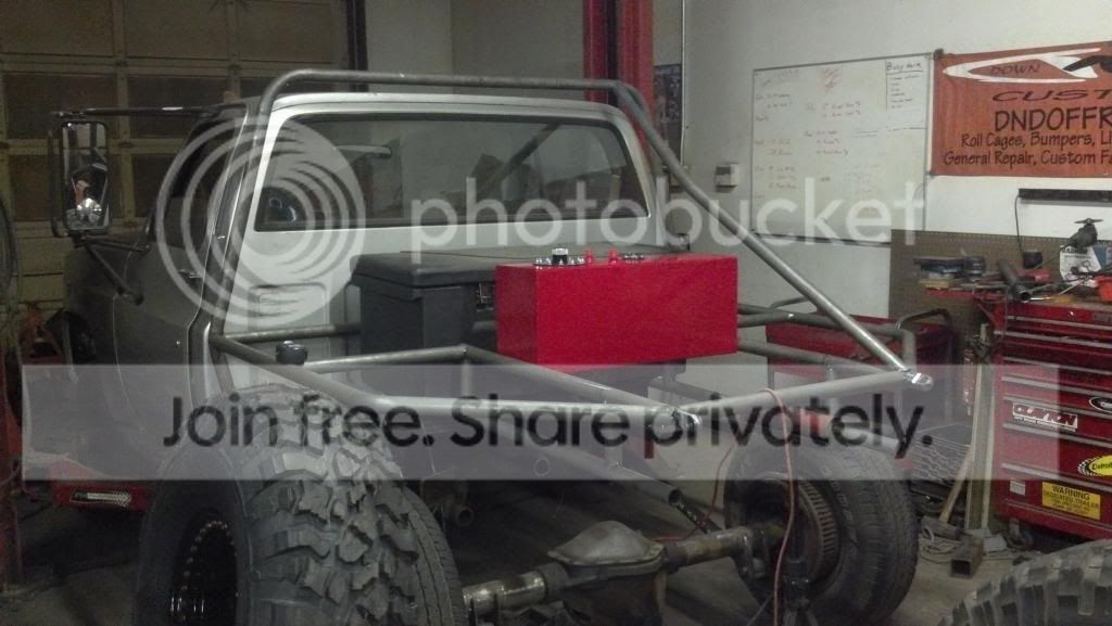

Next thing was to get it running again. I purchased an aluminum RCI 15 gallon fuel cell from Summit with the GM fuel level sender in it already. I chose this cell because it had a screw off lid not the aircraft style, fit well into the space I had (or so I thought) and it had the GM sender so the factory gauge would work.
This is probably one of the better pics of the fuel cell installed.
So I got the fuel cell and went to sit it in place and it would not fit. The cell was a bit longer due to the welds in the corners and would not drop between the frame rails of the truggy. Since I bought the fuel cell powdercoated red I did not want to grind the welds smooth on the cell. On to plan B. I heated the section of tubing that would not let it drop in until it was cherry red and slightly flattened it. After I did this to both sides it fit great. You can hardly tell the tubing was flattened.
So the fuel cell sits on a 10 gauge plate and then there is another 10 gauge top plate. I will use all thread to tie these together and sandwich the fuel cell in place. Right now a ratchet strap will suffice.

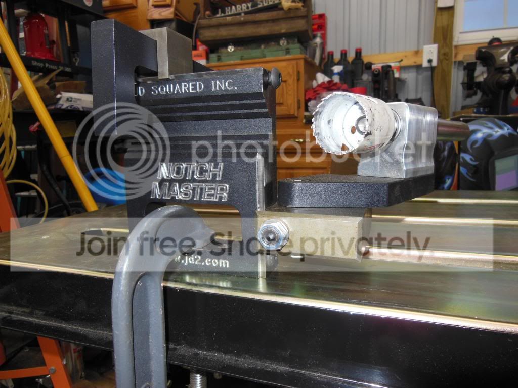

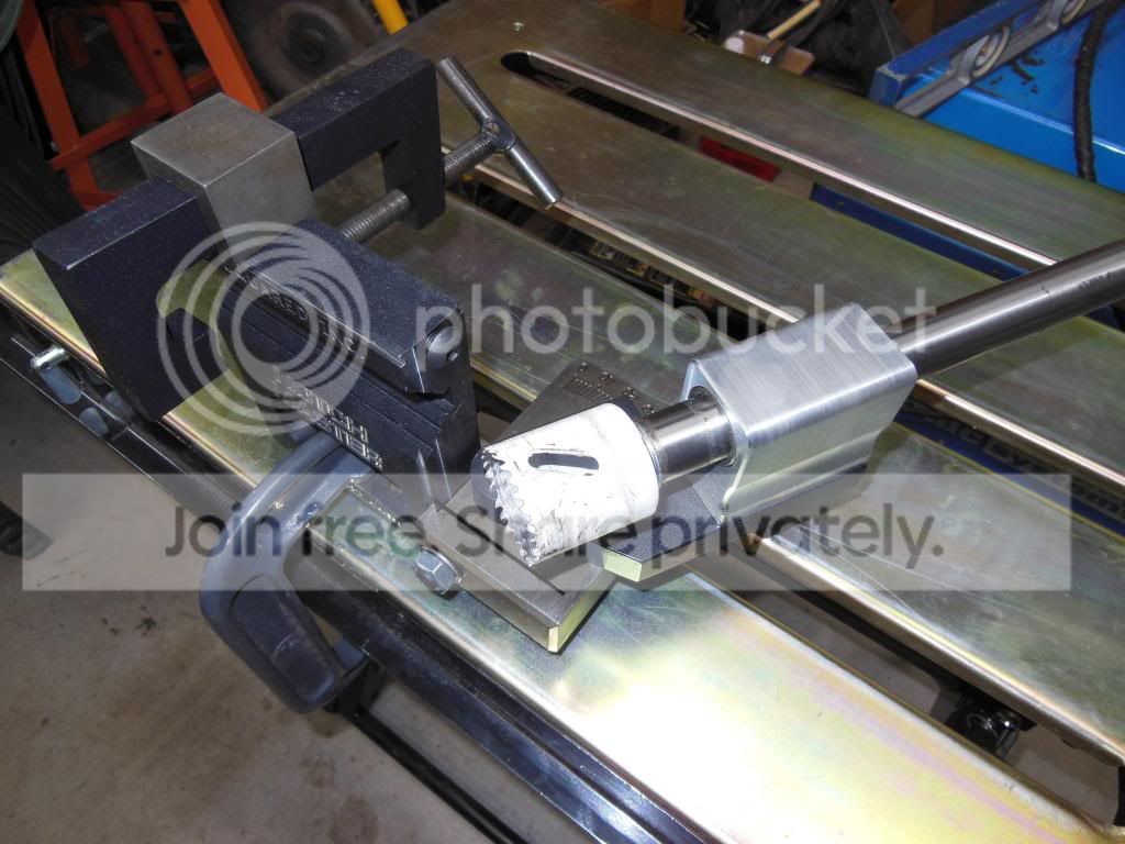

So I needed to buy a tubing notcher. After reading some reviews I settled on the Woodward Fab cheap notcher.
The reviews on Pirate and other places said it was a decent notcher for the price. Well not the one I received.
When I opened the box the degree indicator stickers had fallen off. Ok no big deal. I also noticed the main frame is made out of bent 1/4" plate. Well the bends were not anywhere near 90 degrees and just clamping it on my workbench you could tell it was off.
The bends being off did not effect its function so no big deal. But the deal breaker was when I put a piece of tubing in the clamp and went to notch it the hole saw was offset a little over the wall thickness of the tubing or .120".
This was unacceptable. I did not get a picture of this but it was really far off center. Could I shim it out with washers? Probably but I should not have to. I also felt it would not hold up. I plan to buy a bender in the future so I wanted a notcher that would last.
I immediately called Summit and sent it back. Then I ordered the JD Squared Notchmaster and it should be here shortly.
Moral of the story is you get what you pay for and watch out for made in china Woodward Fab stuff.
the cheap notchers all work like that. It takes some shimming and messing around with them to get them to work well.
Most of us that buy those know that though.
You will love your new notcher but it also ( when you get into more complicated notching) has its limitations.
I use a cheap notcher and then finish my notches with a grinder, allows me to bevel the notch for a better looking weld. Really doesn't help much with penetration, but it does help when you are welding upside down with the torch 3 feet away from you squinting out of one eye using your other hand to balance your body and your legs spread eagle with your junk in dangerous proximity to falling RED FREAKING HOT slag
I figured all the cheap notchers were that way but the mechanical engineer in me could not deal with the poor construction.
I have seen/used the nicer notchers like the Notchmaster and I guess I was expecting the same quality but should have known better for the price.
I would love to find a used bender and die so I could build more stuff like the front half of the exo and a bumper but that is on the back burner until I get more done on this build.
So quick update. New tubing notcher came in and it is super nice. Works well and looks pretty pimp too :pimp:.
Pricey but I like it so far. Very easy to use and super adjustable.

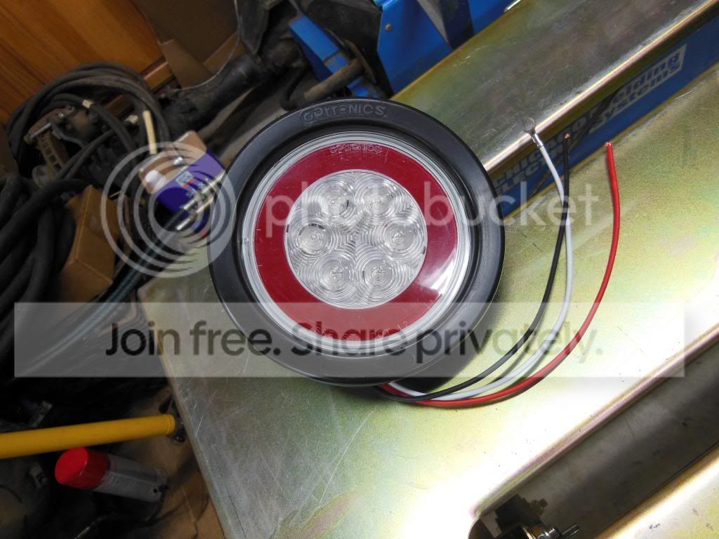

Rear lights. LED the red ring is the running light and the center are red LEDs that are the brake and turn. These are super bright.

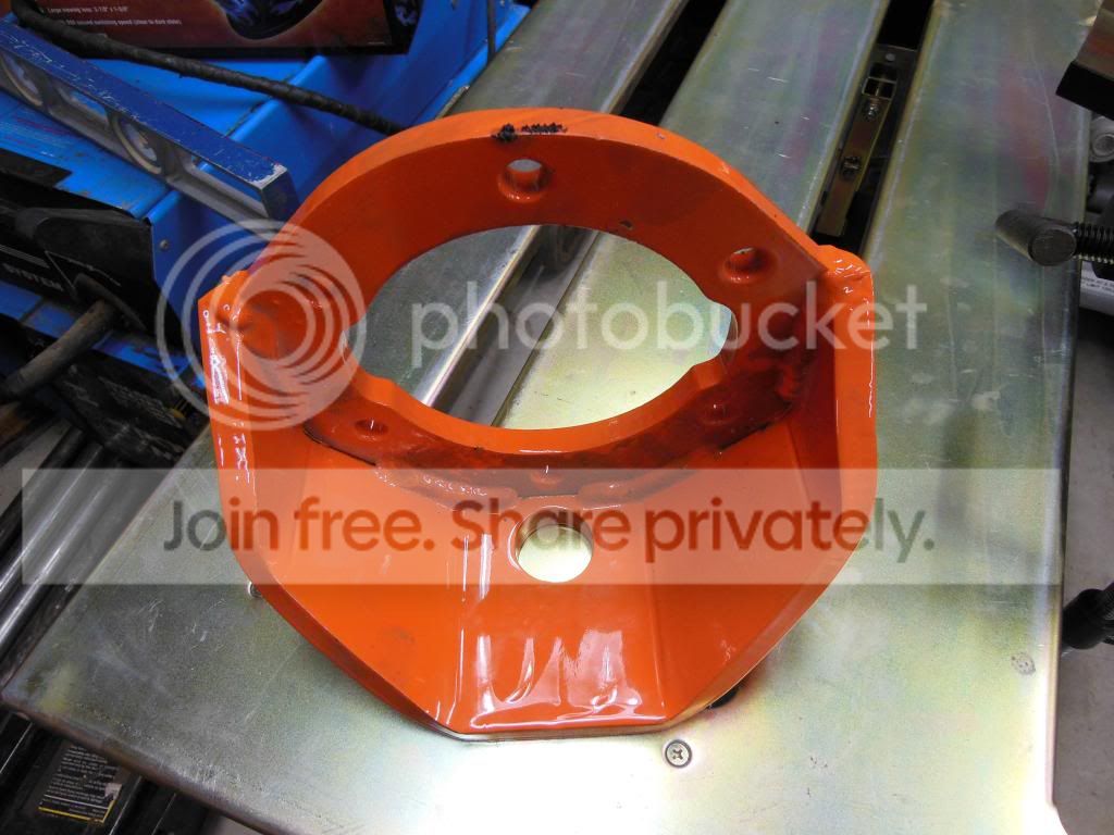

14 bolt pinion guard bought from Ryoken used (I need to get that orange painted over)

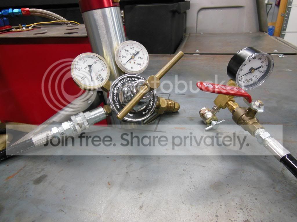

I also finished my nitrogen charging setup for the air shocks. I picked up a used Nitrogen regulator at my local welding store used for 50$ = awesome score. I used some hydraulic hose and hydraulic quick connectors because they are rated for more than enough pressure. Then to a ball valve and gauge with the poly performance fill valve.
