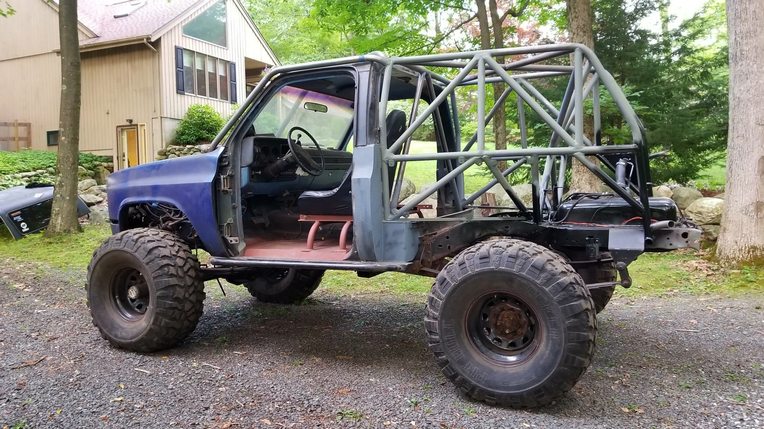

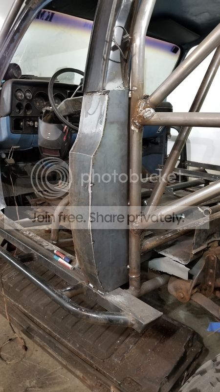

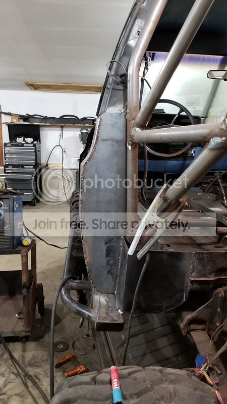

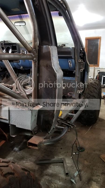

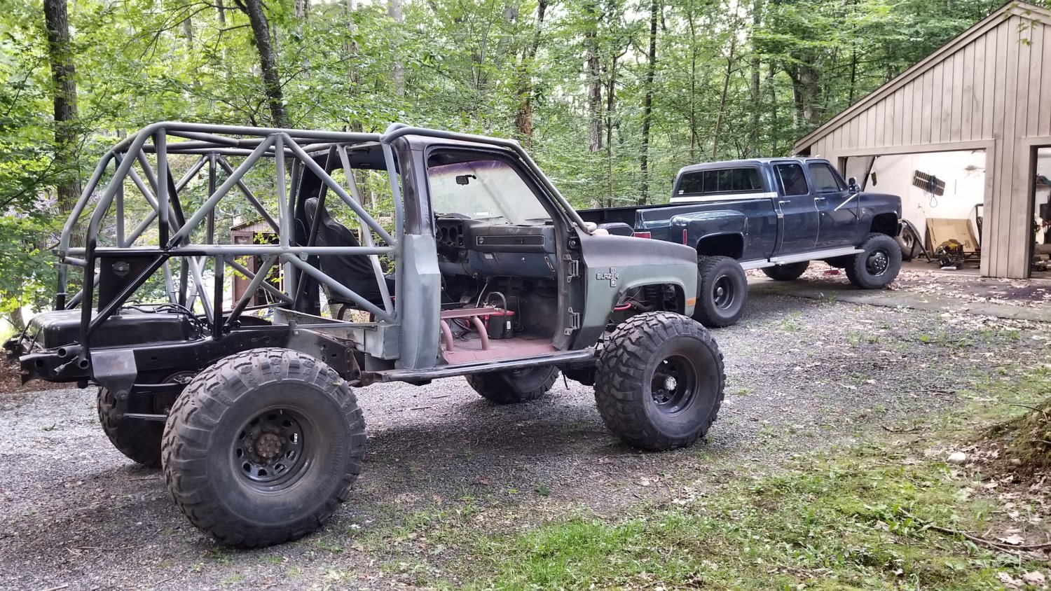

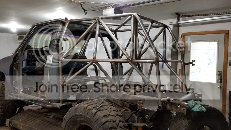

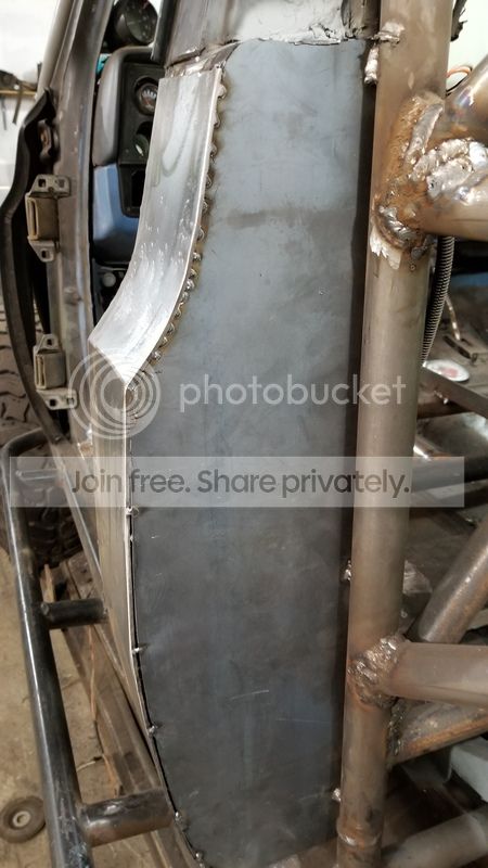

Unfortunately, all I have done is add in the bars on the B pillar and cut out the front floors to get rid of rust and add in seat bars. I have been stuck doing non-stop house projects. I hope to get to the truck soon some night!

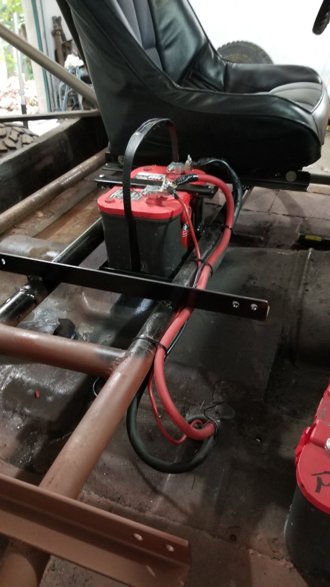

This summer has been a very busy one, not truck wise, a few vacations, and a lot of rebuilding our deck. We doubled the size of our deck and installed Trex, and still have to do rails. So that has eaten up a lot of my time, however I have worked a little on the truck, the cage is fully welded finally, I installed seat bars and mounts as well as body armor. Next is back seat/panels and install a floor again. Once thats done, the gas tank can go in again above the frame, plumb it, put the front brakes back on, then mount batteries... so who knows! I am hoping that is all done by september.

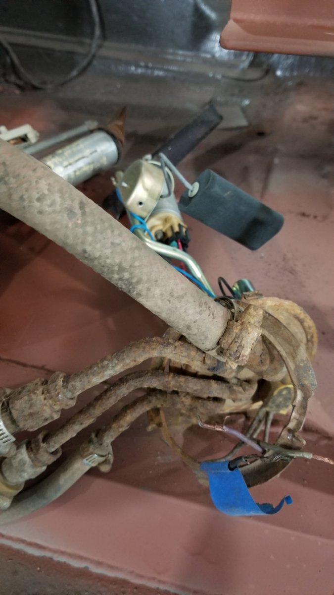

So I emptied the gas tank...all 25 gallons..not sure what to do with it. It's been sitting for a year. Octane boost and put it in a car?

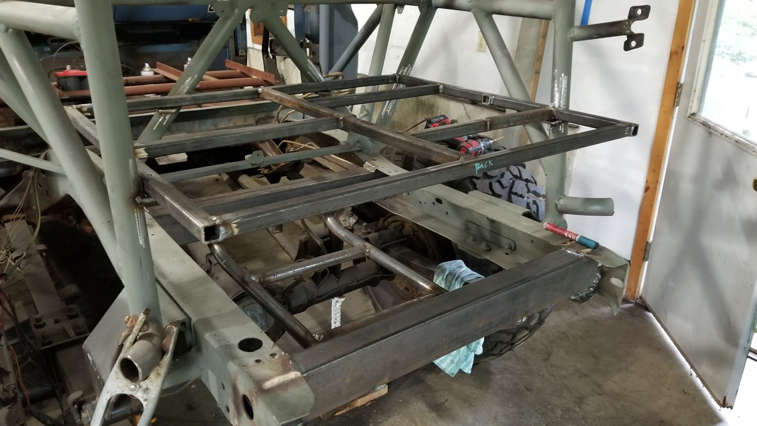

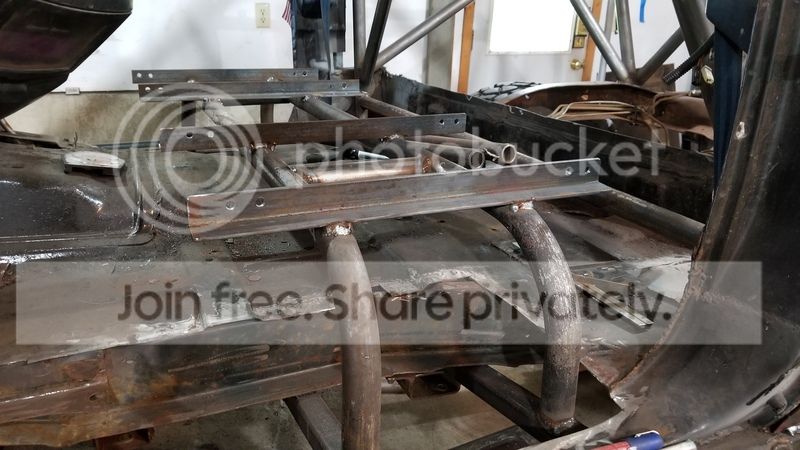

Anyways, I had to cut out the cross members out to set the tank flat in the frame. I wire wheeled the whole tank down clean and took the very rusty sending unit out.
Now I just need to build a bottom skid and a top removable bedfloor.
Since my deck is done... I have lots of extra time to work on the truck.. pretty happy with the deck though.

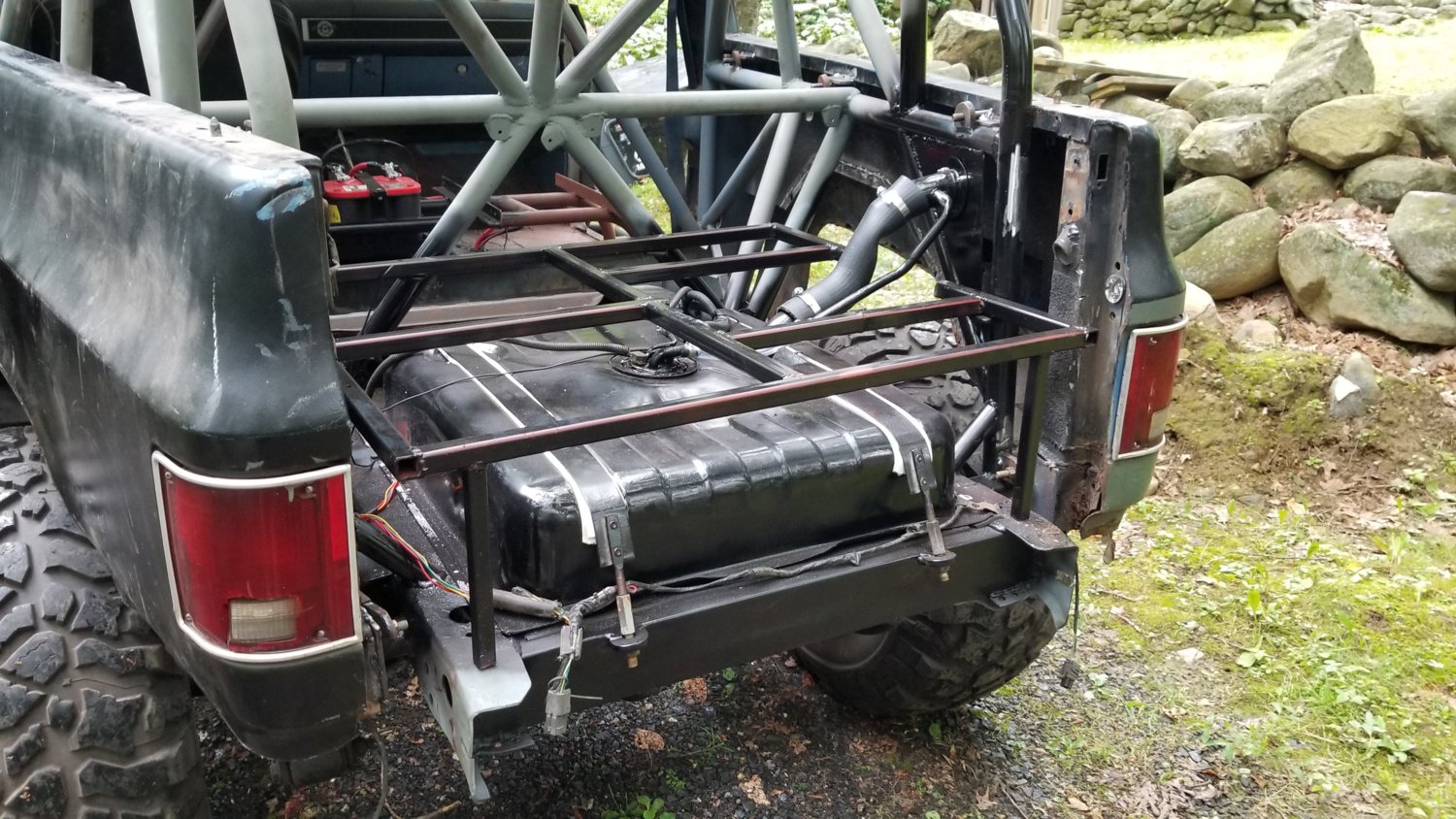

So I wanted to raise up the gas tank, and today I installed new cross members, then took some 1.25 tube and bent it up as a cradle and skid plate area for the gas tank. I then tossed the tank back in, took some measurements and added a bedframe that sits on some 1/4inch tabs to make it removable when needing to access the tank.
Basically I need to now make a filler neck off the cage, then get some rubber strips and add some tie down areas for the stock tank straps.

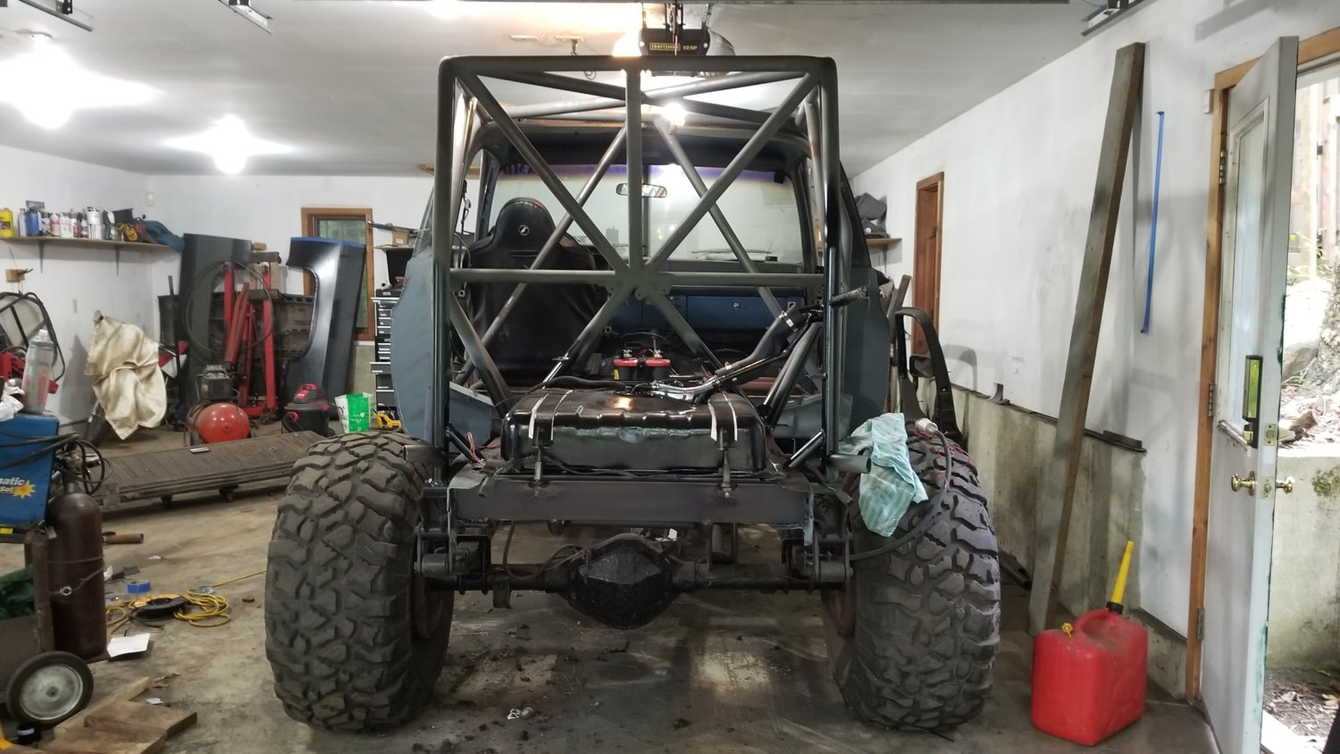

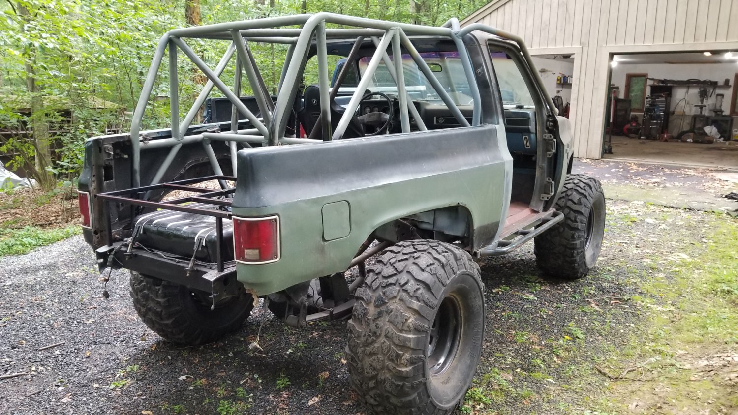

Does the rear look a little tall?
Looks good.
The rear may appear tall from an optical illusion. If you follow the bottom of the frame, it looks fairly decent.

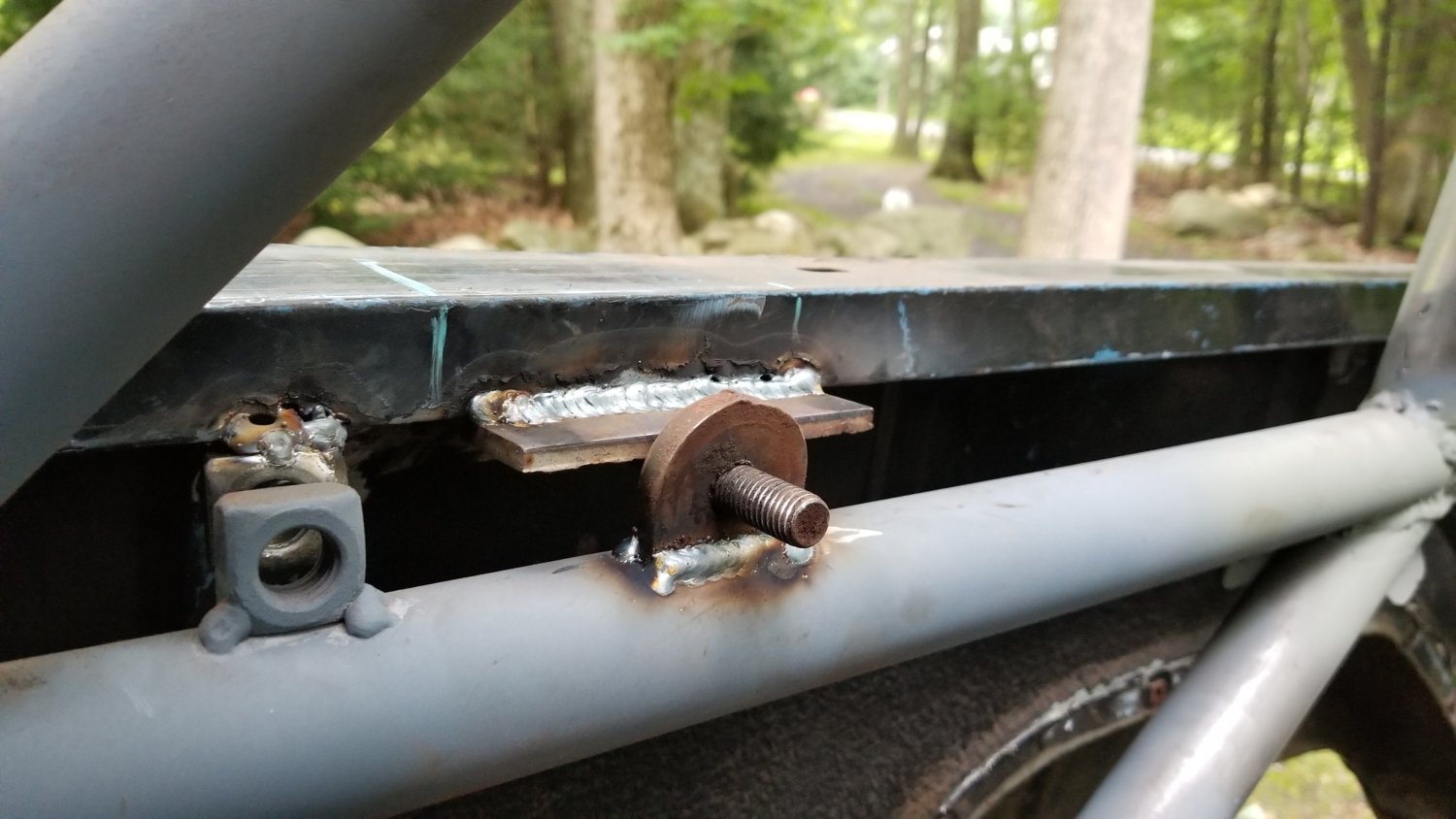

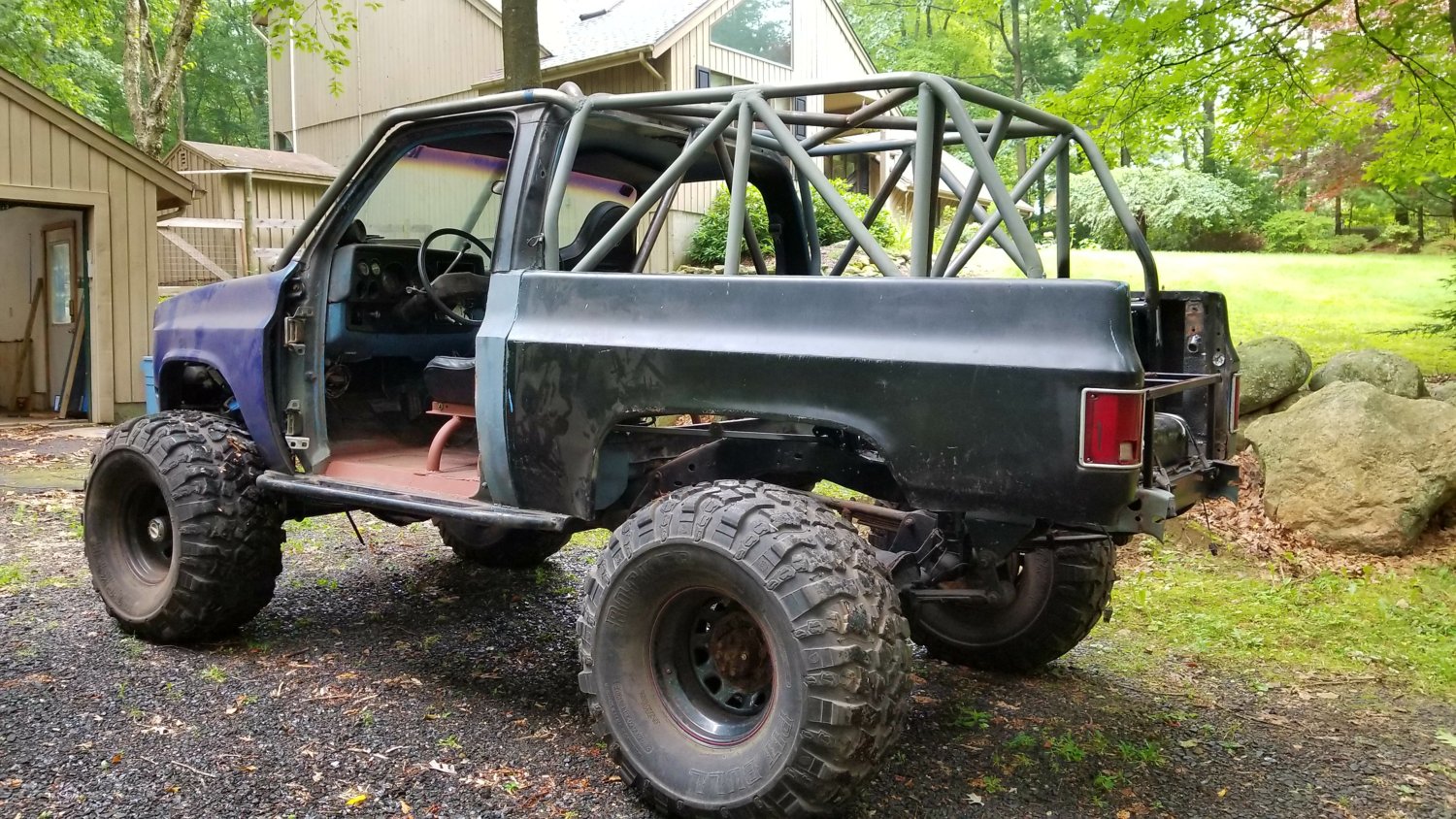

So today I ended up brainstorming for a while. I want bedsides to fit back on , but come off quickly when needed (while wheelin) then go back on when not. I ended up welding metal plates to the inside of the bedsides, welding a 9/16ths bolt to those as studs then welded a tab onto my cage. I have 3 along the top of the beside and then one down near the tailgate/frame area.
Pretty happy with this! Now I want to really add an engine cage and do the same thing with the front fenders.
