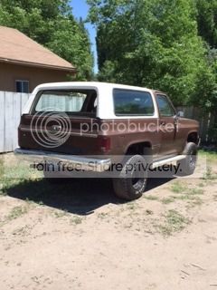

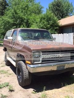

I bought my stepside thinking that 3 of us could fit in it and we needed a truck to haul stuff, well we never hauled anything in it because it could not go down the freeway anywhere near comfortable and with the floor shifter it was not a comfortable ride. the amount of work it needed and the time and money was just way to much and still not be able to fit us all. towards the end of this year I will be buying a new vehicle but will not want to abuse it off road so I started looking for something that would fit what I was looking for. I found this 1988 blazer for sale on a local Facebook sale page and he was looking to trade for a pickup so we made the deal yesterday.
the guy I got it from bought it from an old guy who just had it sitting in his field. the guy I got it from changed the clutch and stuff, got it up and running and then wrecked his pickup, so he needed a truck.
so the details.
1988 K5
78,000 original miles (and probably true since it hasn't been licensed since 2003)
TBI 350
SM 465 manual trans
NP241 (im guessing, haven't crawled under it yet)
3.73 gear ratio
3-4" lift (blocks in rear, will be changing to shackle flip)
33x12.50x15 tires
new clutch and slave cylinder
new 2.5" exhaust

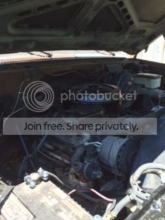

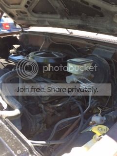

title and plates are all done now, drove it into work after a can of seafoam and some fresh gas. did find a couple issues with it, passenger exhaust manifold is cracked, fuel gauge doesn't work right, and the coolant temp isn't working.
a co-worker thinks he has a manifold I can have and a temp gauge and I am guessing the fuel gauge is a ground issue.

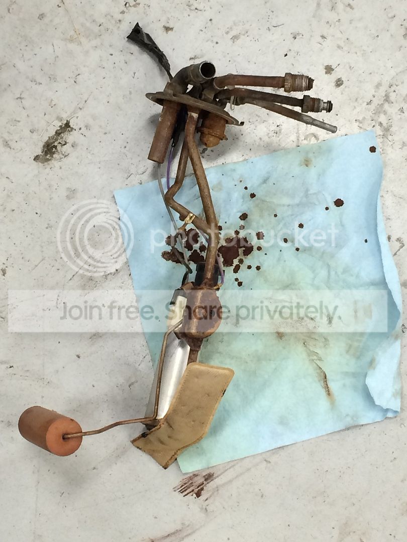

I need to drop and clean the tank, it started cutting out the other day then would run fine. Changed the fuel filter tonight and it was brown coming out of it :doah: runs 100 times better, probably gonna have to keep a couple spare filters till I get it cleaned out.
Also while I was under there I checked the tag and it is a NP208

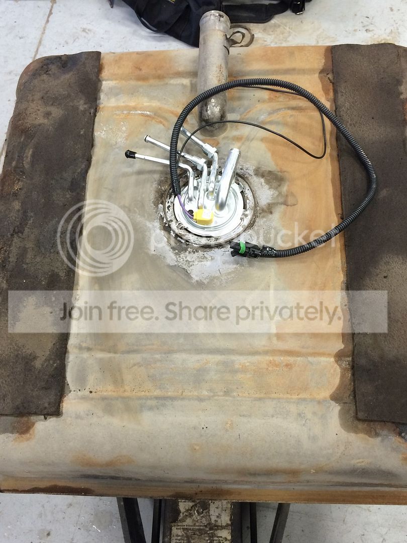

finally got around to dropping the tank and changing the sending unit/pump. I think the tank may have been replaced before, there is a "84" wrote on the top of the tank like it came from a scrap yard. so I dropped it, cleaned it, and installed the new stuff.
the dots next to it is "fuel" or atleast what used to be fuel.
the ground wire was rubbed in half on the old sending unit so now I have a working fuel gauge.
