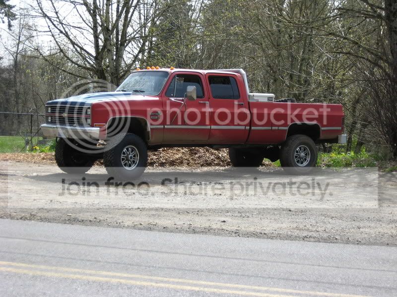

Heres mine... And let me know if you need any extra CC specific parts, Or even an extra hand with something. I get up there alot, and I have a shop full of parts.
When I bought it:
When I bought it:
Man, that is a GOOD look'n truck! I think CCs look bitch'n lifted on meats. Speaking of lift, since I went to the Rockwell idea, its going to be an 8 inch lift based on what others have said they needed for clearance. At the beginning of this thread I was originally going with a HP60 with 4" lift on 35s. I should have clarified that, my bad. I want as little lift as it will take to give adequate clearance for my minimal off road use. It will all get finalized on the mockup where everything is easy to see.
