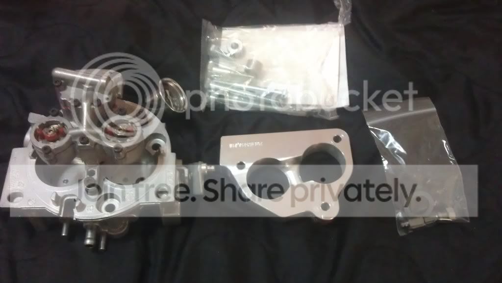

I received my TBI from RV Morse today. Mine was packaged a bit different than yours.
Can't wait to get this thing installed.

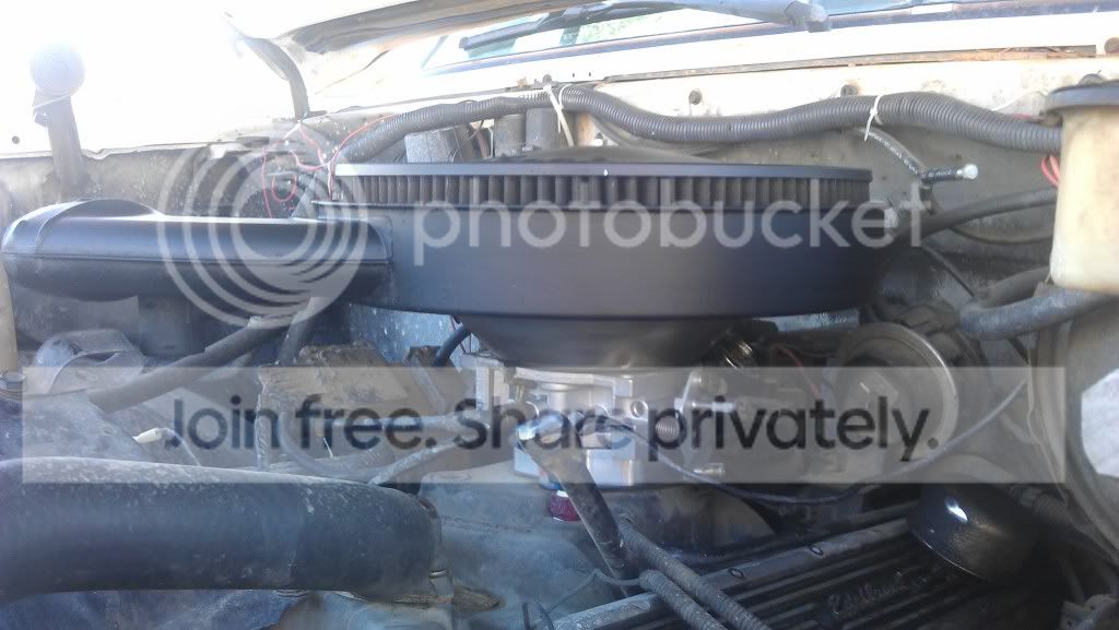

Got everything installed this morning. I have the same results as PMA. Great throttle response and low end torque. Doesn't take as much skinny pedal to get her moving and I'm running the fuel at 12 psi to see how she does, but plan to play with the psi a bit on each tank of gas and see where the best setting is for my rig.
I'm very happy with it. Because the PO had installed a TB spacer, I didn't have any issues with the throttle linkage bracket. For the coil, I just unbolted it from the throttle linkage and rotated it to clear the fuel lines.
