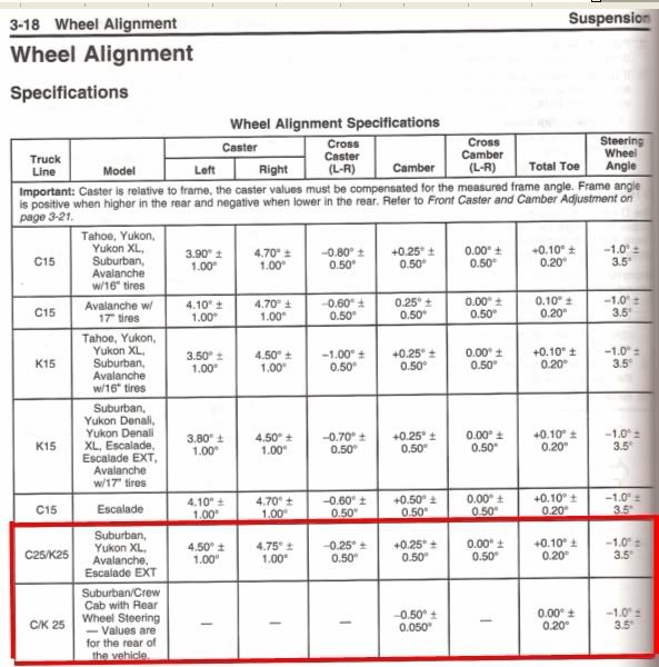

Post up the readings if they gave them to you. I've got the specs at work as we just did my 91's toe adjustment Monday. If the shop is not willing to give you the readings be very skeptical. Ask for a print from their alignment machine. If they are unwilling to share, pay them for checking it and pull the truck. This is a pretty easy bs job that some less than ethical shops can play. They will tell you the settings are way out (when they may not be) and then say they need extra money for the kit to install to allow for the correct alignment. They don't actually do anything except set the toe and give it back to you.

I'll post up a pic from our alignment machine from mine this week for an example.
