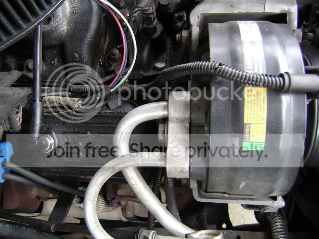

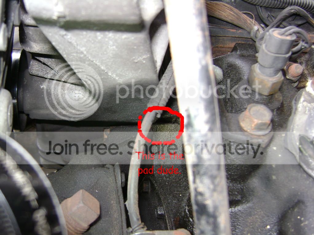

A couple pics to help. They're from my '91 'Burb.
Look under here.
Looking from the drivers side.

drink the dam water you horse :haha:
lots of times can be covered in grease. and if no serp belt then undo top bolt on alt and loosen lower. drop belt and then swing alt to the pass side way past the bracket. it will be right in front of you. :popcorn:
