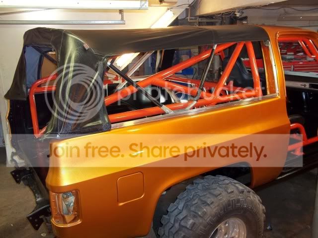

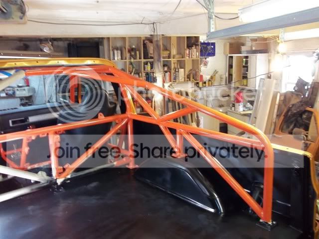

your talking about a swing-down, as opposed to a swing-out, bumper... fair amount of them have been built, it's the plan I'm taking with the K5... here's one, iirc Stompers......
mine will be different from everyone elses cuz I'm gonna run the stinger bar on the other side of the tire, next to the pickup tailgate.. with pinned bars over to the upper C-pillar corners of my cage..
gonna have one of my canvas guys notch up the isenglass back window on my softtop...

Rob's is still my fave all time cage... I have all those pics in a folder...
Diddo, IMHO this is the best cage on this site...:bow:
