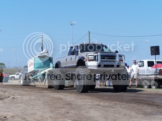

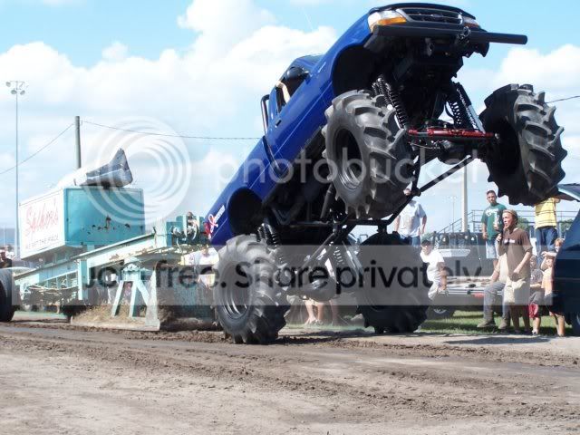

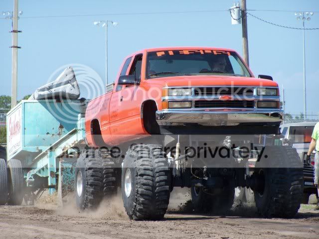

here are some trucks with rockwells......
