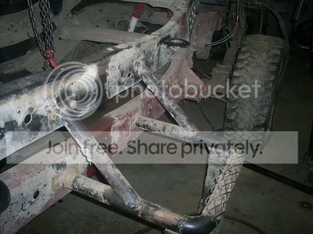

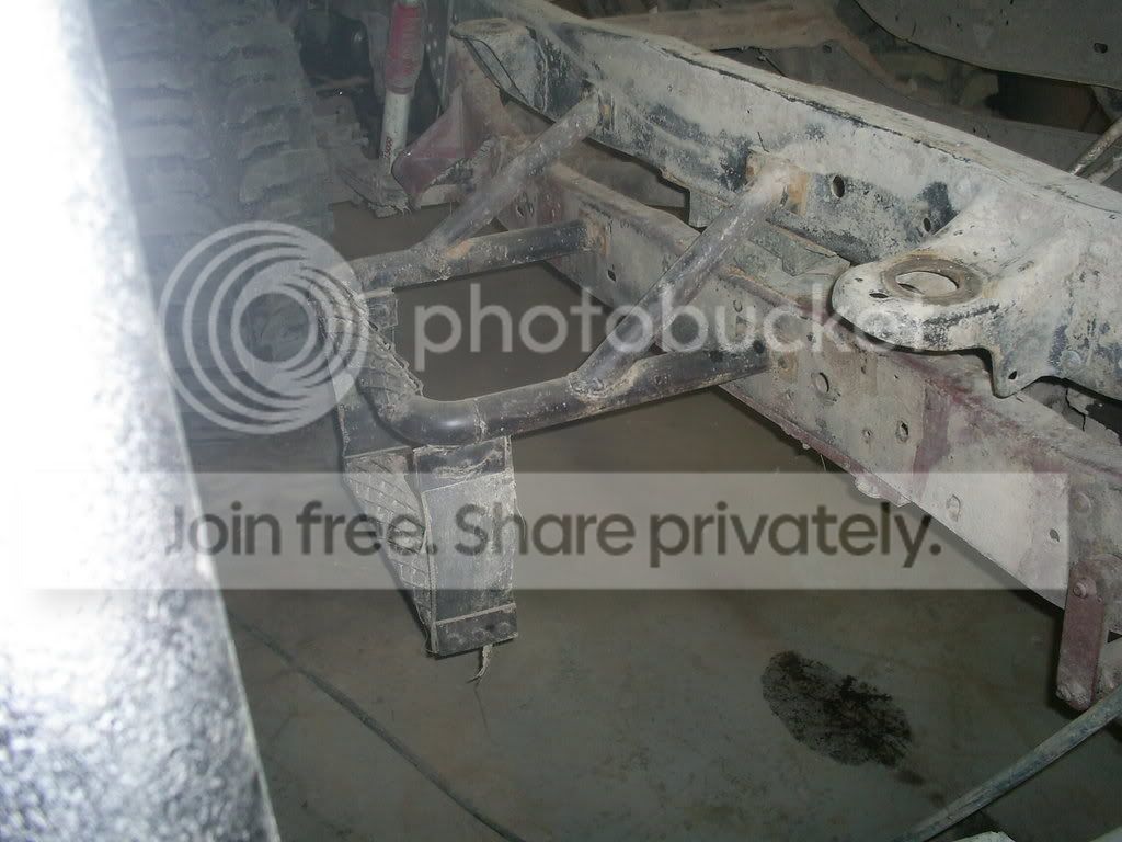

I'm "that guy with the stacked frames" I stopped caring what other "experts" said about it. its strong, very strong. I didn't weld anything I used 1/4 x 6 plates at various lengths and bolted it together. 12 3/8 grade 8 bolts per connection 1 connection near each spring hanger. I've run it for years, no frame related breakage... ever. I stripped all the body mounts off the lower frame and all the suspension mounts off the upper frame. it adds maybe 200 pounds to the blazer. last year I added a tilt nose off of our retired municipal garbage truck, When I did that I no longer needed front body mounts so I trimmed off the upper frame near the front cab mounts. now I run 44" boggers my drivelines see 4" of lift. all my drivetrain is in the lower frame my CG is damn low for running 44s. most body lifts are max 3" I had that in my first 4x4 (a 3/4 ton pickup) it was floppy I hated it. The body on my blazer is solidly mounted with factory mounts to the upper frame. I have a 4" spring lift, I don't even have the shackles flipped. Now I live up north in the land of deep snow so I don't wheel year round I take advantage of the winter months to rebuild my junk every winter. At the moment I have the body on the floor and i'm installing a doubler and a few other custom touches. there is nothing wrong with stacking frames if you take the time to figure out where you are going with it. I agree it's probably not a great setup for rockcrawling but I have few rocks in my area. I'll look for some now that I have a doubler. i'll add a few pics. I have some old 33s on it to roll around the shop on it.
