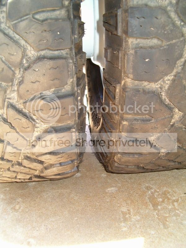

I have 1.5" spacers with the hubcentric center, they work great but were pricey....quality is what this guys pieces are about though.
I have Goodyear Duratracs 265/75's they have a 10.5 section width, and 31.7 overall height. These 1.5" spacers ended up giving me .75" between the tires on the ground with 45# in each tire, no bedload.
