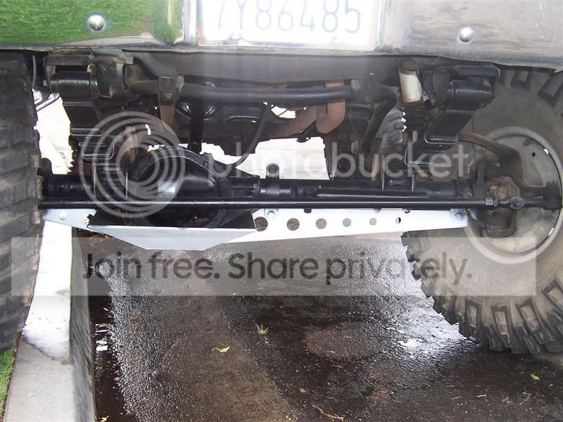

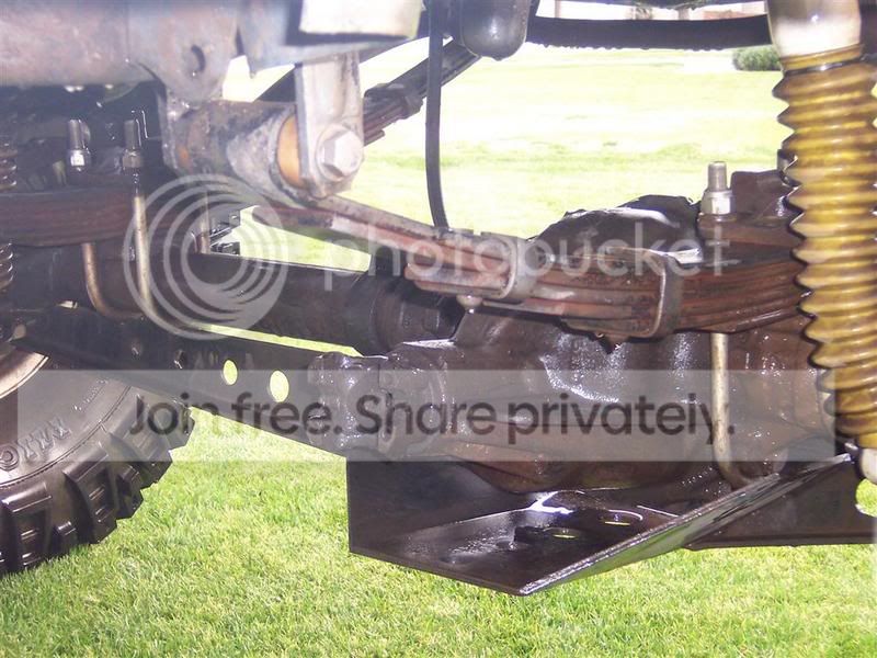

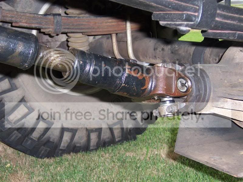

I've got the Rhino Truss/skid combo on my 8.5" 10b front axle and I like it. One problem w/ the setup like this on the front axle though is if you really (and I mean really) hit something hard they have been known to slide around (they only clamp onto your axle tubes) and have the back of the skid smash into your u joint and cause a bunch o' problems.
If you welded it onto the axle tube in a few places I think you would be fine, I haven't but then again I won't ever see rocks....

Here ya' go...
-Avery
