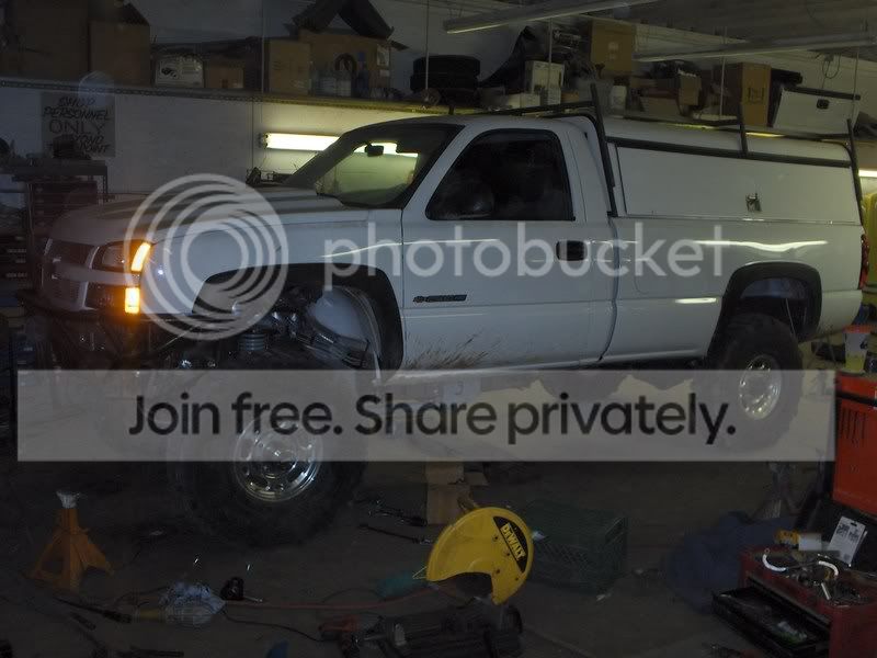

im literaly doing this swap right now, I however decided not to use a newer dodge axel do to the unit bearings..yuck..
I am using the cage arms, but decided to go with ballistic fabrication for the rest of my brackets. I should be done this weekend.

supersized75k5: Pic's please??
