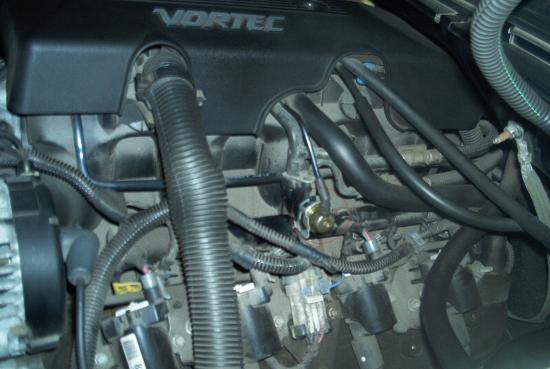

check your fuel pressure regulator, if you pull the vacum line of and gas comes out of the line it is bad here is a pic of where it is located its the round gold peice on the fuel rail with vacum line
ive got a 00 gmc z71 with 5.3 and mine started to act weird wouldn't idle very good and hard to start and the fuel pressure regulator was bad
my fuel pressure regulator went bad also. it would be hard to start because the bad regulator was letting the engine flood when shut off. it was $25 and no tools to change. there is just a clip that holds it in. if it has not been changed yet you might as well do it. It was a real common problem in our shop.
thanks.. never thought of that.. i am gonna check that out monday, if theres no gas coming out of it, i wouldnt care im still replacing it,.. but im defentily am gonna check it out.. thanks again! ill keep u post on monday night to see how it is if napa has the part in stock...:rolleyes:
replaced the fuel pressure regulator.. no luck.. well im takin a break from this now, its driveable for now.. well me n my dad went to pick up the saturn today after it sat at the shop for 5 months. no luck. i drove it home, loses power at 3,500 rpms, and wont go over that, nothing works no speedo no rpm tach, no nothing, took it to my other friends shop with a computer test.. well the best thing we found is, maybe 20 different codes appears and i aint replacing everything. the last code say fuel pump disabled, anti theift disabled, everything not working right.. so u know the answer?? A 62000 mile car's brain(computer) is FRIED or shorted out.. so.. tomorrow kevin, the guy that has my saturn, say he'll call saturn dealer and see if theres anything like this before. so i hope something comes up cause this sucks big time! and 1 year left of payment.. grrrr..:mad: this is a 2001 Saturn L200, 2.2 ecotech engine.. any of u guys hear same thing happens to same car in the past??:confused:
