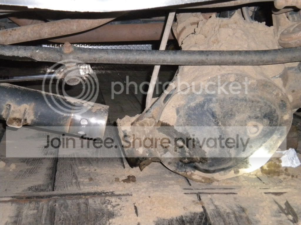

Hey, I just so happen to know this guy... and I heard it was an 06' instead of an 05'. I also happen to have pics finally loaded of the issue, see below. Thanks for always looking out for me Brett!
Also, I know it isn't a GM... but these components are beefy! The tie rod itself is close to 3" diameter solid bar. I wish I had a cool story to go with the carnage, but I was literally just backing into the garage and SNAP!

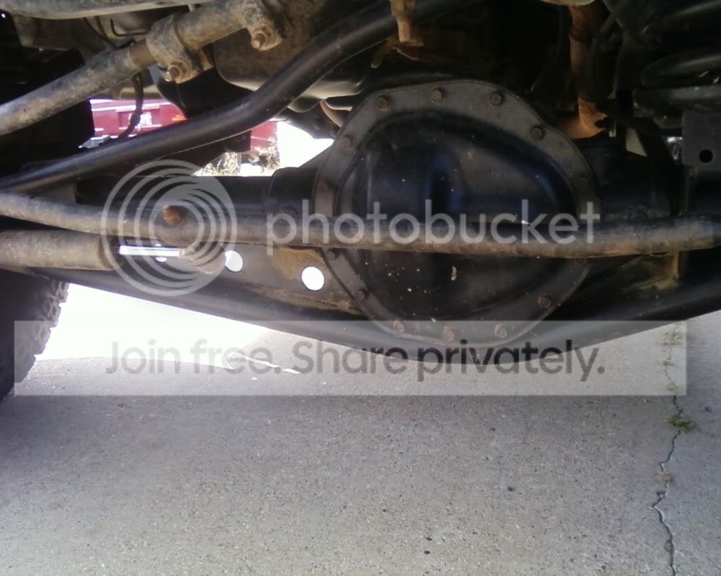

This is what it looked like when it was originally was installed:

When they replaced the linkage under the service bulletin, they should have also replaced the pitman arm with 68039930AA... not that it affects this situation. The arm that goes with the new (08.5+) linkage mounts the draglink end from the bottom side of the pitman arm with the nut on top, it also has some angle to it so the joint itself is not operating at an angle at ride height. While this will help keep that one particular joint alive longer, I pulled measurements with either arm, and the geometry is actually better running with the old style pitman arm (like you have.)
The only reason that I bring this up is that if you point out to the dealer that they skipped this step and your linkage failed, they may want to cover their tracks and give you some new parts. Or not, but it's worth bringing to their attention.
As far as cost, you should be able to get the linkage 52122362AF through the dealer for less than $400 after tax, but for some reason, mine also charged me a $75 core.
better look at the pics again. its got the new arm on it. no rust on the arm and the pitman shaft has some surface rust on it.
I stand corrected, I did see that the arm had been replaced, but I swore that the new one mounted the draglink upside down on the pitman arm. I guess I was thinking of the aftermarket arms that look the same with the taper on the other side like the superlift, tuff country, skyjacker arms.
