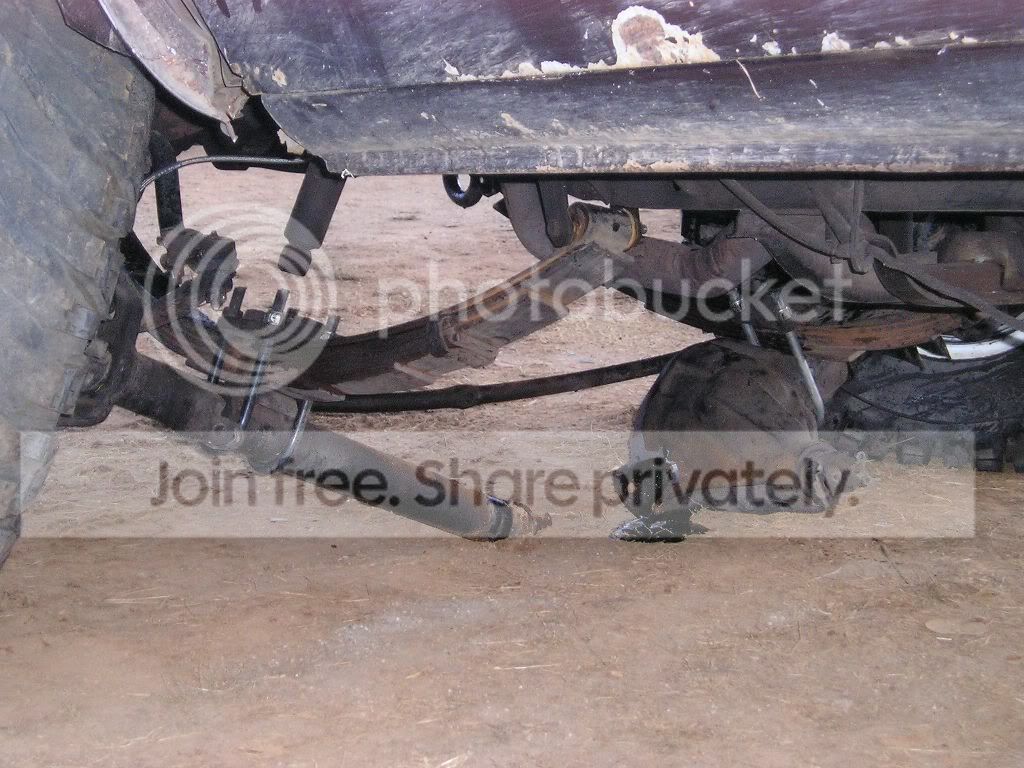

Dunno if you or anyone else is still curious, but you can kinda see the factory 465/203 adapter in these pics of my old rig-
:wink1:
TruckNutzDude: They are gonna call me back with an exact quote.
KidJethro: Thanks for the pics! Yep, I am going with that adapter, my stock one was way long at 8&3/8", the shorter adapter will give me 4" more rear driveshaft length. I really like the looks of yours, turned out slick! What did you end up doing for a crossmember set up?

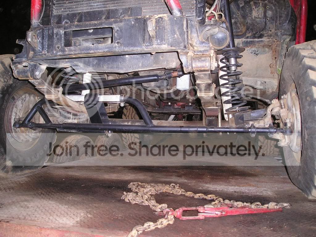

x-members-
This pic was before the driveline showed up from High Angle. I had to really re-work the front x-member to make it work with the driveshaft-
This one is what I had to do to make the thing clear the driveshaft-

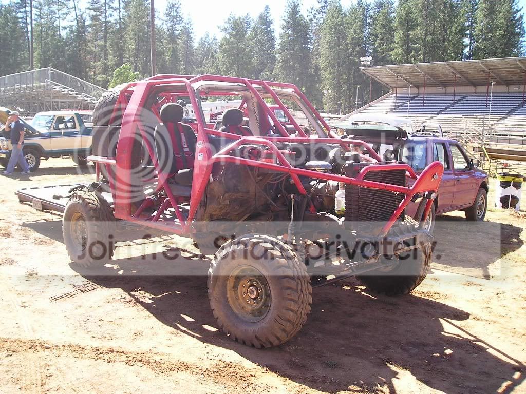

Since my doubler adapter was an older Gen1 ORD setup, it used a factor 10 spline 465/205 adapter bolted to the back of the adapter plate. My front drive shaft was looooong. And 32 spline is over rated I think...My entire setup was 10 spline from front to back, minus the 30 spline front output of the 205. My rig was a heavy bitch with a goodwrench 350 small block, 42" tsl's, 5.13's, detriot in the 60 and welded 14b. I never broke a thing. And I ran all the tough trails at the Hammers. The key is to not drive like a jack ass. Nothing is stronger than stupid. Even 32 spline stuff.
This is the rig- may she rest in peace!
