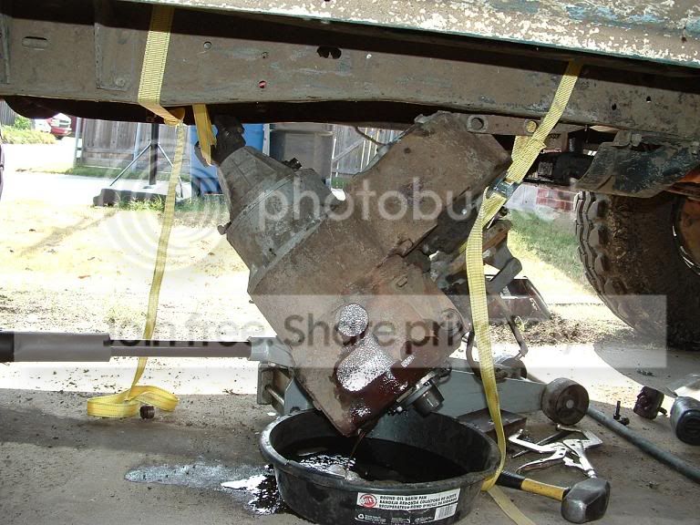

just leave the x member in and before you take out the bolts, prop it up like the pic... remember you will have to do both sides this way... :D
That would have worked also. The two crossmembers and skid plate are factory and not home brewed. I used to have that same set-up on my 76 blazer.
strung el cheapo straps under the front and rear output. unbolted and shoved off. didn't hit the ground either lol.
