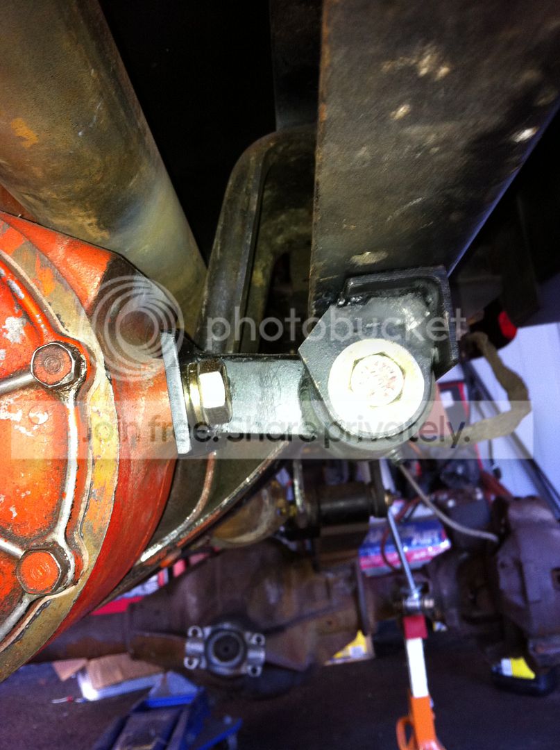

Here's the one I made for mine. Used Kert's fabricator's set and a few pieces of scrap I had. I like it better than stock, that's for sure.
Thats awesome. So no one really sells the side mount style then? That dosent look too awfuly hard to build , looks practical, nice job.Aloha:thumb:
Thank you sir! It wasn't hard at all, just took a little time and some welding wire. I had the stuff laying around to make it and was never fond of the factory style torque mount so I figured I'd give it a go.

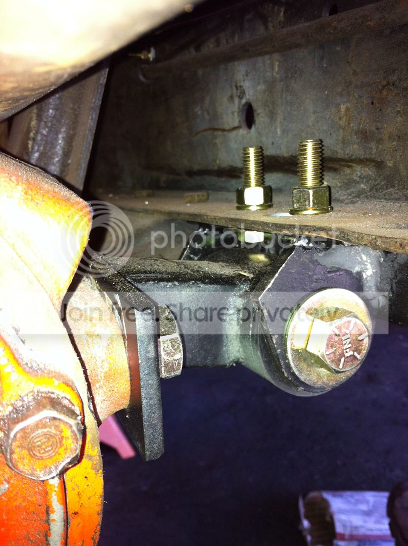

i still have the stock one one.sorry no pics.id rather have it on than nothing at all.it will keep the lateral movement down of the drivetrain pretty well if the bushings are good.a simple one can be made or bought fairly easy as the other guys have done.

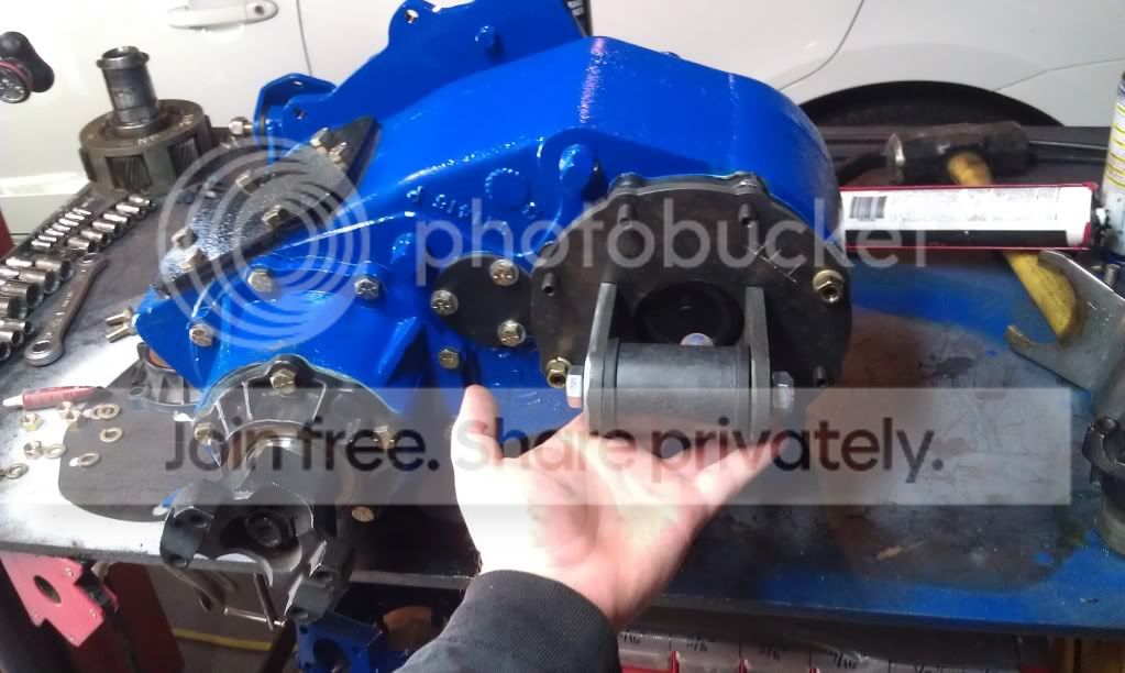

Here is something I put together...
The piece on the right bolts on where your talking about. It all attaches to a crossmember below the Tcase.
