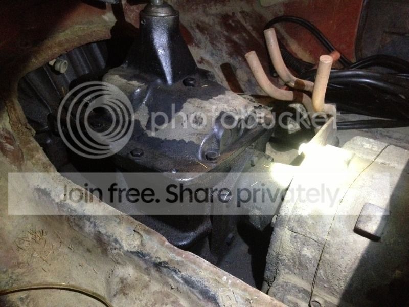

not sure if this goes here but ill try anyways! I have a junky old 4 speed with a 205\203 cases and switching to auto. Question is i can get a 1984 chevy turbo 400 and 208 tcase, what spline will they be?? and im not sure what spline im running either so kinda in a bind. Im going to have to drop mine out to see.

th400 factory was 32 spline .
and if round pattern on the 4 speed it would be 32 spline also .
if figure 8 pattern on old 4 speed would be 10 spline.
hope this helps.

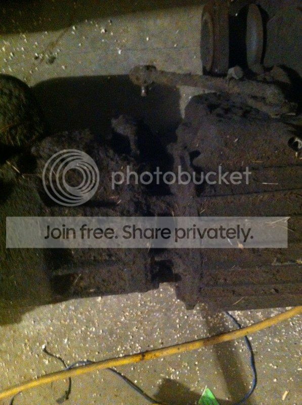

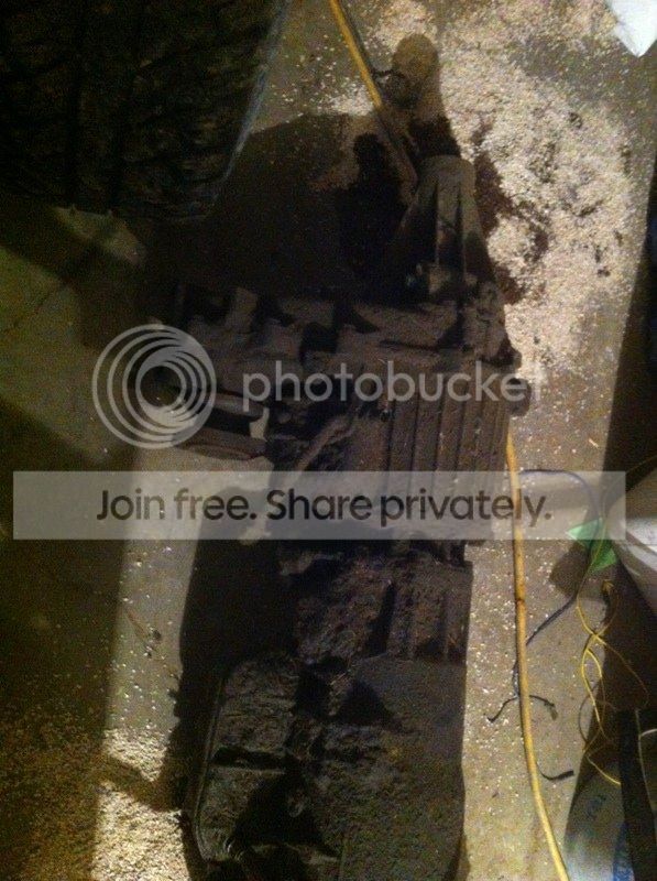

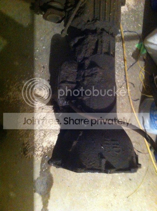

well here is the 208 and turbo 400. its pictures that were sent to me, yea alittle dirty :|
he said he counted 6 bolts holding the trans to the adapter
