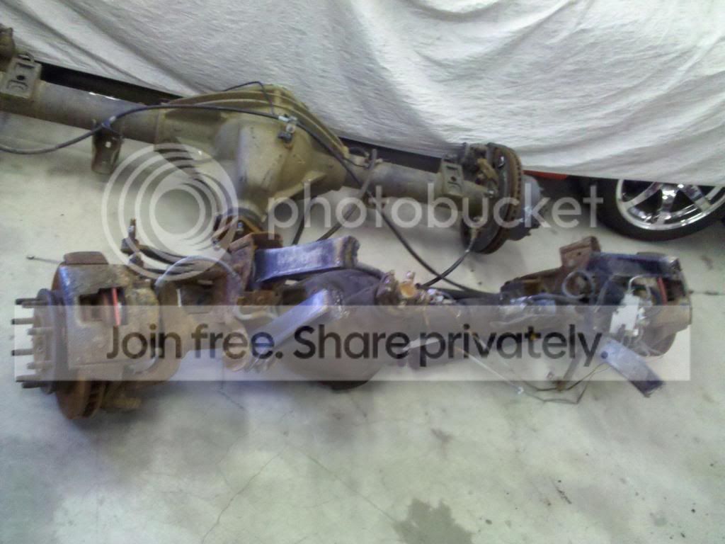

I picked up a dodge D60 so Im in luck there. I am considering running the 2wd tranny and a divorced t-case right behind it. I have a 2000 4*4 pick-up, the 2002 2*4 burb and the 91' 4*4 burb to compare. This weekend I will be making plans as to whats the easiest or whats even feasible.

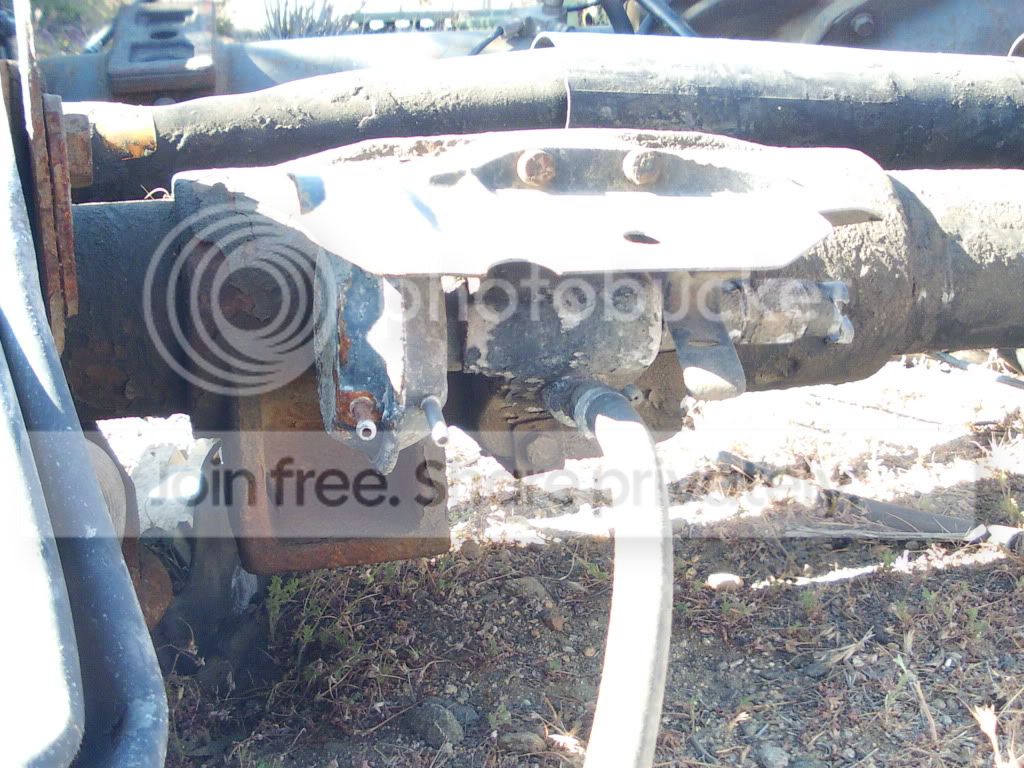

Ok so here is the D60.
So whats the selector here?
That's the engagement dohickey that slides a little coupler between the two axle shafts. Known for issues and being a weak area. Since those don't have selectable hubs that's how they keep the whole diff from spinning all the time. 01-current they just got rid of it because the system was so problematic.

Thank you both for the good info. I know it ain't the best axle in the world but its gota be better than a stock 10blt. I got the front 60 and a D70 with disc for $900. Not a bad deal to me.

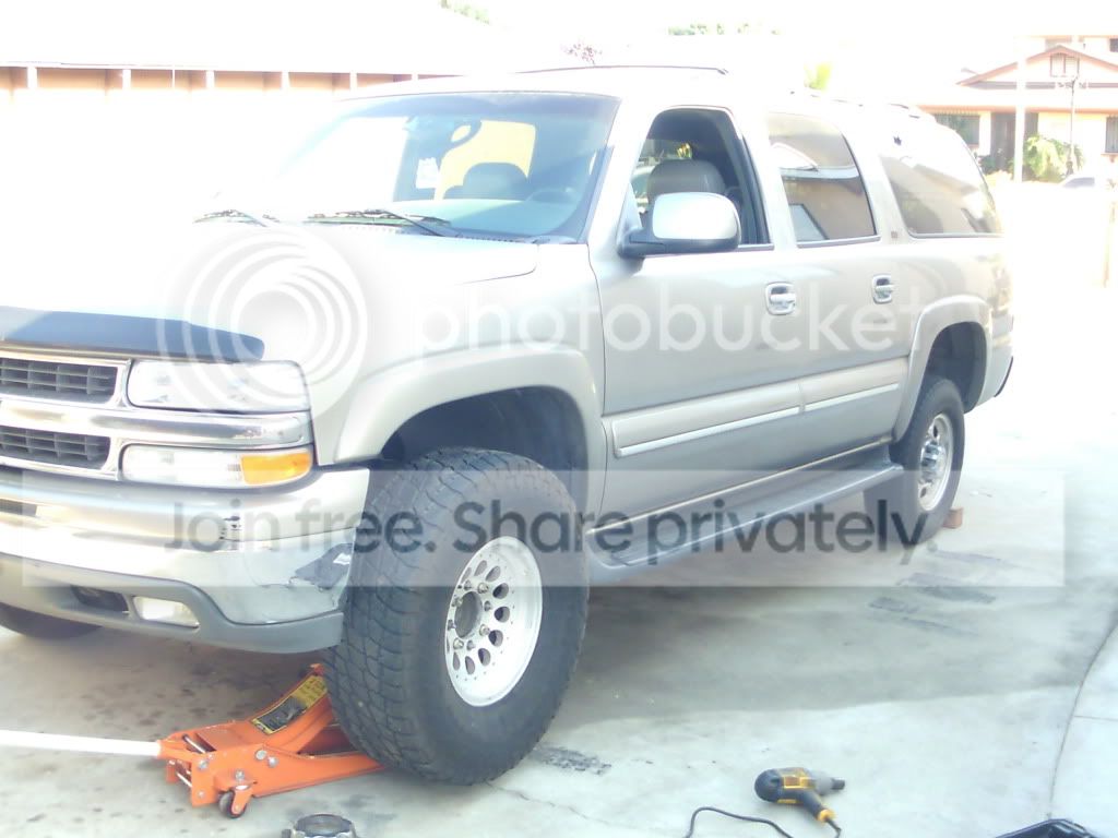

I have set a plan to have the stock four link junk cut off and the axle prepped for install within two weeks. In the mean time I threw my 33's on it for a wanta be look:)
