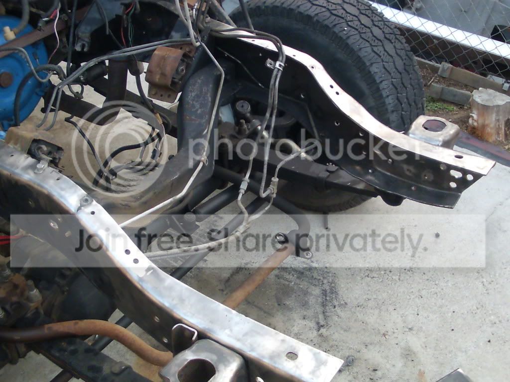

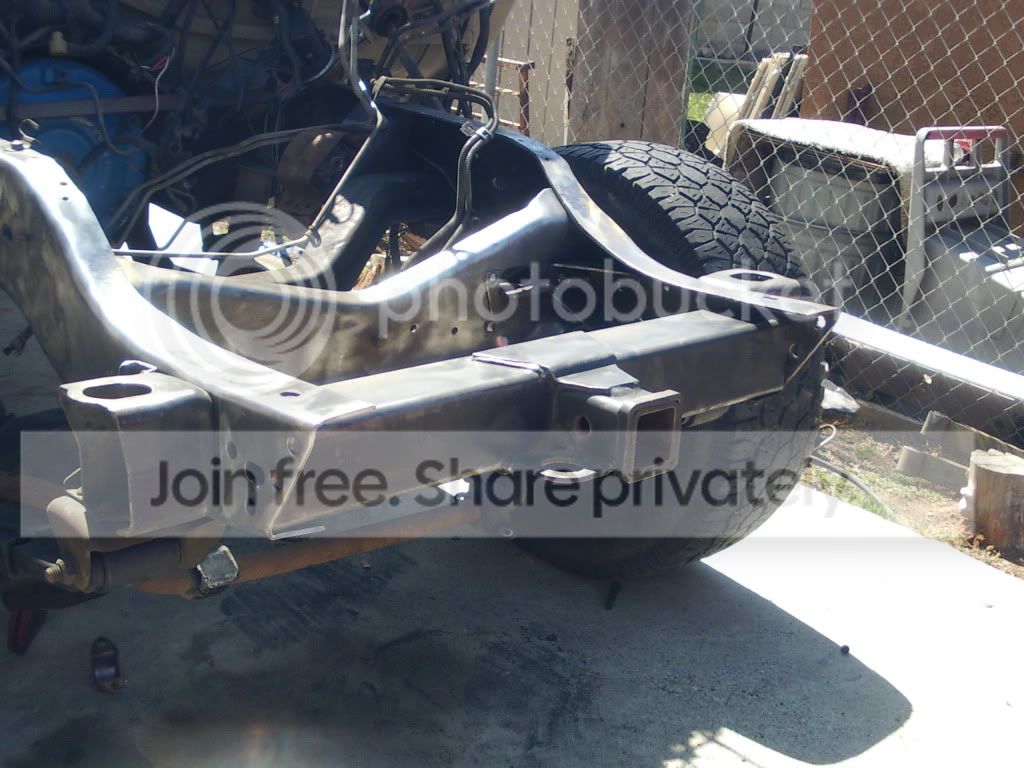

So I finally got started on the dang truck! My wife has been pestering me to paint the truck all one color so here we go....O yeah, I wanted a panel truck too:weld:
I'm intriqued to see how this turns out, I can't say that I've ever seen a panel-burb before...
I have but the newest one I've ever seen was 67-72 vintage and had three doors up front.
