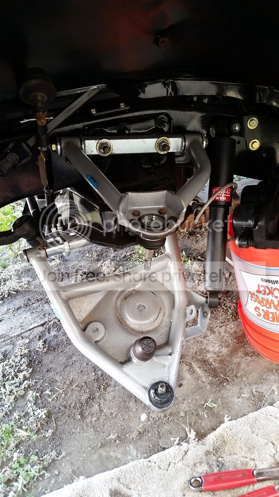

I'm replacing the lower ball joint on my '68. Its really hard to turn the spindle while only bolted to the lower bj. So CPP supplied me with crap from the start.
The upper bj is smoother with the spindle attached, I can at least turn it with little effort, but it's not super super easy. When I push the shaft back and forth with my hand, it makes a grinding feeling, like the inside is gauged. Not sure if they just feel like that anyway or if they should be super smooth like a tierod end.

Managed to get one done last night before laziness crept in. Wow, what a difference. The new lower Moog is much easier to move around by hand. I'm sure the upper will be nicer too. Part numbers are funny. Old one = OSK6136 new one = K6136 The old one has no branding but then again the Mood only says "problem solver" on it. Dunno, finally excited to drive the truck again. Here's hoping the brakes don't still squeal.
