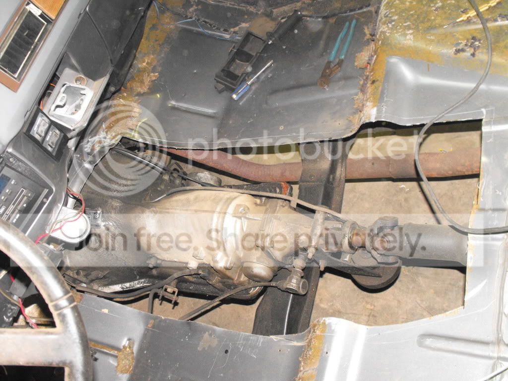

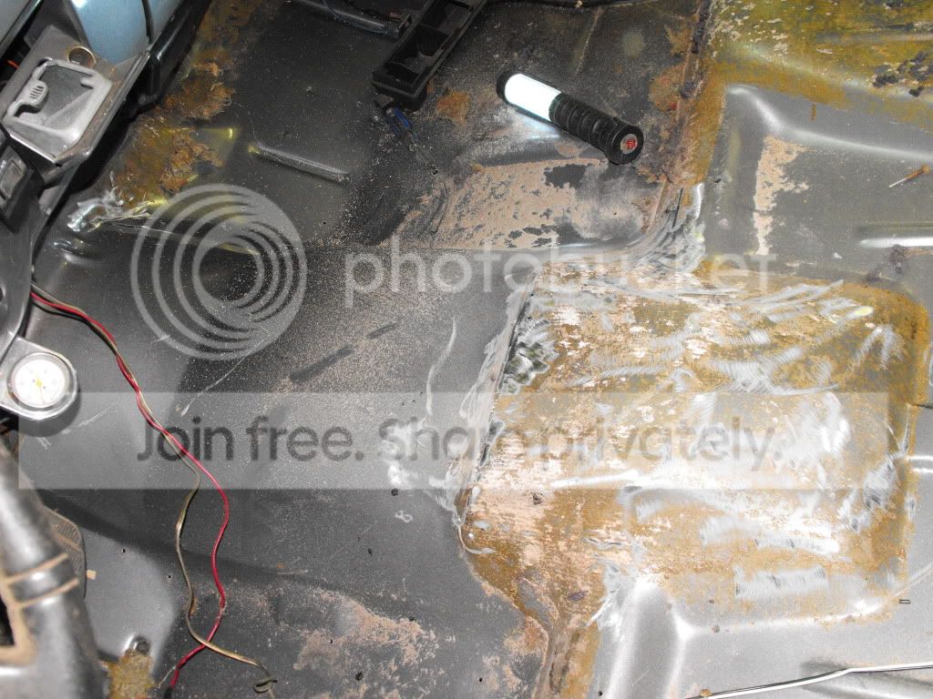

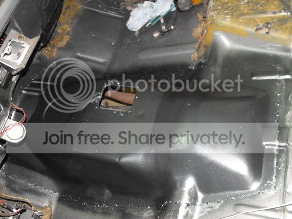

I am in the process of doing this. Putting a 89 2wd on a 88 4wd frame. I had to cut the trans tunnel out of the 4wd and put it in the 2wd but that only took about and hour. It would be easiest to find a junker 4x4 and use the frame, hell my buddy bought the 88 for $800 and the interior was the nicest I have seen.
I still have to seam seal it but you get the idea.
