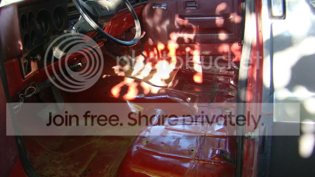

All 1989-1991 trucks have the 4x4 hump?
Martin
My 1991 R3500 does but its a one piece floor pan (not removable)

It was my understanding that the 2wd hump only clears the 4x4 stuff if it was a standard transmission but I don't know if that changes for different years of the trucks. I have an '89 that was a standard transmission equipped truck.
My 1991 was a factory auto and it had the taller trans tunnel. I think (not 100%) that the 89-91's all have the taller tunnel.

Is that a 89-91? If so the trans hump should be a "tall" one and should clear. I wish I could be more help but I went the easy way with a chassis swap.
I was always confused with the hump thing as well. I ended up cutting one out of a spare truck just in case.
I ended up NOT needing it, I had plenty of room putting the 205 in.
My truck is an 88 and has the full low pan, Not bolt on.
