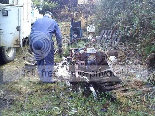

So I picked up a '72 Blazer frame awhile back complete with SM465 & NP205 t-case. I mostly bought it for T-case - and Makovai needs a new frame for his Blazer.
It also has a 350 with ram horn manifolds, Edelbrock intake, decent looking (at one time) plug wires, etc... Chrome (at one point) Chevrolet valve covers, etc - In other words - somebody put some $$ in this engine at some point.
This engine has sat out in the weather for indeterminate time with no carb and no cover over intake holes - also distributor was not in it (i.e. direct path into intake runners & down into oil pan for rain water)
Setup is from Southern Oregon coast - and with openings and amount of rain it is safe to assume water is throughout engine.
I don't really need a 350 right now - but will probably hang onto it as a rebuilder.
What would you guys do with it? Tear it down for storage to prevent further problems/learn what I got? Leave it outside covered? Scrap it? or?
Any advice? :dunno::dunno:
That is picture of frame below - (with a nice view of my Uncle as well)
Tear it down making sure to keep it numbered in original position of components and clean it up.

Yeah i mean you dont have to magnaflux it or anything just take it and get it disassembled and wiper the goo out of it. If it looks too beat up scrap it. Hot tanking would be best but would also involve money.

I'd drain everything out of it, then pour in about 5 gallons of gear lube...including copious amounts into intake ports, through spark plug holes etc. Then seal it up and put it aside. At least then it might come apart OK later if you decide to rebuild it.

Rene is almost correct. Except he forgot about the no cost part. Do what he says, but use used oil from your next few oil changes.
It will protect as well as gear oil, probably soak into the threads a little better, and does not cost anything.

Right. It doesn't cost anything but an hour of your time to tear it down. At least then you have an idea whether it's any good, and what you'll need to save up for.

It might be worth trying to get that engine started while its still in that frame--drain the oil,put new oil in (assuming its not seized up) and put in the missing parts (dizzy,intake,etc) and see if it'll crank over by hand first to ensure no valves are stuck shut..it might surprise you!...if it runs I'd let it run awhile then fill it with drain oil right to the top of the valve covers before you stash it away under cover so it wont rust up any worse...
