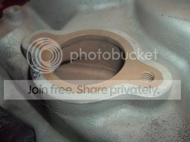

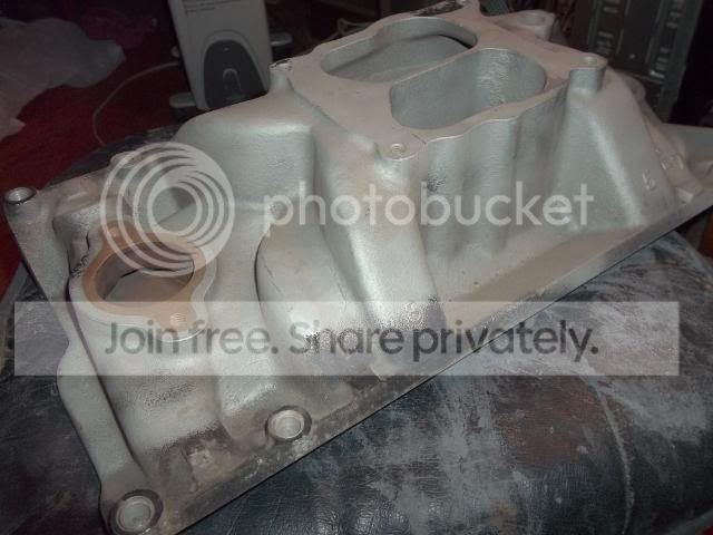

the correct intake is bronze lined on the inside if i recall correctly.
:whistle:
:haha:
they don't make em much that way any more.. haven't seen a factory released one in awhile... expensive as heck....
other than this one sitting in my living room, the last ones I played with was putting a new pair on a pair of HO merc 454's from the mid, late 80's.. they where $1200 a piece! :eek1: :doah:
