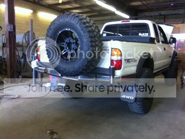

I think your traditional swing-away carrier on an aftermarket bumper is gonna be your best bet.

Looks like the tiregate folks make a reciever mount for up to 38" tire.
http://www.tiregate.com/shop/hitch2tire-carrier-no-tow/
I'm thinking about making something similar but using a hitch extender and making it hinged.
Or, maybe a vertical upright bed mount near the back of the bed. It would still take up space, just less. I'm just not sure there is enough room between the fender well and tailgate.
We just need to get some measurements and make a few like tiregate till we all win the lottery and can afford the nice custom bumpers!

It's a long bed, but the toolbox is in the way. I love the Tiregate but I can't justify that kind of $. I guess I'm narrowing it down to a receiver mount or a custom bumper with a swing-out carrier.
