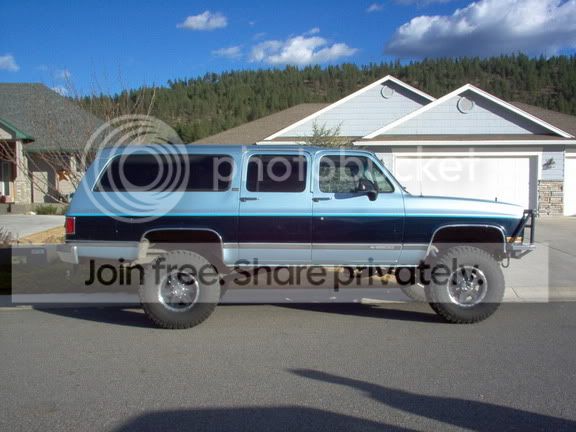

A Tuff Country lift on the other hand you would definitly need to trim the fenders some, Here are some pictures of my brothers 'burban with 4" Tuff Country springs front and rear and a 1" zerorate up front, and slight fender triming (just back to the inner fender), It is also a newer model so it has a little longer front shackles as well and it still needs at least another 3-4" of fender trimming up front to fully flex it while turned.
Oh yeah and the rims are 8" wide with 4.5" backspacing.
