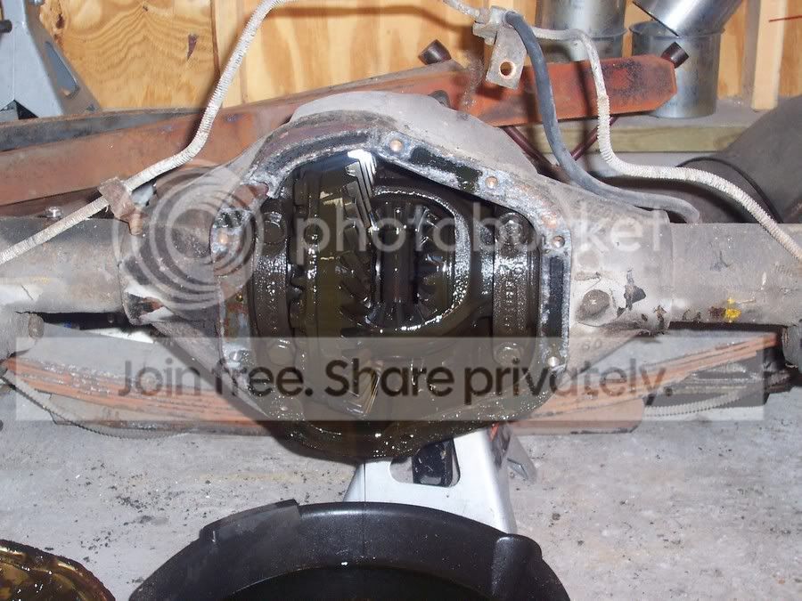

sweetk30 said:
the pics you posted are of 14sf rear.
I got one under my truck, that aint a 14sf. Plus, theres only 12 bolts on the cover, its a GM 12 bolt axle I do believe.
First of all thats a GM 12 bolt axle...Count the number of cover bolts, doesnt add up to 14 so that eliminates the 14SF Id say.
Second Dana 60 is a 9.75" ring gear so those gears you bought wouldnt fit a Dana 60 axle either. Its probably a ring gear from a 14SF which is 9.5"
sorry brain is friyed:tongue1: . long crappy week.:what: yes i have been corrected:deal: . its a 12 bolt. i bow out to the ck5 masters with this one:ignore: . i guess i am just dumb :screwy: . i will go hide in my corner now:whistle: .
p.s. hope you learned that just cause it says a # on the case dont mean its that part. do some reserch . i found the 2 pics in the tech section in less than 30 sec. :o

Grieby54 said:
There she is...
The trusty 12 bolt...3.08's are the most common gear....
You should have listened in your earlier threads...you're new bro's were tryin to help. ;)
Not a ten bolt, and yet not a 14 bolt. I don't really think they're good or bad, just ok. Mine hasn't given me any trouble, but I'm getting rid of it just cause I don't trust c-clips.
The gears came out of a 1971 C20 dana60.
You can see the "60" in the lower right corner.
Grieby54 said:
So a 12 bolt is an ok axel... not really good...but not a 10 bolt... right?
With the amount of hp's...I'd look for a 14bff...with 4.10 gears.
Go 3/4 ton or use TonyP.'s 6 lug adapters.
I broke axles...fried a couple 12b's with 3.73's in them. :crazy:
that's my .02.
Check the junk yards, they are littered with Furd D60's - and cheap too....
Some of the Furd versions have larger bearings in them than a GM equivalent.
I am glad I was slow selling you the 4.10 carrier and gears. I would have felt bad sending you something you can't use.... :waytogo:
