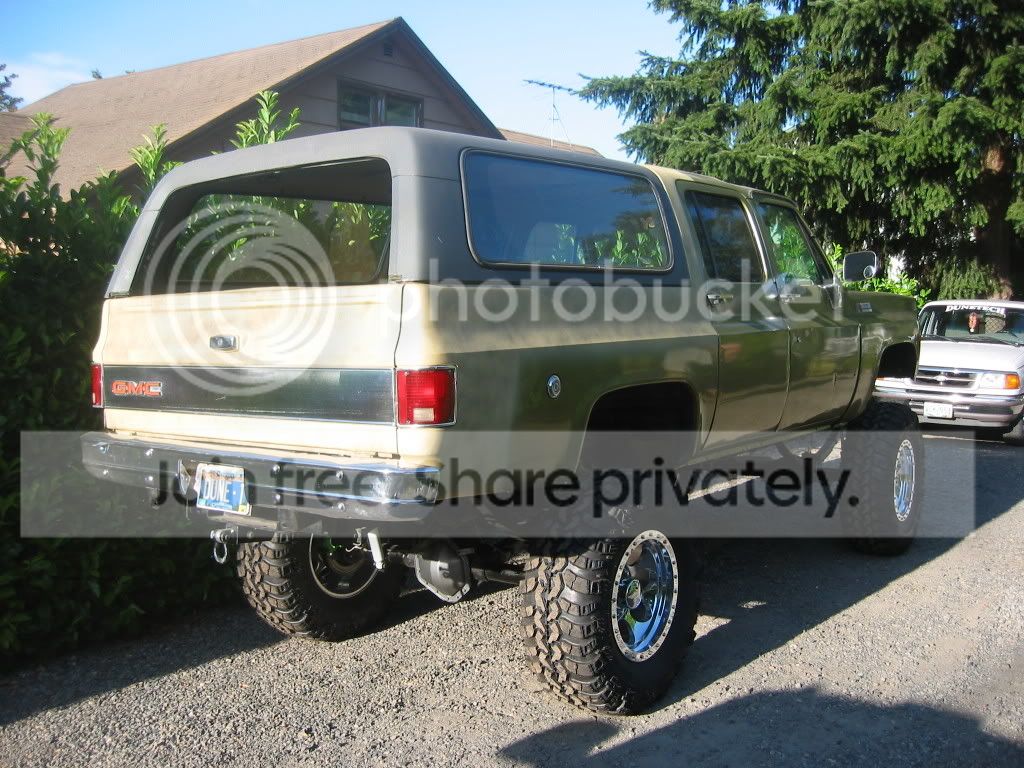

4.21 UPDATE Topless Suburban on Rocks - NARROWED Front ROCK
When is someone going to go full-bore and make a full convertible suburban? That would be sweet. I can't even really see why someone would want a half-cab K5, (while I have one) I just don't see the point. Someday it will be full vert.... soo much work and this stupid "work" thing keeps getting in my way.
That is the stock paint color that was on it - not sure what color it was - he wanted to paint it Kawasaki green - but ended up trading it...

We left the Suburban inside shell alone - and only cut the outside sheetmetal off the Blazer tub. Then simply cut the Sub inner sheetmetal down far enough until we could rest the Blazer outer sheetmetal on it at the right height.
Hope that helps...

How did you handle the tail lights......did you just remake the lip that wraps around, the bezels, that is?
I almost did this with my burb but I hated the long over hang so I hacked 22+ inches off the back . The burbs @ss doesn't hang up on rocks as much and my departure angle is alot better . I just need to cut out the back and tube it like bgreens rig and 4 link it .
