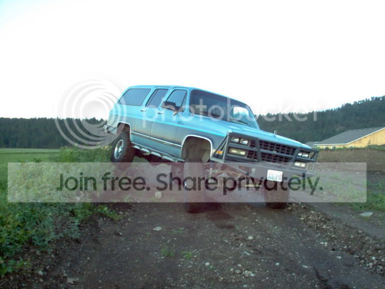

Here is mine with 4"-5" lift with 39.5 boggers and some minor finder trimming
4" procomps front springs with 1" longer shackles, 56" rear's from a 91' 1/2 ton Suburban, 4" flip and 2" longer shackles at 45* angle, 1" ORD body lift, 36 tsl/sx's

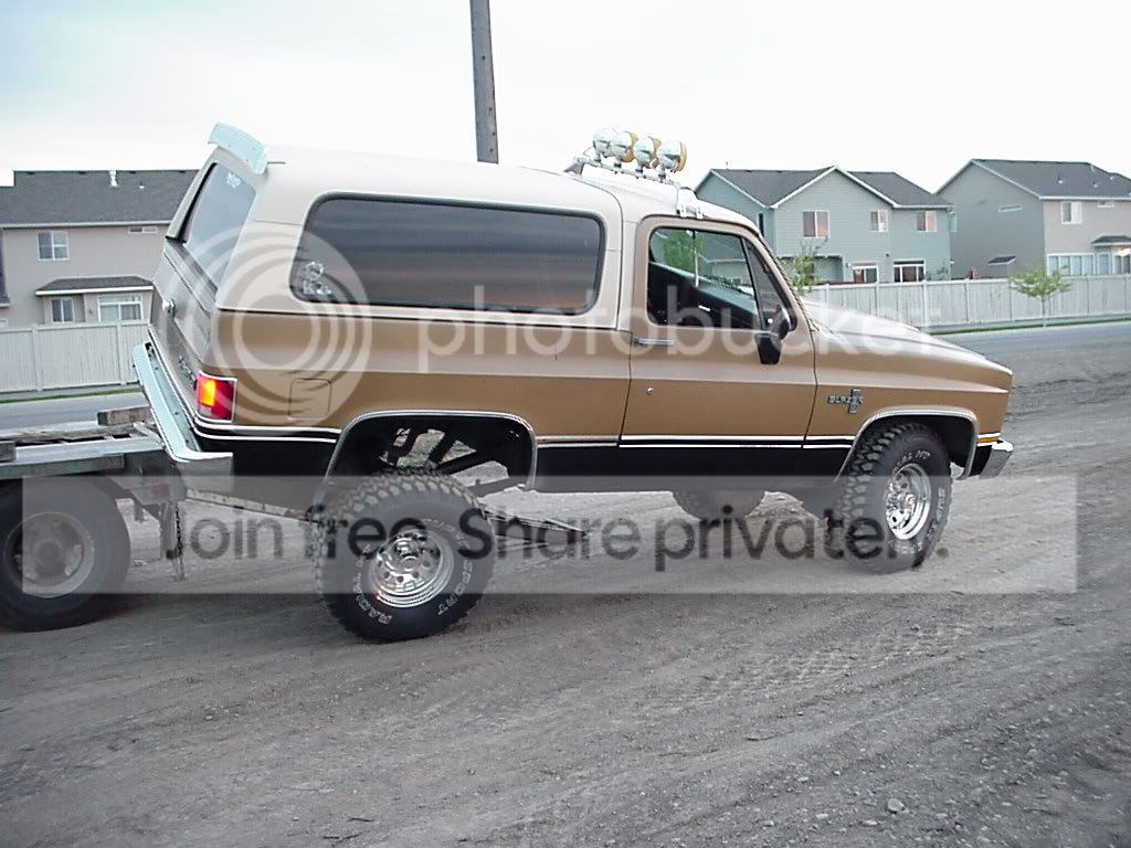

4-5" of lift (sagged 4" rancho's and 1" BL) and 40's
Rene

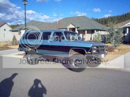

Here's mine on 4" rough country springs (front), Echobit shackle flip rear on 35x12.50's... needs a little trim but have not flexed it since I got the tires.
Here is 4" Roughcountry lift, Rear Blocks No Fender Trimming because even at full flex with the sway bar disconected the 35" tires don't rub on 8" wide rims.

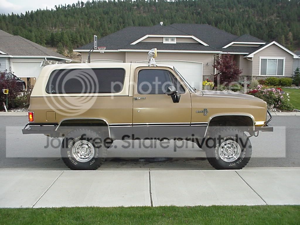

And Here is a 4"Tuff Country Lift all Spring with 1" ord zero rate in front, with 37" tires. In these pictures the fender is only trimmed back an inch or 2, it worked for light-medium wheeling if your careful, Currently the fenders are trimmed back to the sliders to allow for full flex but i don't have any pics yet.
