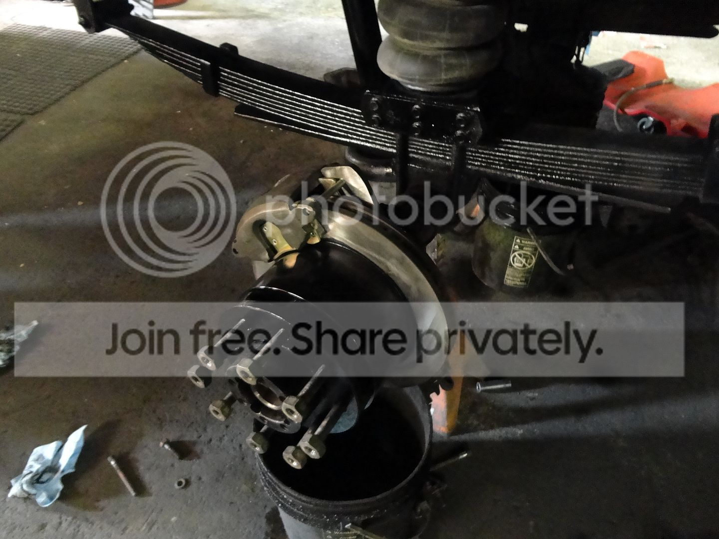

yes, that was the original thought... links, bags and shocks... tho i guess that does put the bags into that "fail factor" category... maybe a coil/bag combo would be better...
did you end up adding bags to the CC after those pics?
The bags were in the plan from the get go but didn't get them on till later.
Here's about the only shot I can find where you can see them at all.
I personally like the idea of springs and bags. Tons of people around here run them and they do a lot of towing. Between livestock trailers, job trailers, and RV trailers, they all run the same setup. Some of those RV's are so big their not even leagal is some states. Looks like a whale h*mping a guppy.
Nice thing if something goes wrong while you are towing away from home your more likely to find parts on the road and it seems like a redundant system. Bags fail you still have springs and vise-versa.

ok sweet, thanks.. that's exactly how I figured it would be... actually, would it be easy enough for you to supply the bags as well?

If not, I can certainly get you some info on what bags I used.

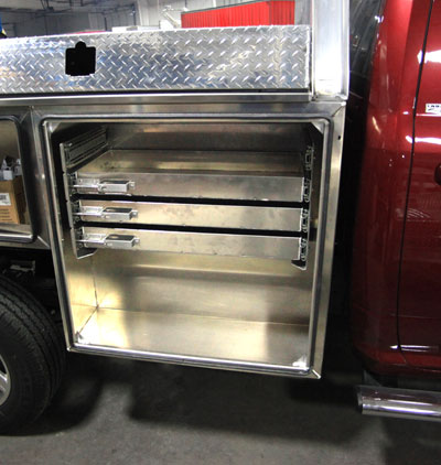

yeah , the bed will be a combo of 2" DOM and plate steel... the tool box company I'm looking to use are these guys...
http://www.800toolbox.com/
they build some badarse stuff...
http://www.800toolbox.com/truck_storage_drawers/truck_drawers
I know exactly what I want for the underbed, in front of the tire ones, they are pretty straight forward.. but I'm undecided on any additional storage up top, gotta design that stuff on the fly...

one lower side will be drawers, the other side will just be dividers... i kinda have an idea for what I want up top, but I have to see how, and where the tube lays out first...
kinda along the lines of this, but much shallower, with 1 less shelf and the length of the "bedside"....
Damn that's fancy. I wonder if they Make something like that. For an in bed design.
