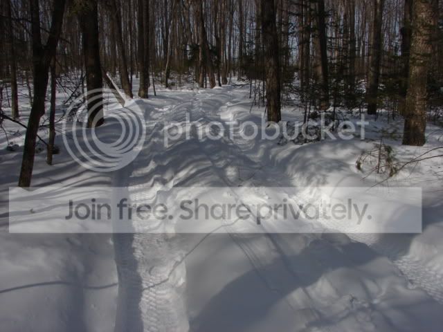

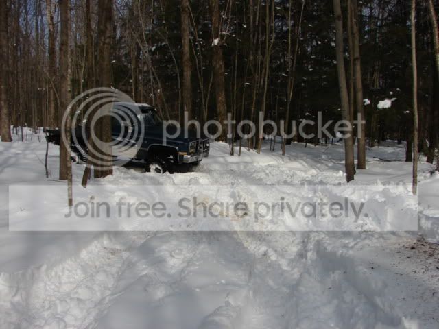

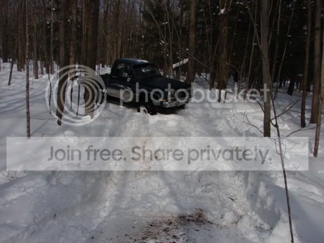

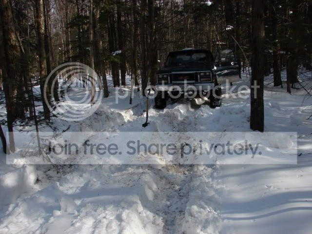

In conditions like those in the pictures below is it better to use 4 wheel high or 4 wheel low?
Stuck.
Unstuck thanks to my new shovel.
Turning around.
14 bolt FF drag marks.
