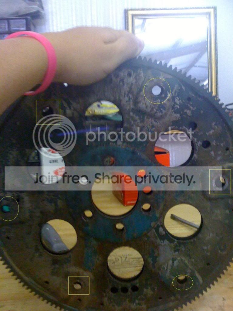

Old flexplate infront of new one
Yellow circles are the holes that line up, the yellow boxes are the holes where the it bolts up
The measurments are from Circle to circle and box to box
Alright yes that picture is correct for the old flex plate.
Ok, now i think i understand that the flexplate on the 454 has a 6 bolt pattern used with a convertor with 6 mounting locations and not a dual bolt pattern used with only 3 mounting locations.
