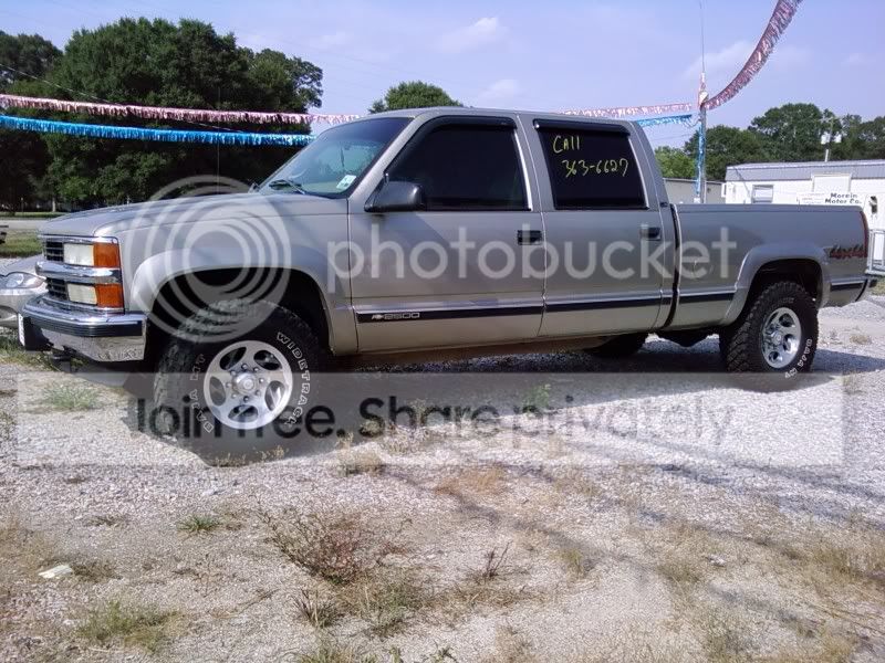

im looking at buying a truck, its a 99 with 454/4l80e/243/14ff and 3.73 gears the truck has 211k miles on it and the fluild is rust colored but didnt smell burnt when we checked it cold, forgot to check it when it was hot but gonna go back and look at the truck tomorrow. the truck shifts solid and feels good but the torque converter doesnt lock up. i also forgot to actually count the shifts out to make sure they where all there but the truck was turning IIRC 2400-2500ish around 65. also not sure how hot that vortec 454 is supposed to run, when i was drivign it i noticed it got pretty close to 210, didnt think to check it once we had come back to the lot but could feel a lot of heat coming off of the radiator when trying to lean over the engine bay, so much that it was uncomfortable to lean over it. i know my 350 runs realy cool but at the same time i have a friend with a 6.0 and IIRC it runs at 210 constantly.
thoughts?
pic of said truck
