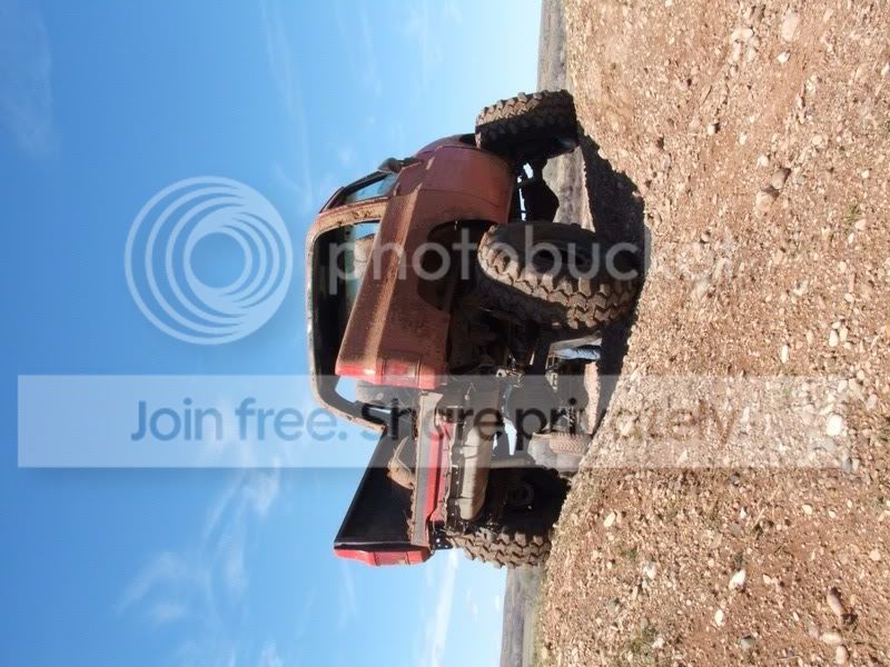

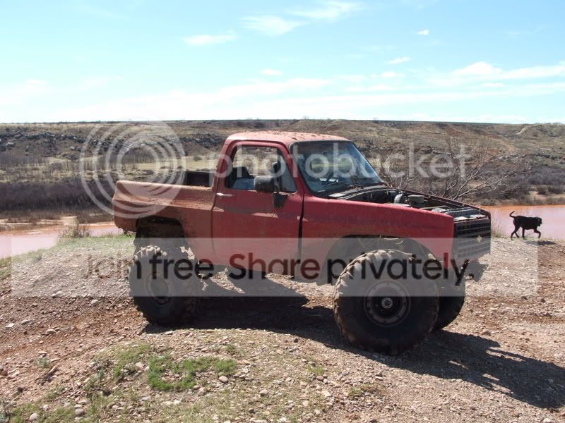

Mine has been working well so far. I may need to do some more trimming on the drivers side fender but this set up has seemed to work. I did go back and ad a couple of leaves to cut down some of the axle wrap until I can get a track bar made.
These were from this weekend.
It is not close to flexed out. Right now my shocks are way to short.
The ultimate adventure truck doesn't seem as cut as yours. I'm wanting to keep my inner fenders as there is a ton of mud here in florida. Maybe I'll add a zero rate to the front
