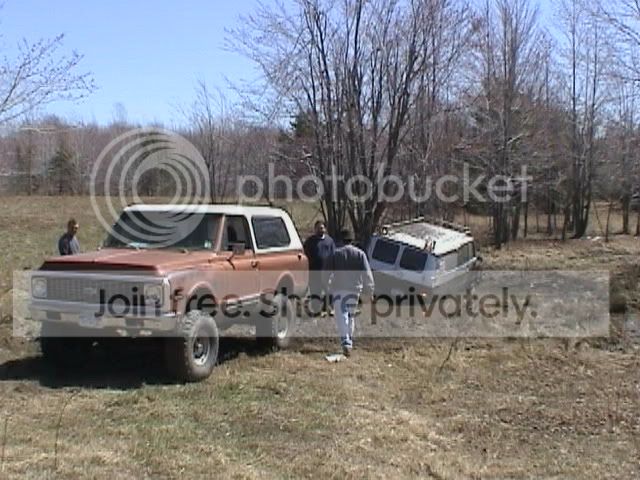

I have a serious hitch on it, so I just use that. Had to pull this beast out a few years ago. Man, old pic! Back when it mostly stock except the motor.
