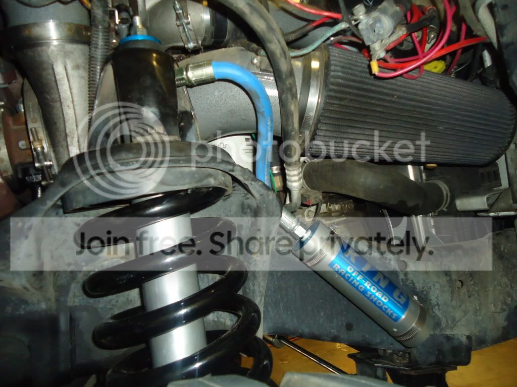

When you really start looking at stuff ORDs coilover kit becomes very attractive. The time you spend completely re engineering your suspension and testing it, if you mess up once it could easily cost well over what their kit costs.
I don't really know your abilitys or skills, I will probably never buy a bolt on coilover kit, I have built several link suspensions over the years and learned alot about what works and what doesn't and more importantly what I like and or don't like.
But links and coil overs are the ultimate for any truck out there IMHO total adjust ability of the ride height and spring rates. Excellent travel and rapid suspension response. And hey there is the cool factor too :D
If your looking towards a link and coil suspension like blazinzuk says you have a hard time finding coils for other vehicles. You usually end up with a compromise some place.
Getting the spring rates right and then packaging a 5" dia. coil and a seperate shock makes coilovers begin to look good. One easy to package shock and coil. Even a 2.5" shock has a 3.5" to 4.0" outside spring dia. Now in the space that you barely had room for the 5" spring you have both the spring and shock.

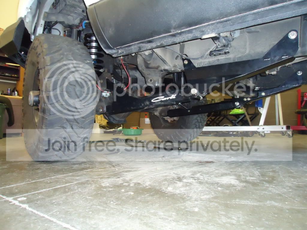

You will spend twice as much time installing a front than you think it should take. It will have areas that you will have less than an 1/8" of clearance and will be happy that you got it that big. There are plenty of others that will disagree with me and say doing links is not that hard, not that expensive etc but I have yet to see anyone get the project done and say it was cheaper and easier than they thought.
This made me laugh, I cannot count the number of times someone has done their own links and said to me, I did it for this much, told you I could do it on the cheap. Then by the next time I see them they have changed everything because nothing worked right the first time, spent way more money on everything they didn't spend money on the first time.
Links are certainly not out of the realm of the DIY crowd but you need to understand it takes tons of time, and more money than you expect.
