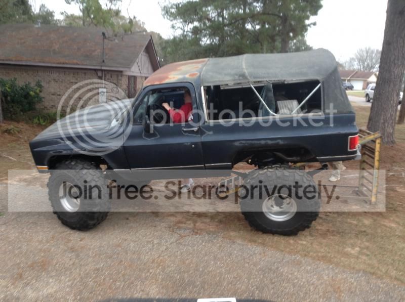

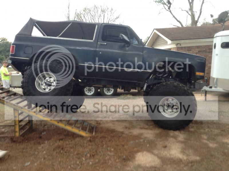

You should be able to get more droop out of that front axle. I agree with some of the others, when wheeling you will really find out how much droop you can produce. I've got some pics of mine that are suprising after looking at them. I am running stock 52's with a 6"shackle and a square front shaft with unlimited travel though.:laugh:
These are some old pics before some other upgrades, but you get the idea.
