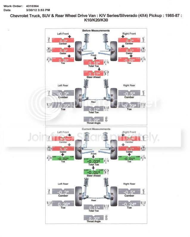

Take a look at this and tell me what you think. I did my alignment today at work and it drives good, but still has death wobble. Is it because of my camber/caster? When I first racked it up the toe was WAY out and I had to adjust it before I could even look at camber or caster.
The death wobble now isn't as bad as it was, and it's harder to get it to do it, but it will still do it during everyday driving. And now the front end doesn't wonder as bad, and if it wouldn't death wobble it would be a decent driver. I plan to cover the DW up with hydraulic assist, but I still want to know how it should be fixed.
I could be wrong but I think the castor is still low, do you know what the spec is? I was thinking is is around 8°.
Spec is between 7.5* and 8.5*. I can't change that unless I get even shorter shackles (I have 6" ones in now) or a degree shim, right?
Yeah, those are pretty much your only choices.
I'm not sure how much room you have to work with but could you put some stock shackles on it and test drive it? You know, just to see if it gets better.
I might be able to run the stock shackles if I move the rear shackle mount back to the stock location... Now that's it's moved forward I'm pretty sure the stock ones aren't going to happen.
I assume you have a steering stabilizer?
No, but when I do some work to my power steering reservoir I'll be running hydraulic assist. Right now I don't think The stock one will hold enough fluid for the ram, gearbox, and hydroboost
