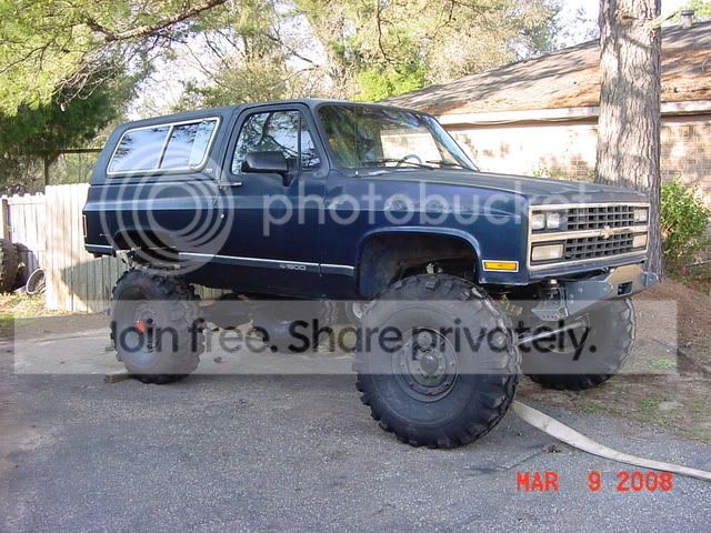

I've got 2.5" 52's on mine with the overload removed, I swear it's closer to 8" than 6". I expected 6"ish but it seems way tall.
That thing looks really badass though
