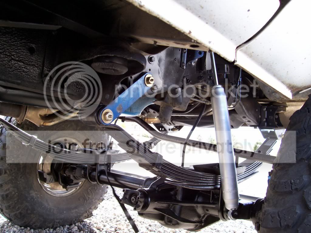

Heres b-52's with old 2" Lift 52's overload removed. Front eye under body mount and a 6" shackle. Axel is almost in the stock location. I've since moved it to teh forward hole.
picture.php
picture.php
picture.php
And this is pretty much how it looks.
attachment.php

I'm running 8" lift 52's up front and i drilled a new hole in the frame to relocate the shackle, also i'm running the b52's in the forward most position, and the springs in the third hole to the front. This is what my shackle looks like. I plan on moving it back to the original hole and filling the one i cut. I didnt read the whole thread but i thought i would give you a pic for reference. hope it helps. oh ya the shackles are 7.25 eye-eye

I had Kert make the Abomb with the B52 part in its forward position. I painted it the other day and cleaned up my springs. This weekend I'm going to move the rear hanger forward up the frame and see where things end up. Should have everything done sometime this weekend and I'll post up in my build thread.
Check out the Abomb pics in my build thead. Kert said a couple others have ordered abombs after I posted up the pics but Im not sure who or if they have them yet.
